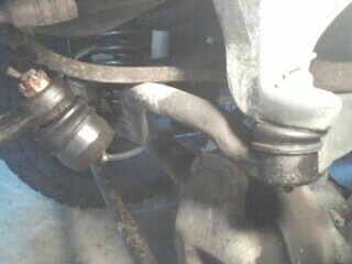

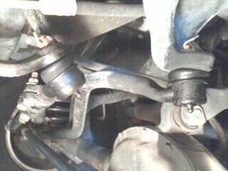

Ok so I now know I'm gonna have to reposition the rear track bar to center the back axle but I was looking at the front end again today, after talking to a local jeep guru lol here's a couple pics of the pitman arm and the track bar bushings. The angles not horrible but it damn sure aint straight like it was before the lift or like mine are on my XJ. Could these bad angles possibly be enough to cause binding and her wobble?

Post a pic straight on front so I can see the configuration, please....
The previous owner of my axles had awful DW and more... Looked like an escalator....
