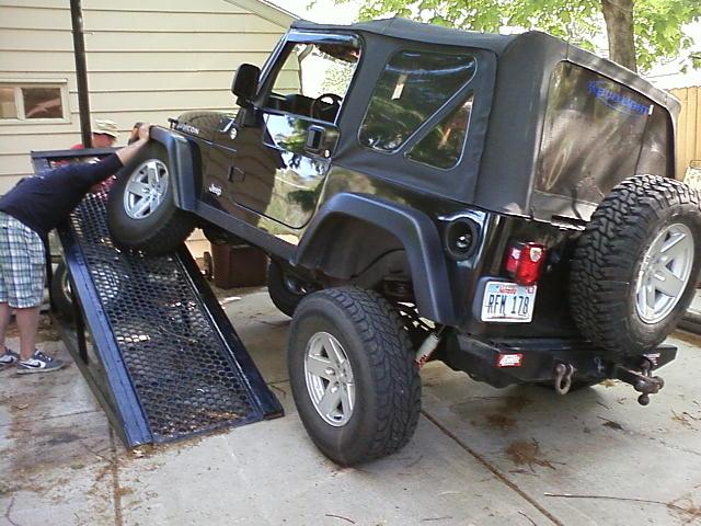

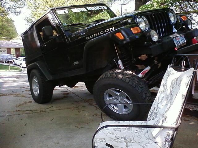

Hi my name is cameron im from lincoln nebraksa i drivw a black 2006 wrangler rubicon with a 4 inch rough country x series lift, im 18 and work full time at speedway motors to pay for it.

I'd buy longer bumpstops before shocks, otherwise you're greatly shortening the life of the springs by repeated over compression.
right now i dont have bump stops, when i put the new springs in my bump stops were massed against the springs so i took them out until i buy new ones
I would avoid the amount of spring compression shown in your pics until you get the proper length bumpstops, otherwise your springs will sag prematurely. Suspension droop is much better than compression when it comes to flex and spring-life.
