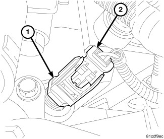

1.Remove air cleaner assembly .2.Partially drain the cooling system.3.Disconnect the electrical connector (2) from the engine coolant sensor (1).4.Remove the sensor from the intake manifold.
