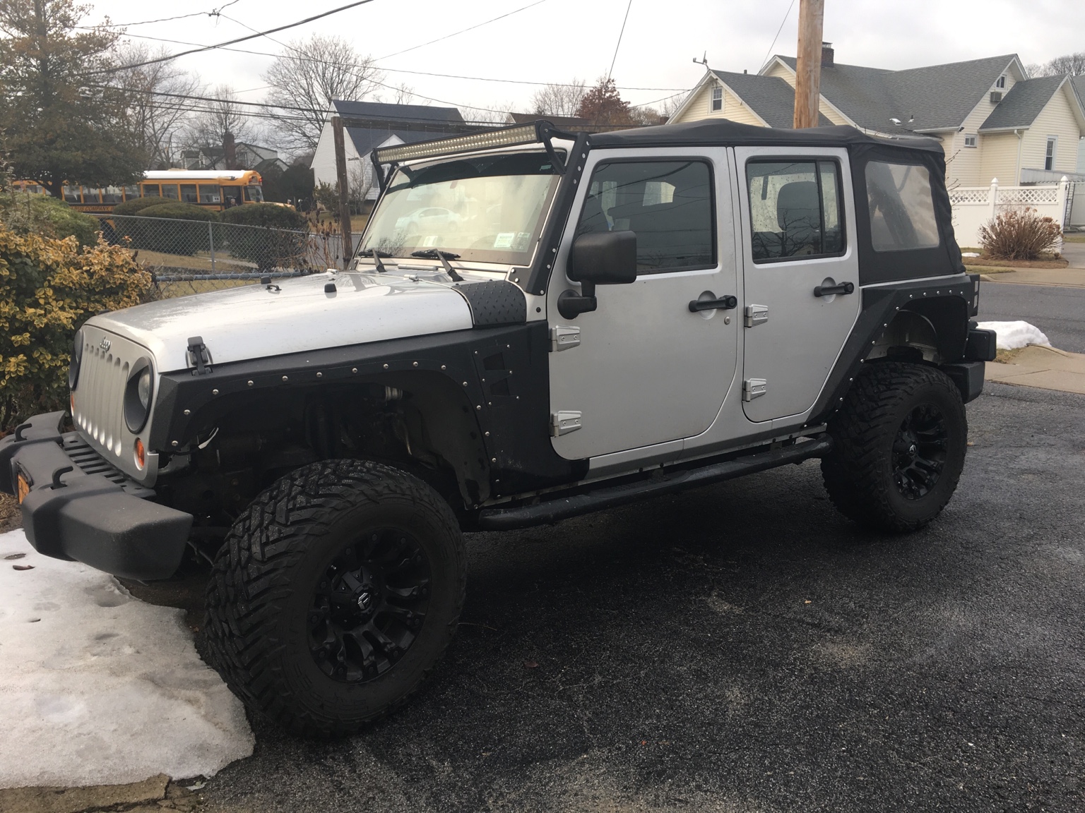

Anything larger then what you have you’ll want tires & rims. I know it sucks I had the same issue otherwise you will need wheel spacers and if not properly installed can fail horribly leaving you with a bigger issue. I run 35x12.5R17 it’s the step up from the p255 I also run with a 2.5” lift so you can get away with 37’s but anything over 35” if you have an automatic you’ll also need to regear because you’ll lose a lot of power
Also anything more then a 2.5” lift you’ll need to change the angle of the driveshaft and get longer break lines and such the 2.5” was made to keep all the same oem parts intact didn’t know if you were aware of that
