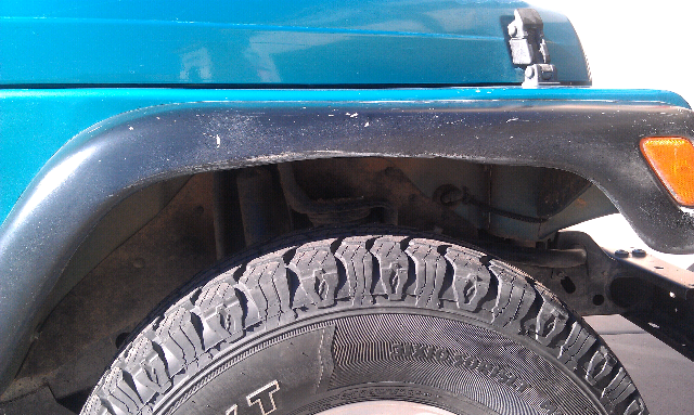

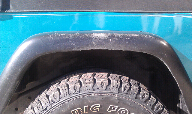

I was wondering if my jeep would look good with 31x10.5r15 tires and a 2.5 inch lift kit will there be to much lift and not enough tire? I can't find any pictures on Google or anything like that
I'm running 31's right now with a stock suspension and I have about 4 inchs of Clarence in back and about 3 inches in the front so your gonna have about 6.5 in back and 5.5 in front
I just did some measurements and up front from the center of my hub to the bottom of the black plastic trim is 19.5 and the rear is 20.5. Is that stock or does it already have a lift? I never asked the previous owner bout any lifts
Front
Rear
