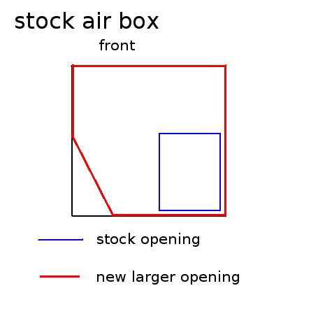

i made kind of a larger intake by using the stock components....i cut the stock airboxes intake a little larger and took out the tubing in the airbox...its louder, but i can feel the torque at 2 grand, heres a picture

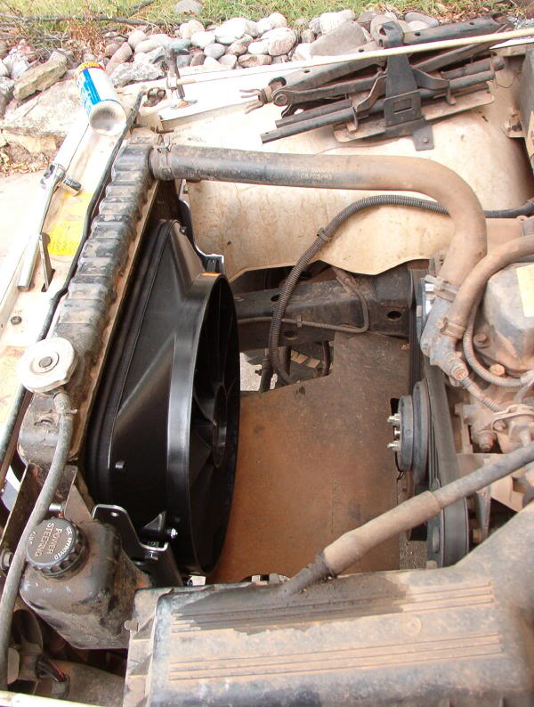

Wait till you put in the electric fan....that opens up enough room on the front of the engine compartment to actually stand between the engine and the radiator!!

i need to do that electric fan, a guy in my club has it and its nice. i can stand there anyway, but not having to stradle the fan would be great.
