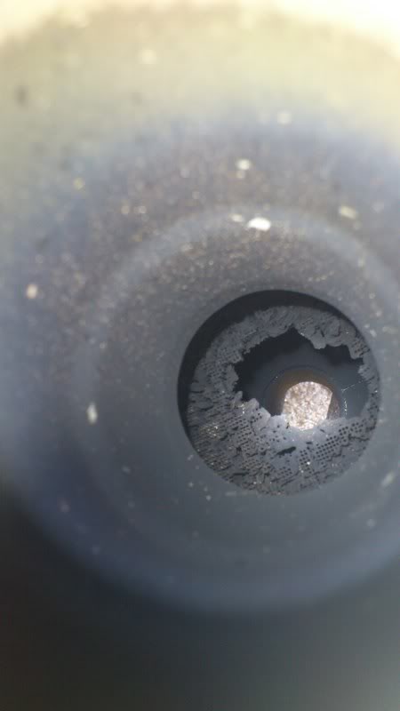

If the cat converter was clogged wouldn't it fail DEQ? Its been doing it before i went to DEQ and it passed The plugs, wires, cap, rotor, and air filter are all new. Plugs are gapped right. If it was a vacuum leak you would think it would big at acceleration.
