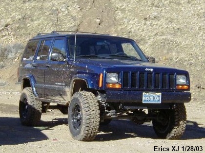

These pix are from another site. The guy removed the flares, airdam (under bumper) and trimmed the bumper endcaps. I'm mainly posting this to show the difference the trimmed endcaps make:
Looks pretty good for all that trimming!
I tookk the rig out this weekend! The lift was enough for mild fun! The wells need to trimmed! Overall the ride was awesome! It is hard to say which jeep I like better (yj or xj)! Twisted thanks for the pics!
