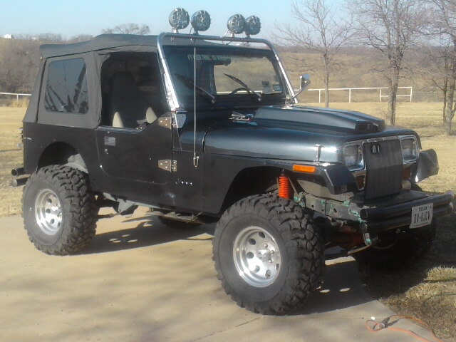

I have a 94 wrangler with a High Energy 4x4 Comp cam for the 258 4.2l engine, and i was wondering if anyone knows where I can get Valve springs that will fit the smaller seats on the 4.0L head? right now i am using my stock springs, but an worried about them breaking or possibly floating a lifter. Was also wondering if anyone has tried the SS SYE kits and what kind of feed back you might have. I have a NV4500 with the NP231 behind it and a standard SYE Kit, and a chrysler 8.25" in rear with 4.56 and detroits front and rear. Thanks for the help!!
Josh
