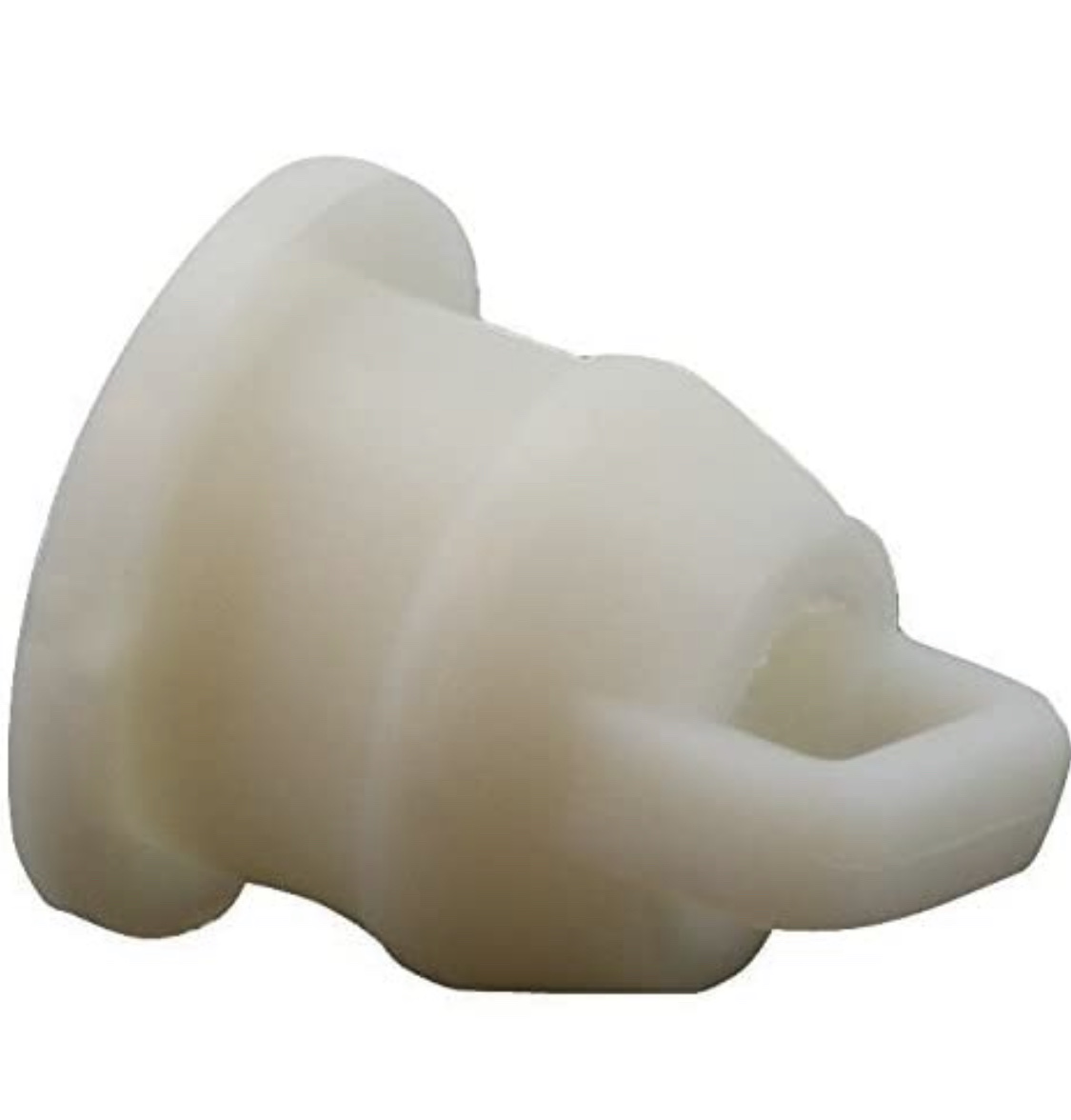

About a year ago my bushing broke after 100k miles so I went to buy a new one at the Jeep dealership so I can get a mopar part but ever since I got this one whenever I shift down to 4 low or even neutral when I try to shift it back to 2WD it pops out of place and I have to go push it back in to continue driving does anyone know a better bushing I can use cause this makes it very hard and annoying to off road

The bushing is also fully snapped onto the pin on the actual shifter but the rubber arm is what is popping off. The bushing never fully pops off the cable arm is what comes off

I am having this same issue with my 2009 Wrangler Rubicon. I replaced the bushing and it is set in the ring but I cannot snap it to set fully on the pin. I’ve tried my fingers and pliers at this point. Any other suggestions? Could it be the wrong bushing?
Clean your ball. Use a bit of lube. Should slide in.
