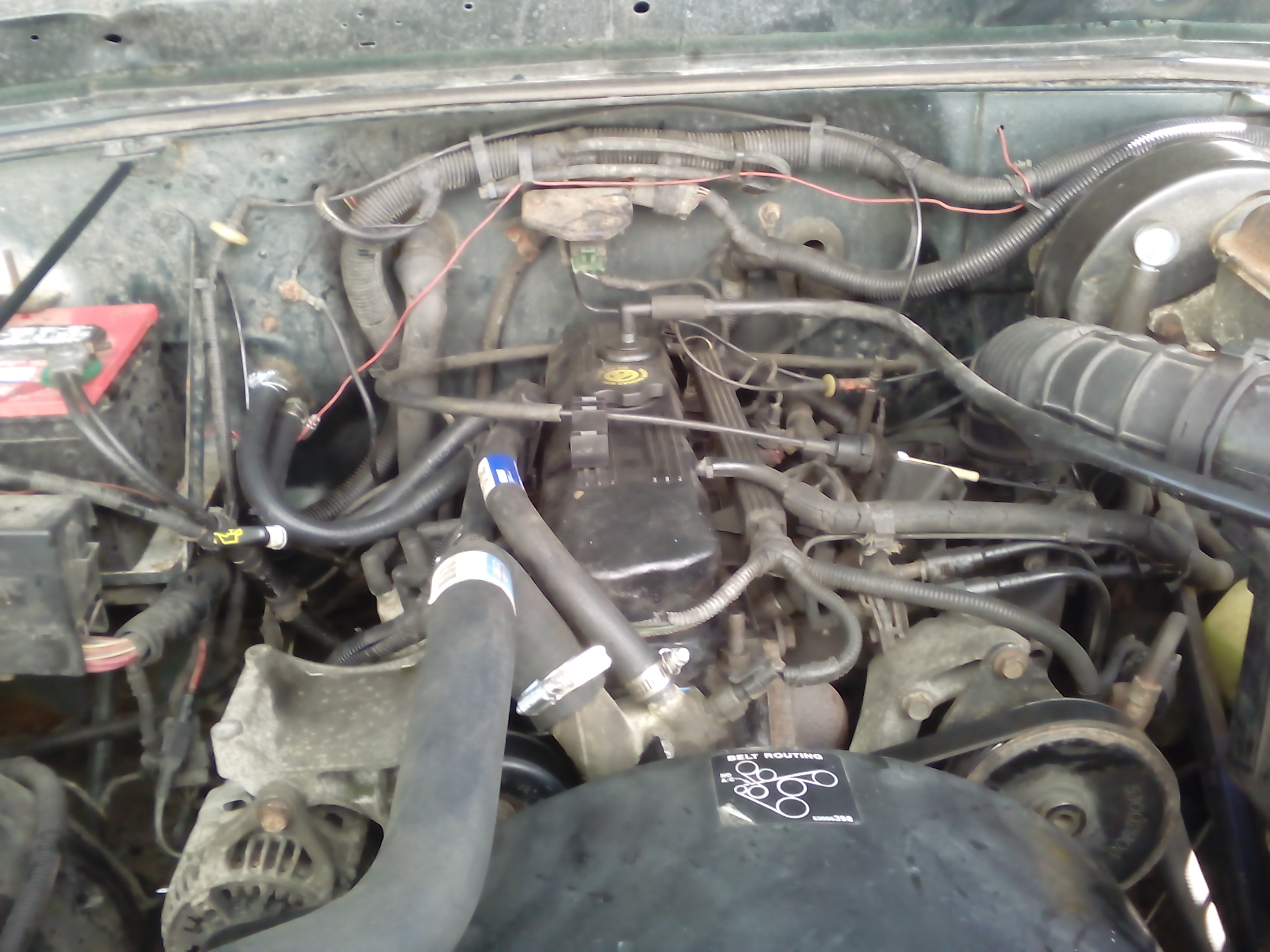

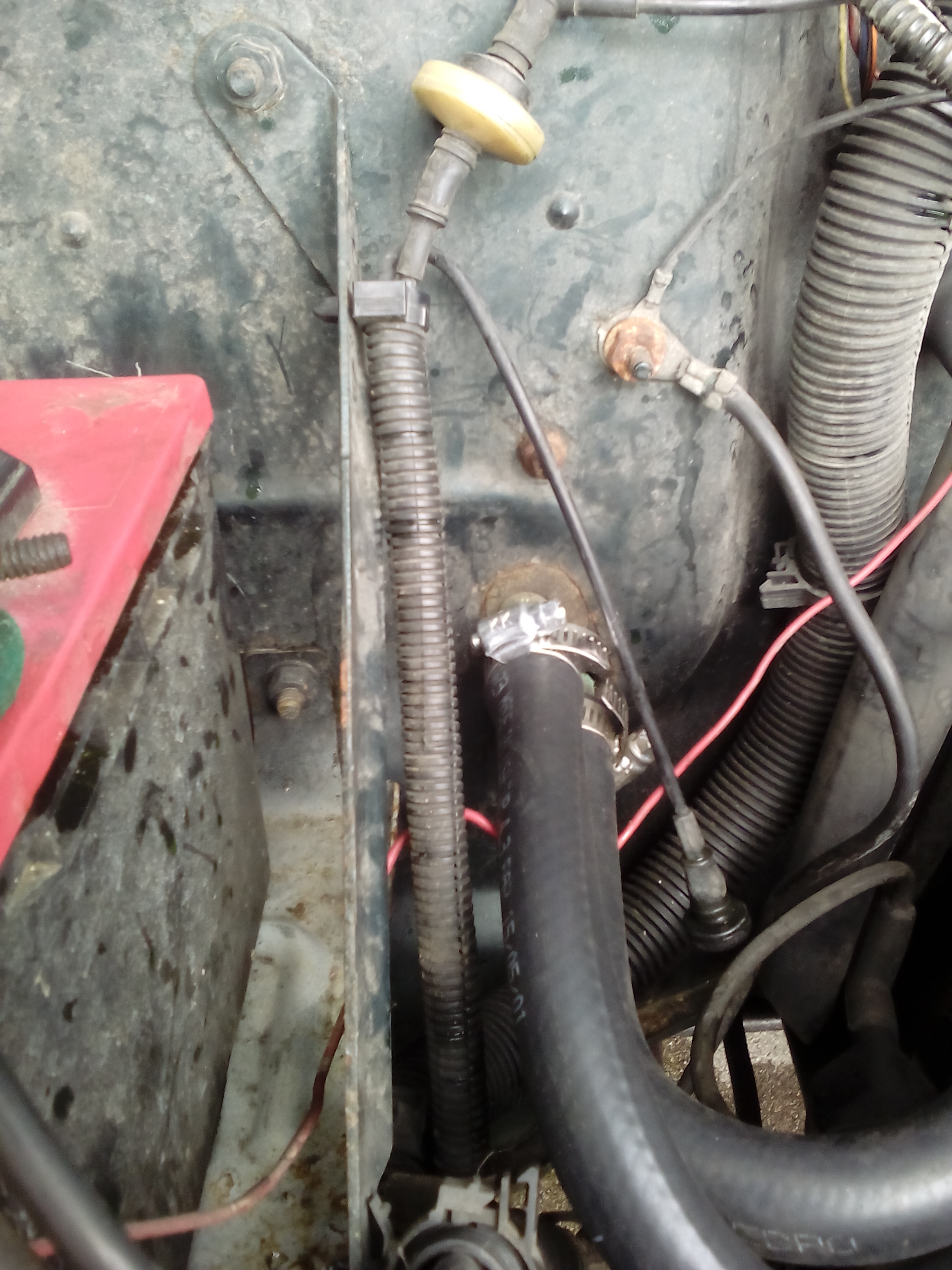

Newbe question, for my 4wd I can only see 2 vacuum hoses & 2 wires going to what looks like a large diaphragm. 1 goes to the engine the 2nd just hangs next too the battery (looks like a black check valve attached to the end of hose). Does this hose connect to anything else or just a vent?

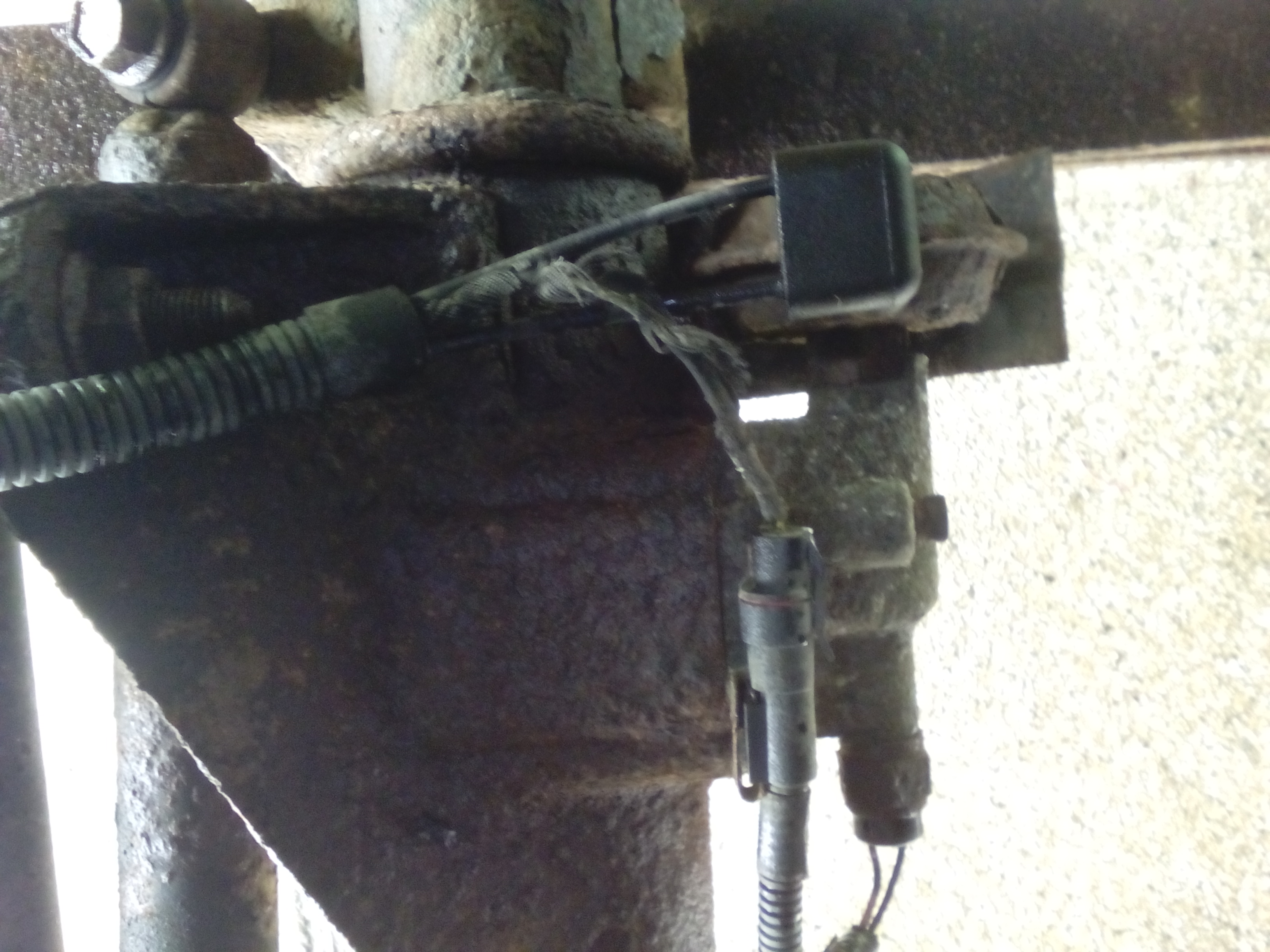

Oops you did say for 4wd. One thick hose from the pumpkin goes up align the firewall and stops into a plastic valve.. It is a breather vent. The other is a vac line I'll post a pic soon
more

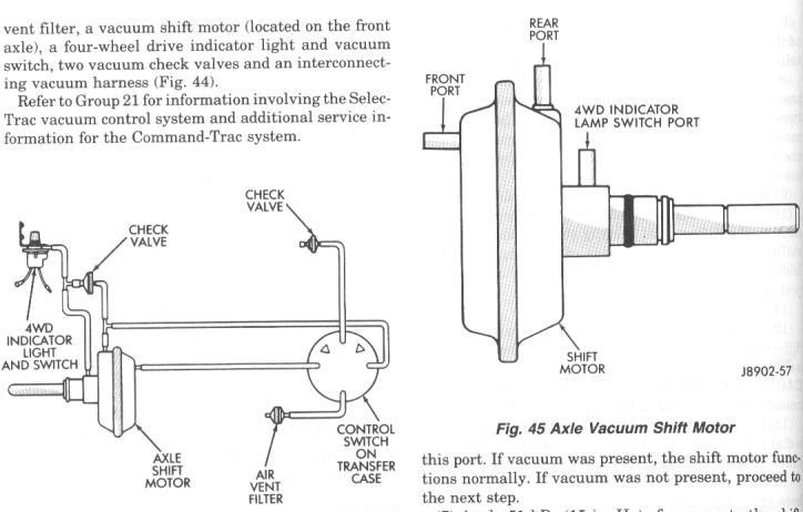

Sounds like your system is original. The 4wd light switch is on your axle disconnect system, that's the electrical wires. Two black vacuum lines to the front axle shifts the 4wd disconnect. The vacuum tube beneath the battery is just a vent. The 4th line should be red and is source vacuum from the intake manifold to the transfer case switch.
