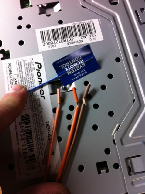

Any idea what those wires are for?

the blue remote wire is for a cd changer.
the other ones, no idea. do you have the diagram showing the colors and what they do? it should be in the instructions for hte head unit. i would imagine the orange are speaker outs for a rear speaker left or something like that.

On the wires above what does the manual say they are for? Could be for ign power so it's on only with the key or steering wheel controls, amp on so amp is only on with the stereo??

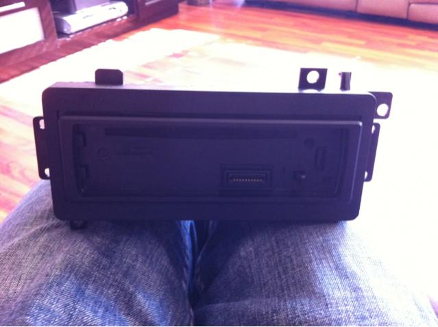

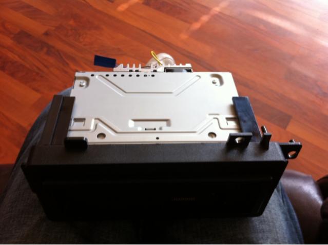

How do I secure the stereo to the frame? Cause if I install right now I can simply pull the stereo right out.

Sort of. There should be a metal "cage" around the head unit, near the front. Slide the hu out of the cage, (the cage slides toward the back of the hu) and mount the cage (the tabs are on the cage). Slide the hu back into the cage.
Your missing the cage that the radio slides into. Its a little metal cage with crazy cut out designs all around it. The stereo will slide perfectly into it and you'll have to have some little flat 5 handles to unlock the stereo from the cage after you put it into the cage. The cage slides into where your radio is sitting in that plasitc adapter and then you bend the crazy cut outs outward with a screwdriver or something. Once you have bent enough outward to secure the cage to the plastic well, you slide the headunit in place
Your cage is still on the head unit. its the sleeve that is around the front. yours doesn't have the crazy cut out designs
The sleeve should fit pretty tight into the plastic opening/adapter.
The sleeve will slide in from the front of the opening (like pushing it into the dash). There is a lip on the front of the sleeve that will catch and keep the sleeve from sliding all the way through the adapter.
At this point look at the back of the plastic adapter you have, there will be some triangular shaped tabs in the sleeve on the back side of the adapter.You will need to bend these triangular tabs out to keep the sleeve from sliding back out of the plastic adapter you have. If you cannot get to them from the backside of the plastic adapter, push them from the inside of the sleeve to the outside.
After the sleeve is mounted to your plastic adapter, insert the back of the radio into the front of the sleeve. Push in till it clicks.
