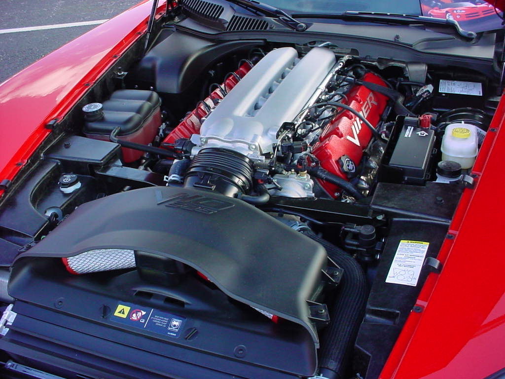

I think this one will be the best for the YJ. Whatch'a think?:D
Your gonn'a have to stretch that engine compartment to get that beast in there.. You also probbably want to pull it off a SRT 10 Ram instead of the Viper.

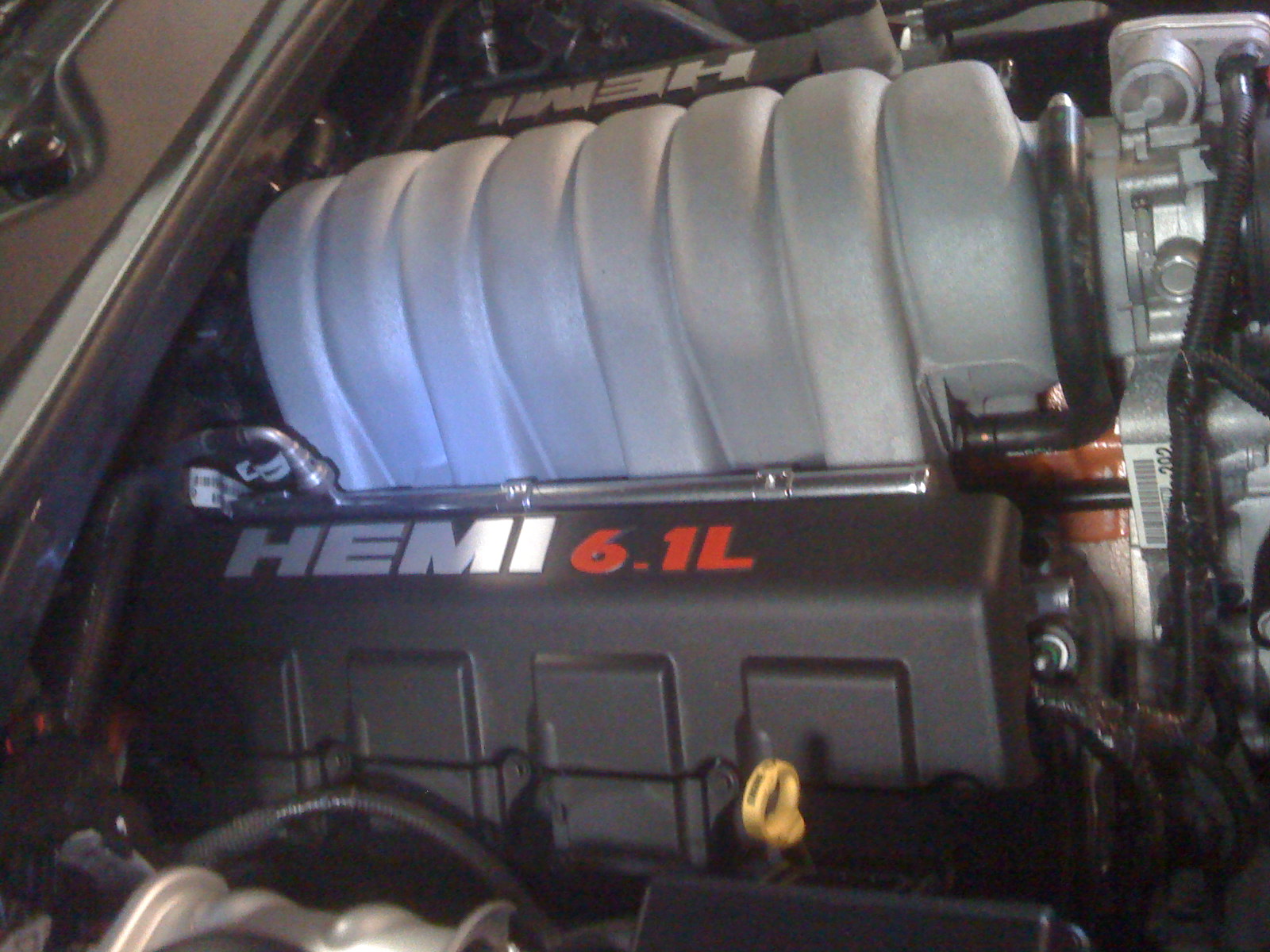

For more power and less cost than either the 6.1 or the Viper motors you could stuff this one under your hood
PLUS It uses a Carburetor so there is NO stupid ECM crap to deal with.
