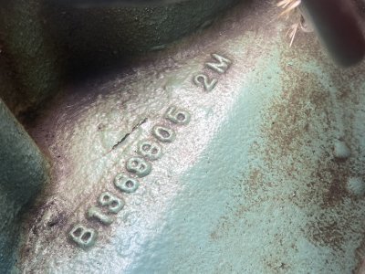

66’ church engine stamp help
wsm
Please see the below photo and look forward to any help with identifying my engine model. Stamp was located back center behind The carburetor. Thx
I used the internet way-back machine to find an old Geocities website that seems to have information about older Jeep engines
https://web.archive.org/web/2009042...ties.com/cantwait_forviolence/cj_numbers.html
I'll paste the info here as well for those that follow:

Thanks so much everyone… I believe it is the ohv v6 motor.
