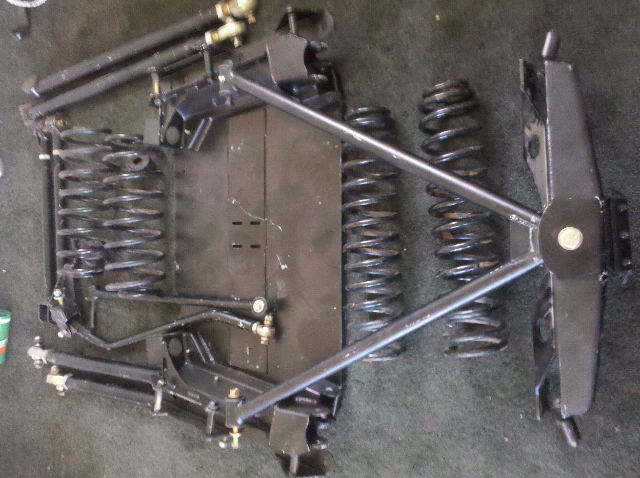

This is the kit as it lies on my floor. The misc little parts are in a bucket out of the pic.

32s? On a 6" lift?? You could EASILY fit 35s, possibly bigger - I wouldn't be surprised if you couldn't throw a 1" body lift on and run 37s - and you might not even have to do the body lift. Hell, run tube fenders, trim the rear and you might be able to fit 40s. Of course...your axles might not be up to it. But the point is a 6" lift on 32s will look weird. But it's your Jeep, you can do what you wish. Just handin' out some advice.
Also, my concern with buying a 'used' lift kit like that would be that you might be missing some miscellaneous hardware or bits that you won't find out about until you start installing stuff. If you're not planning on going above 32-33" tires I personally think you would have been better off getting a 4" X-Flex lift from Rough Country for about $1100 IIRC for a long arm and using the extra money for some tube fenders or rocker guards or something else, but that's just me. Good luck with the lift, be sure to post pics after it's done.
