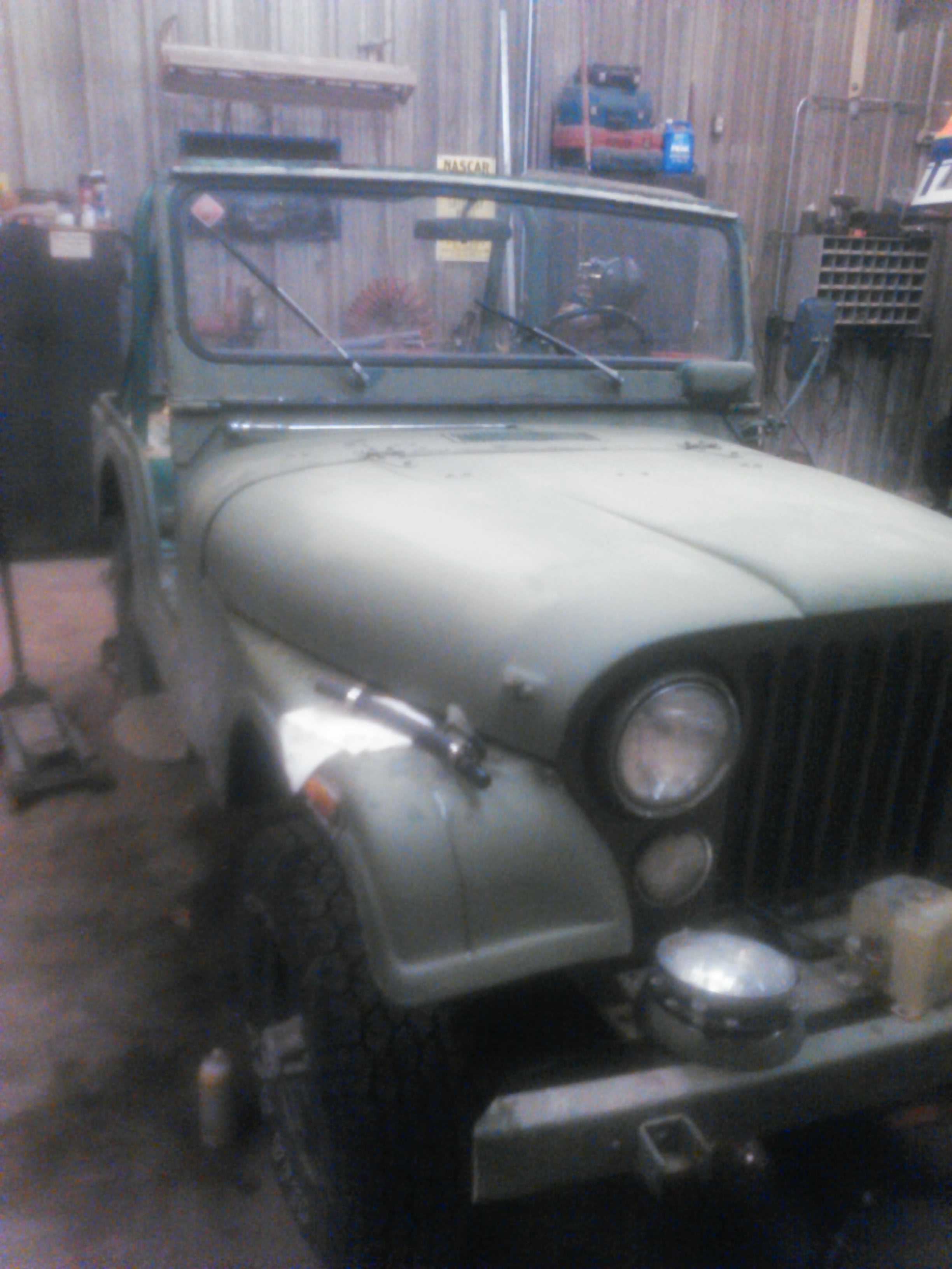

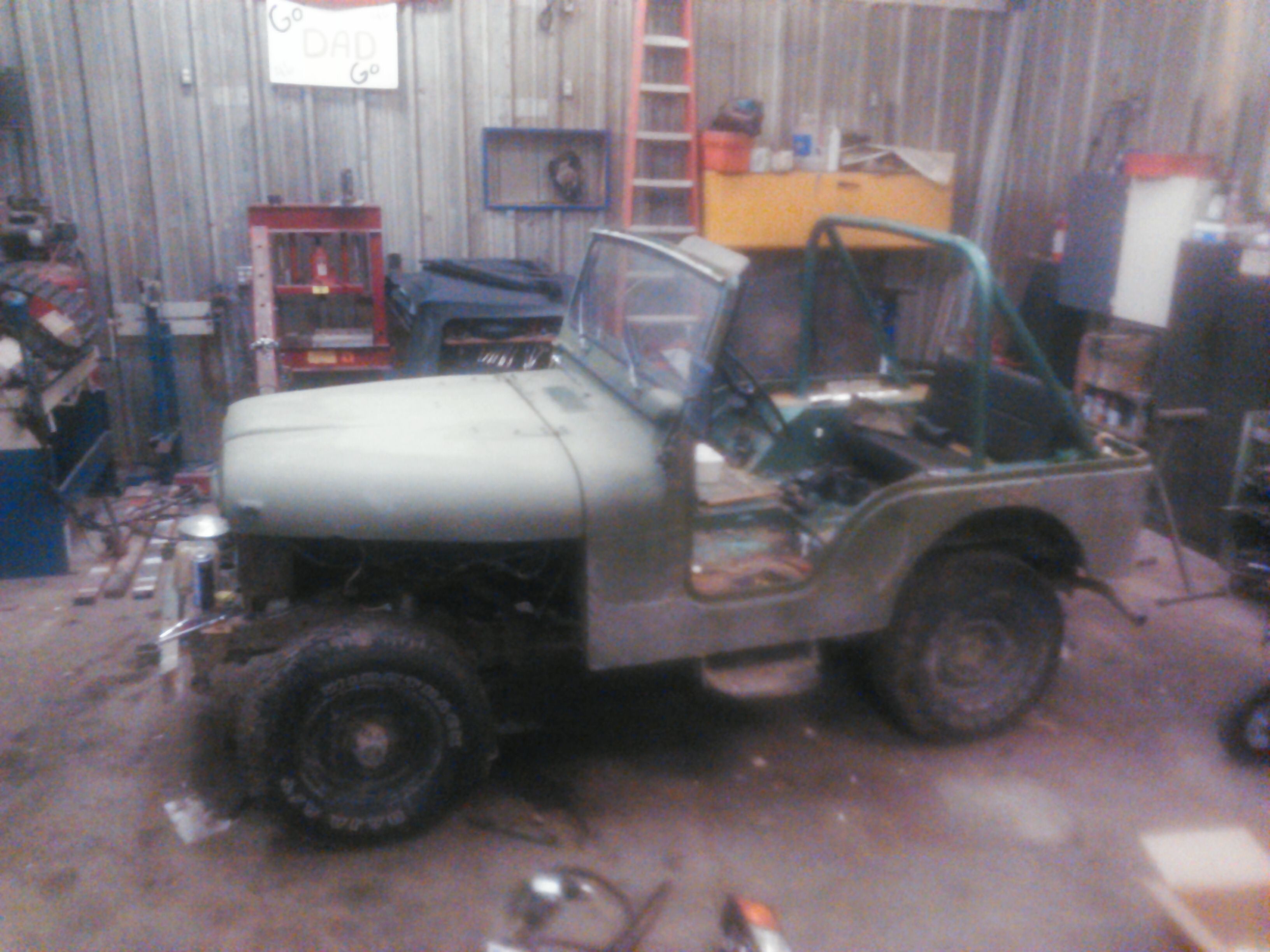

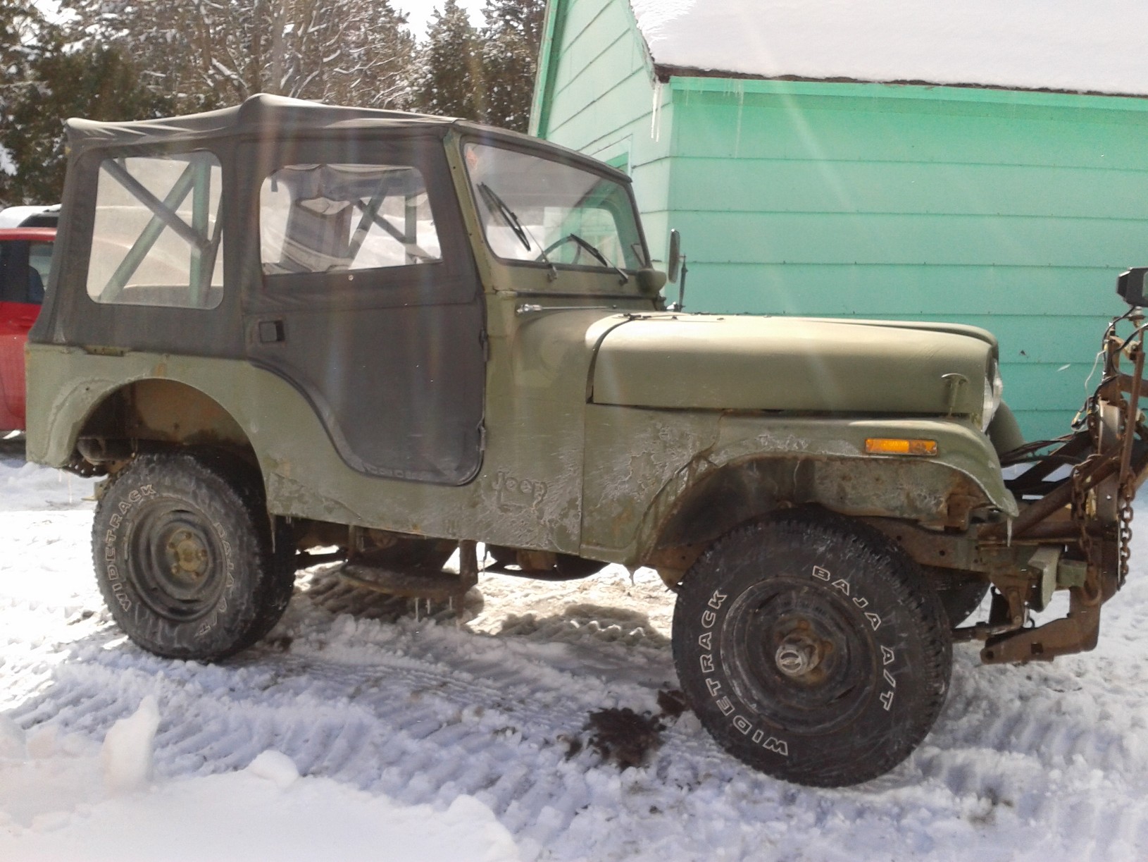

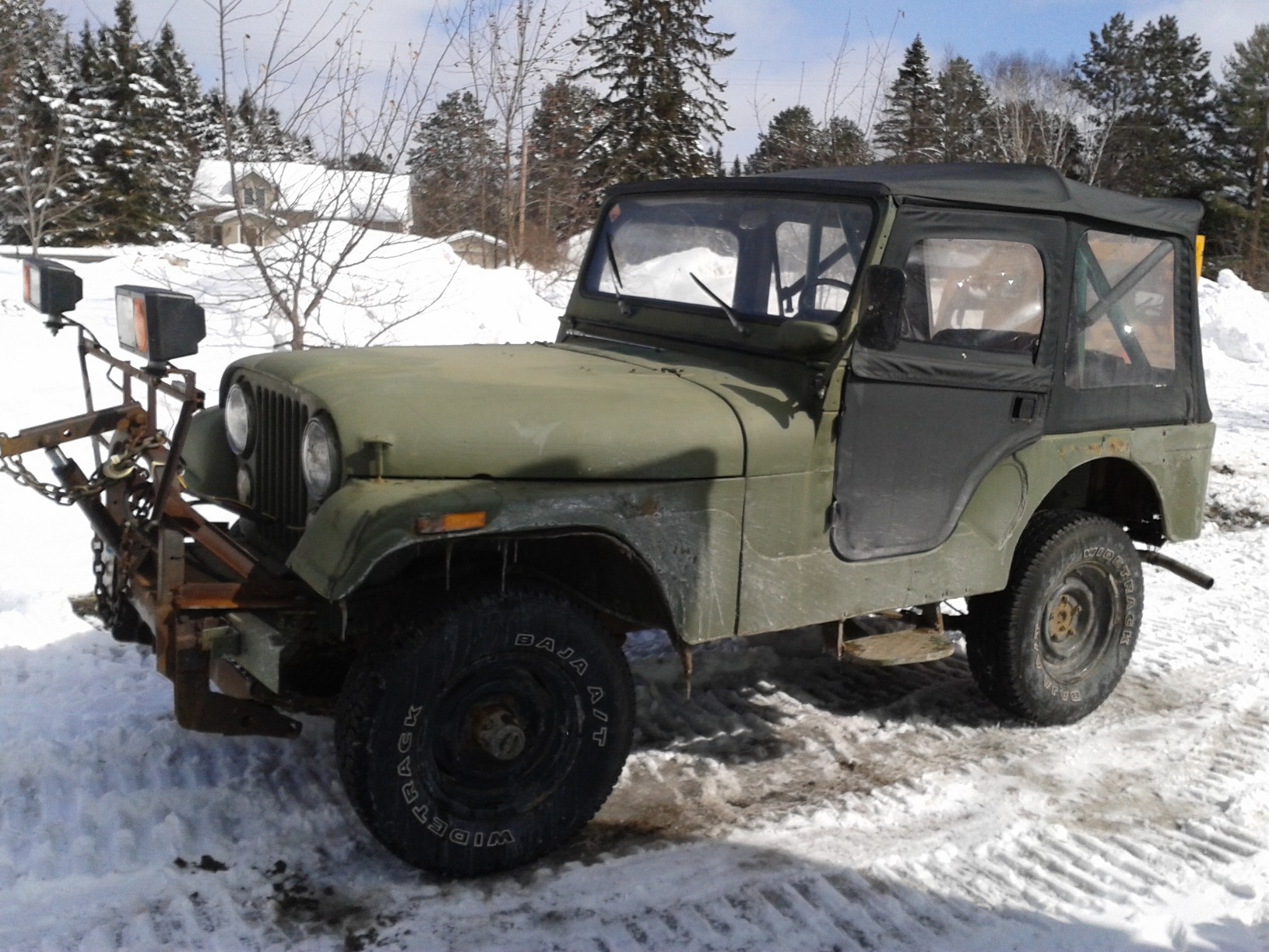

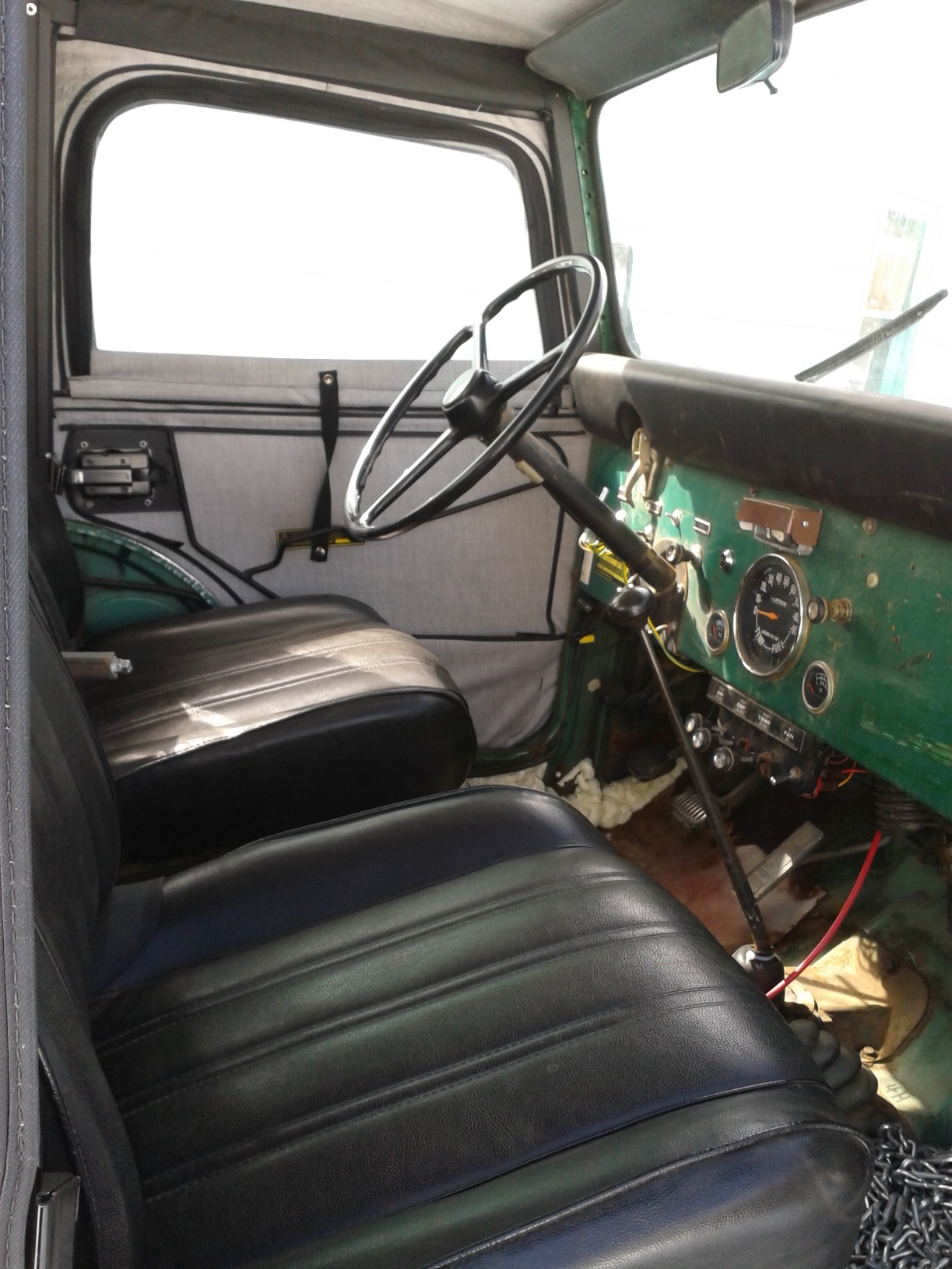

Well it's been 16 long and painful years since I last owned a Jeep. Finally got one a month or so ago. I've been working on it since and thought I would share it will you all. Here is what she looked like the day I picked it up. She came with lots of newer parts already installed. Aluminum radiator, 2.5 rough country springs, Best top, and rear seat. The Frame is solid but the body it's self was in really rough shape.

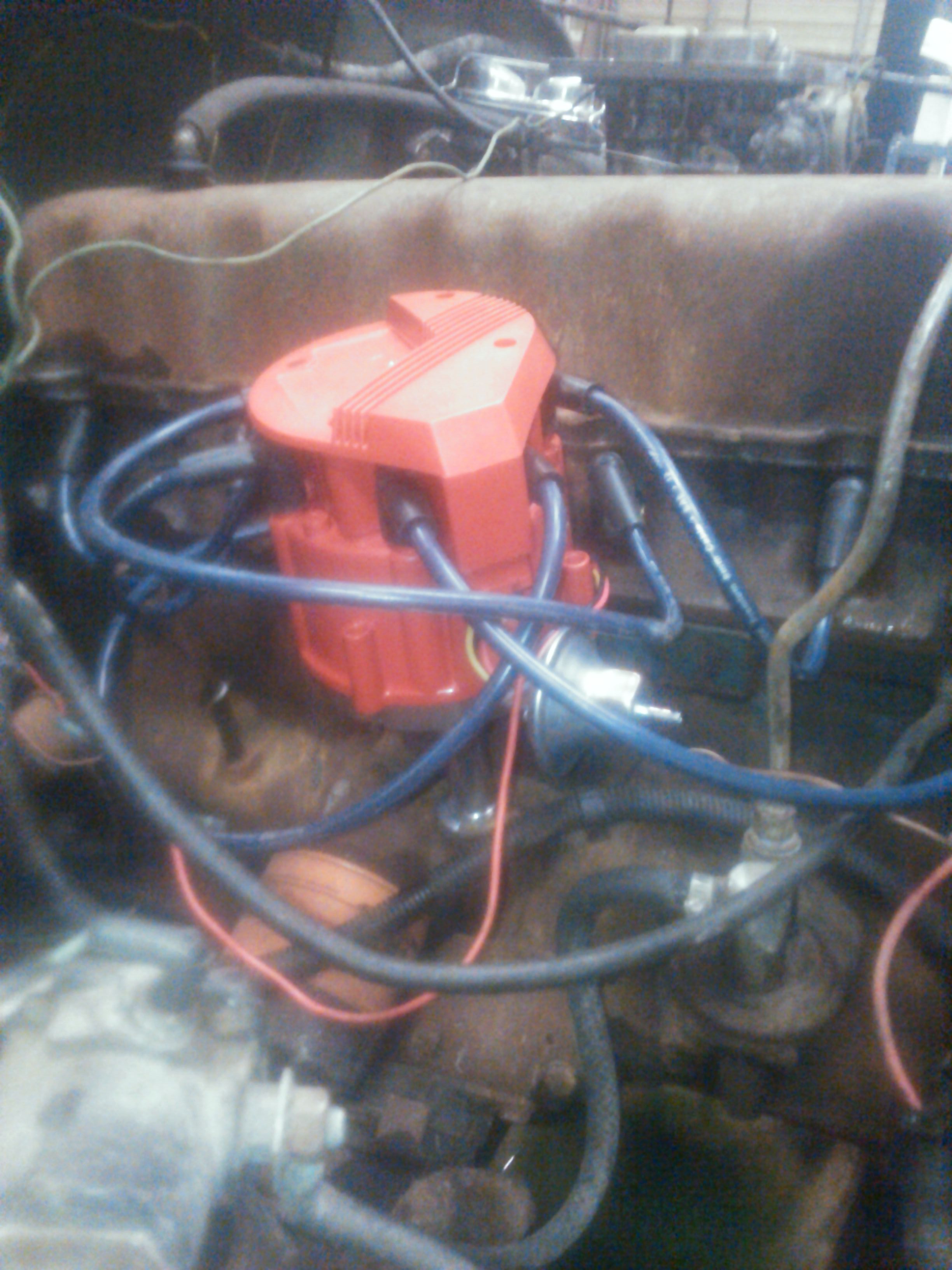

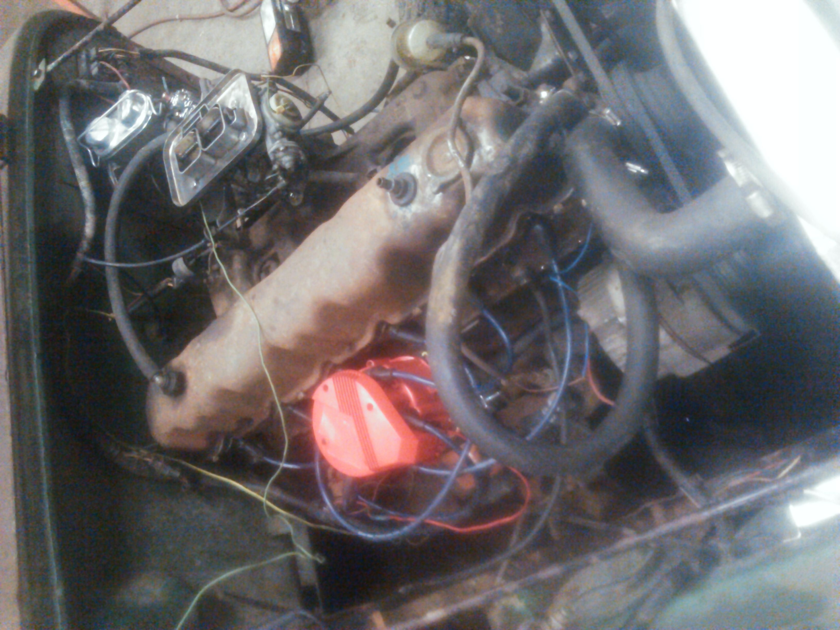

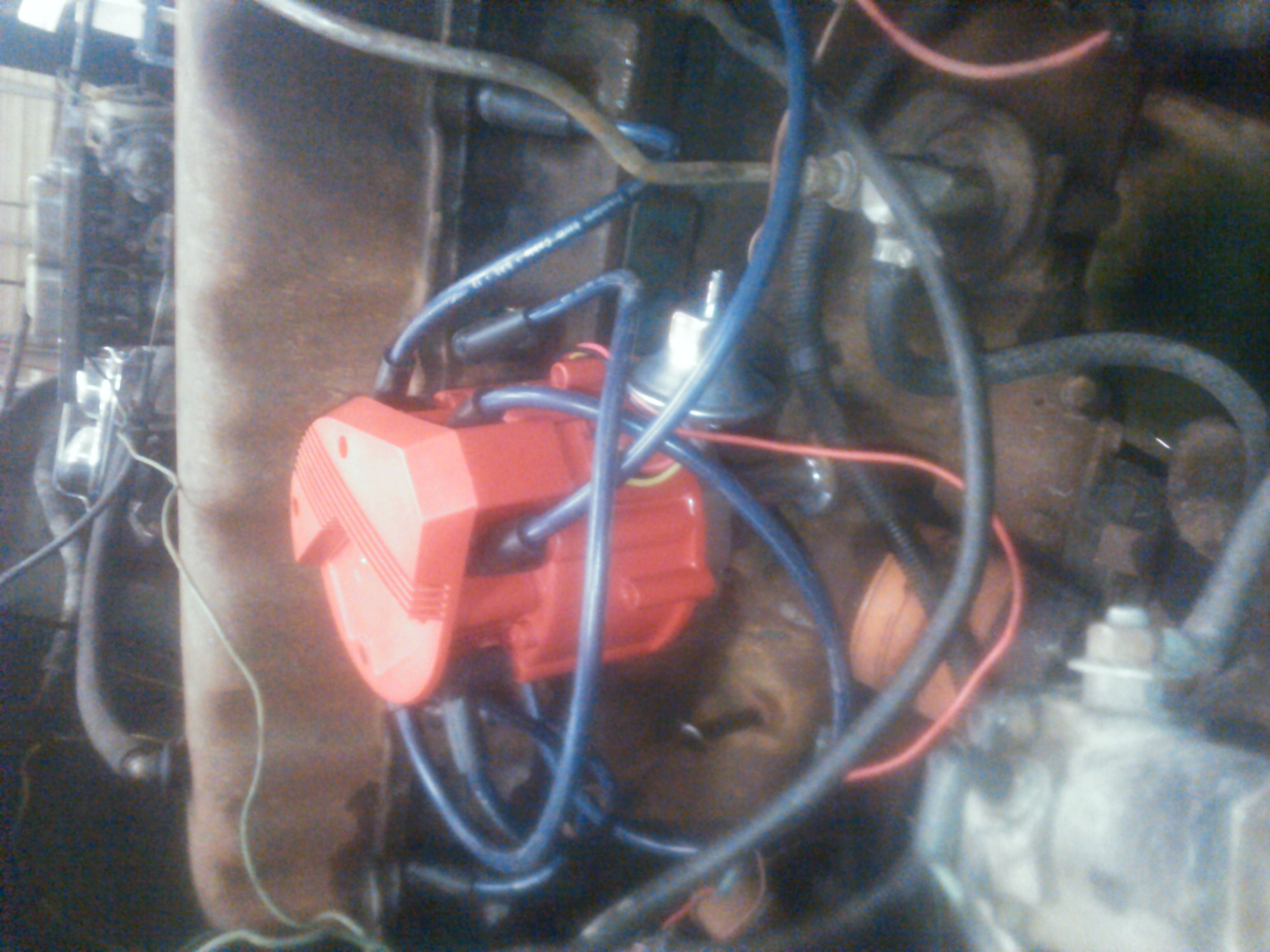

It's got the 258 I6, 3 speed manual. It had a horibble miss just off of idle so i swapped out the factory distributer, and upgraded to a GM HEI.
She runs like a top now!

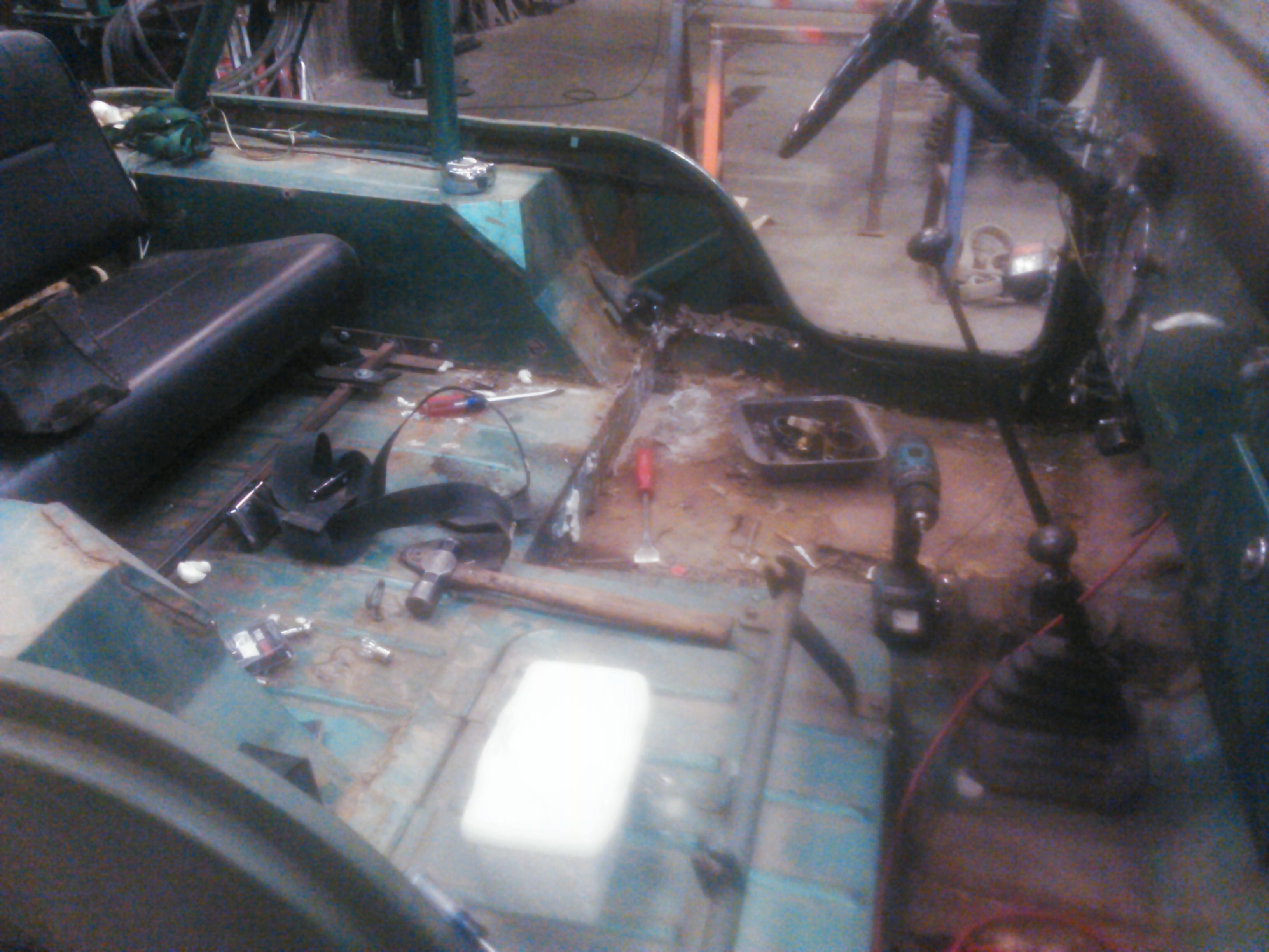

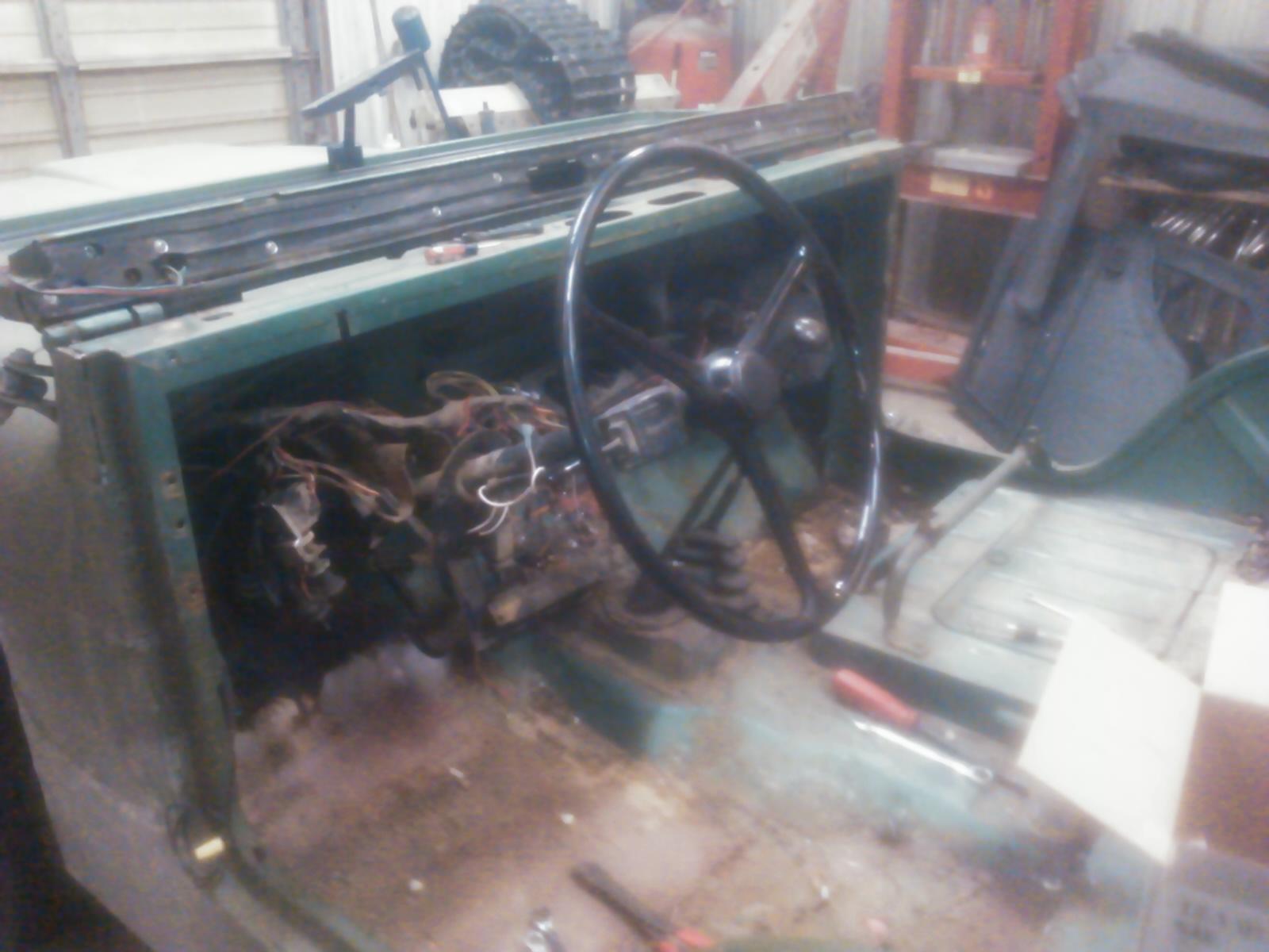

After I got it running right again, I started taring into the body and realized in a hurry she needed a major overhaul...

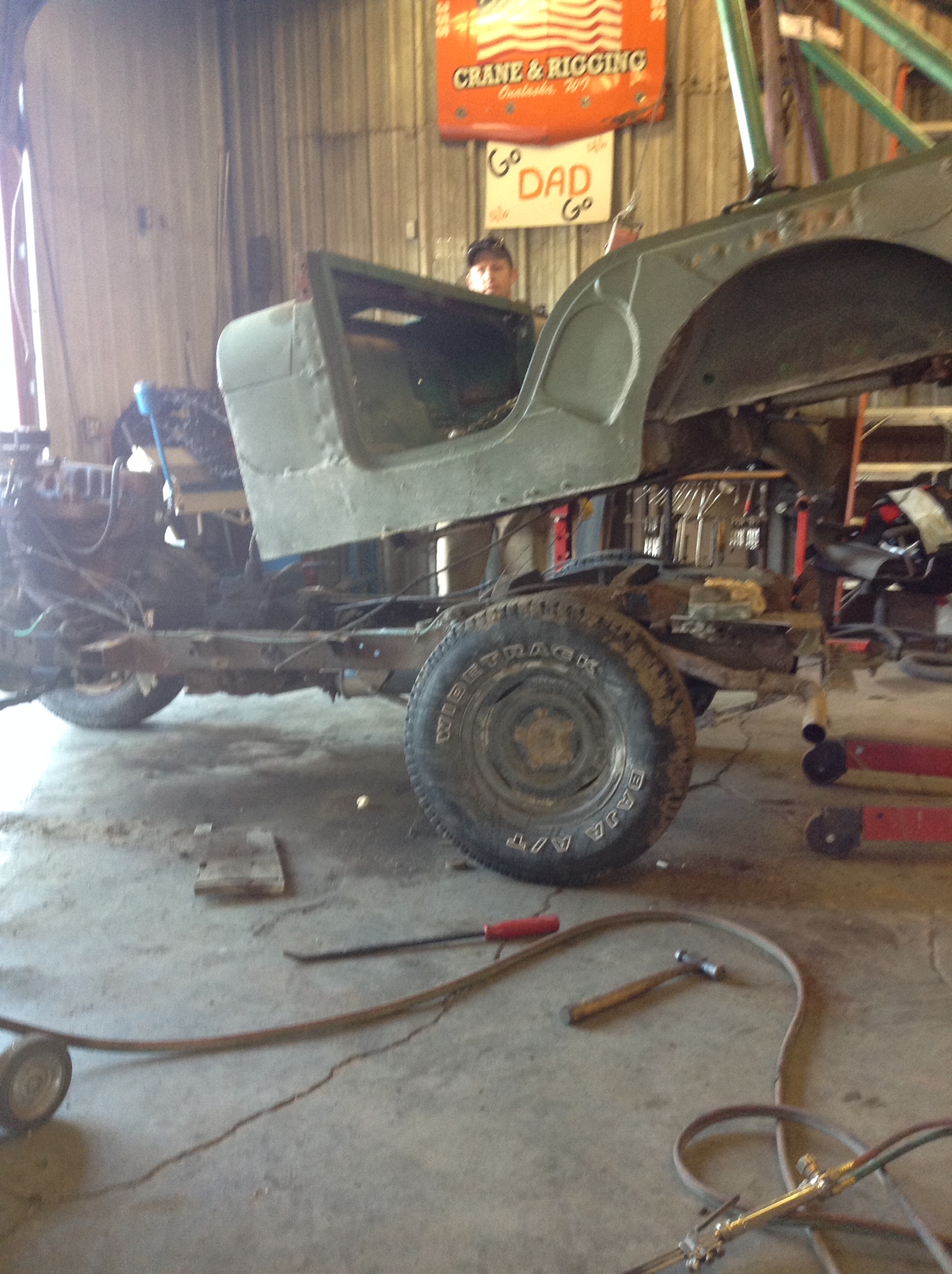

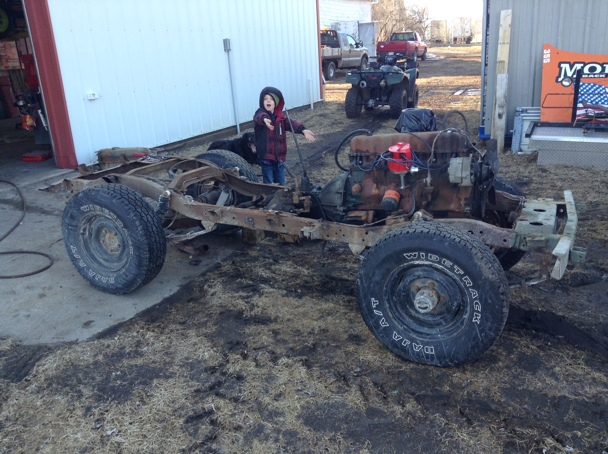

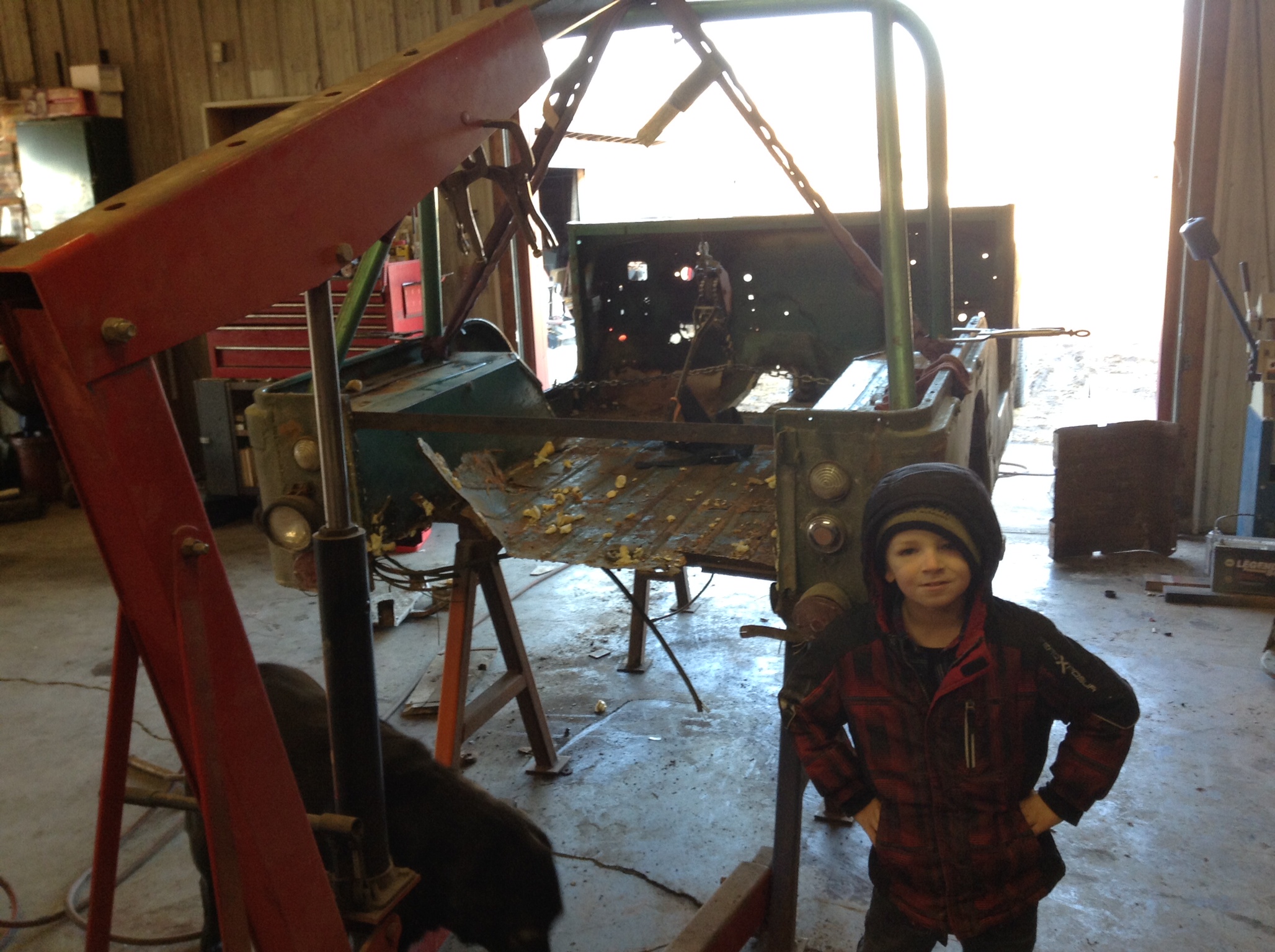

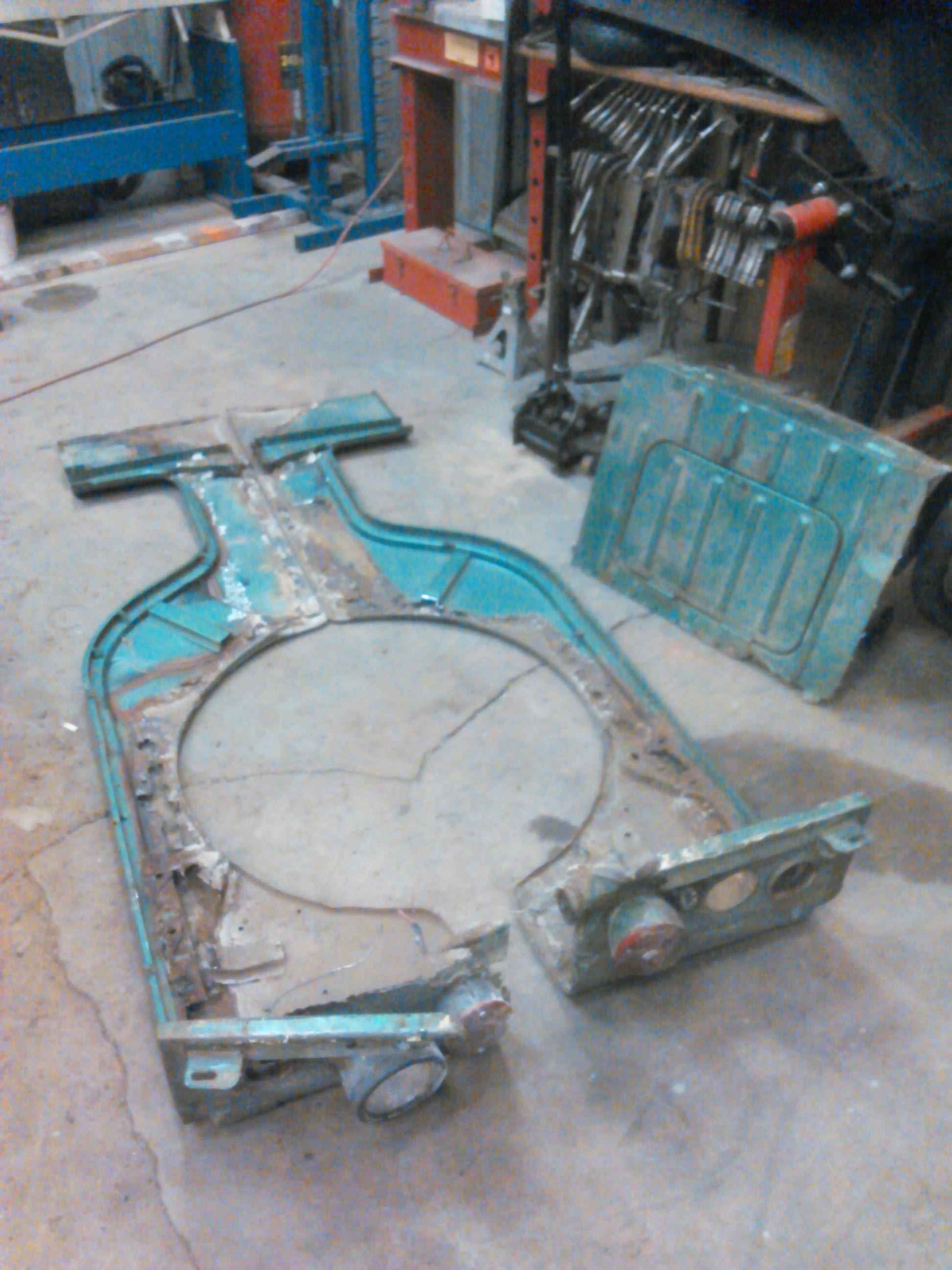

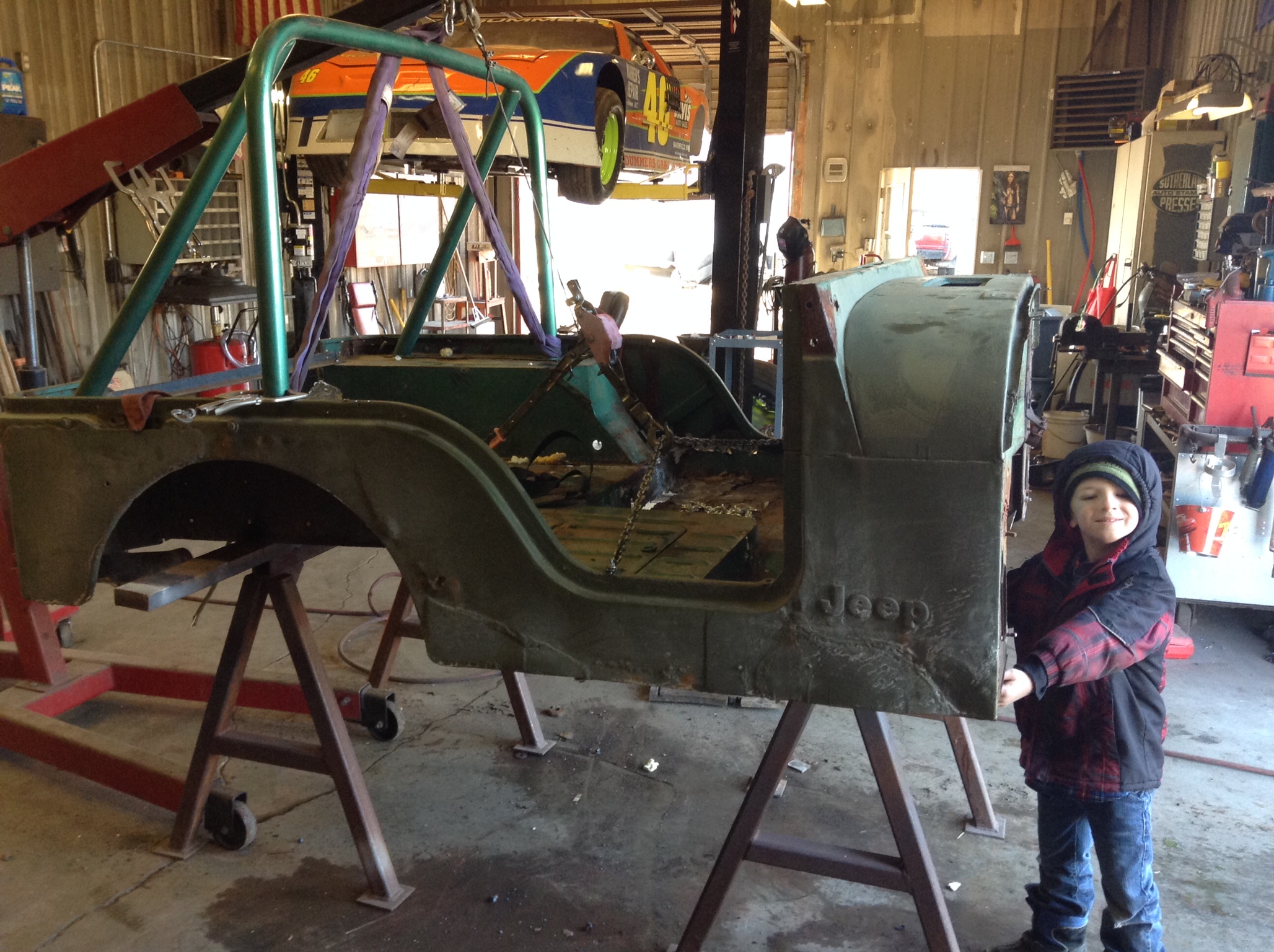

With my little helper by my side I got the body separated from the frame.

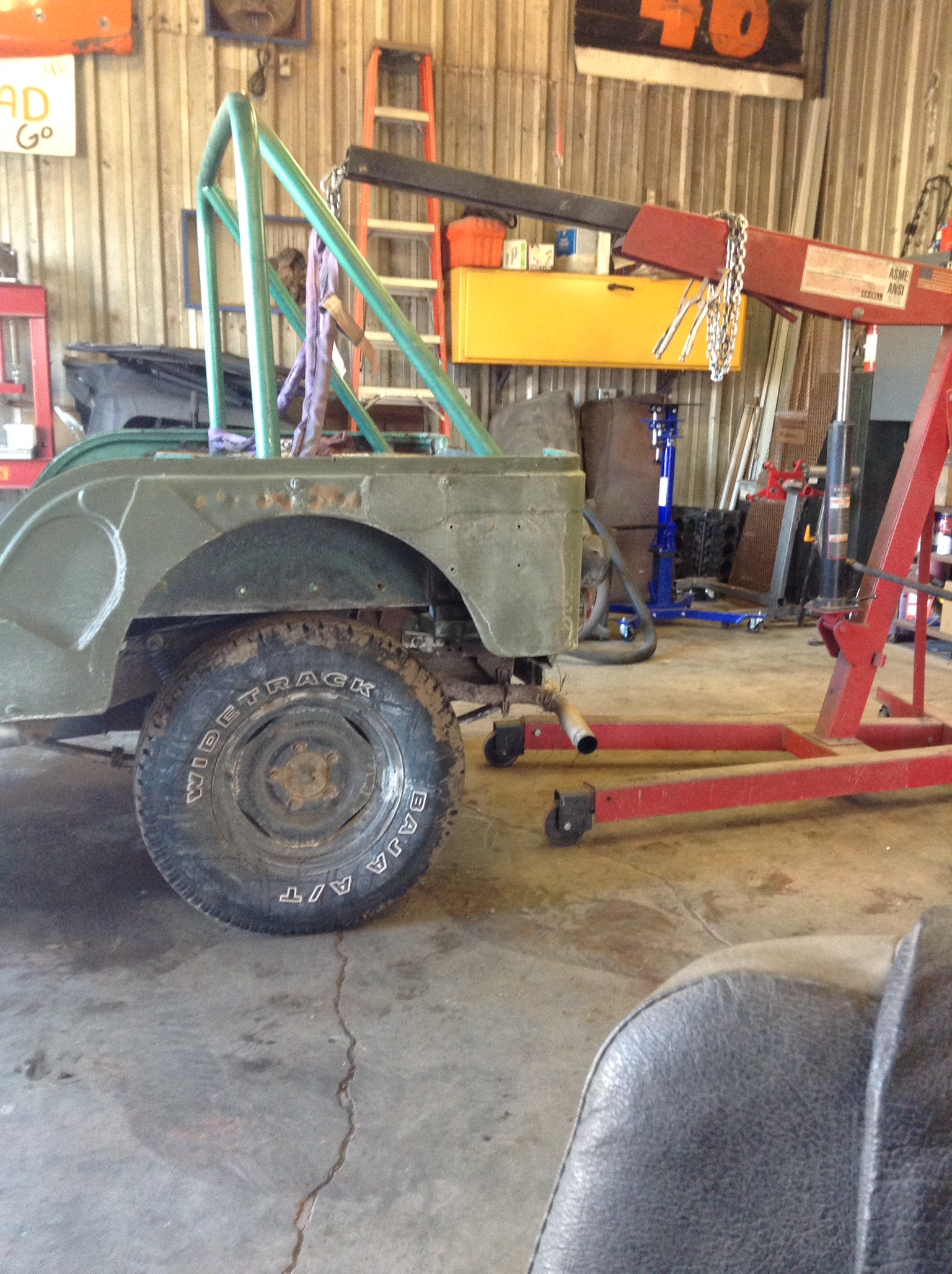

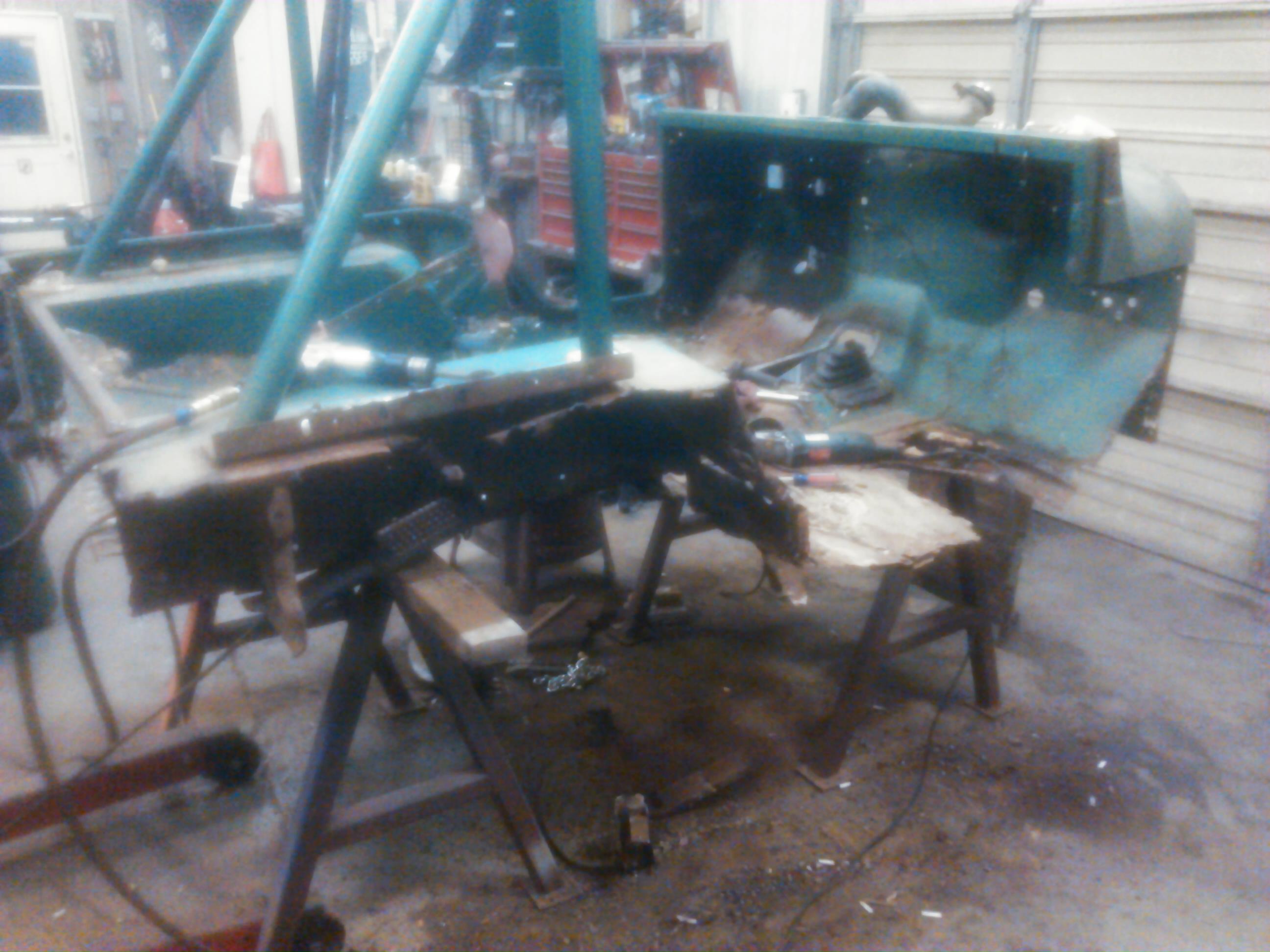

I was able to save some of the tub, and will use the rest as a template to rebuild off of.

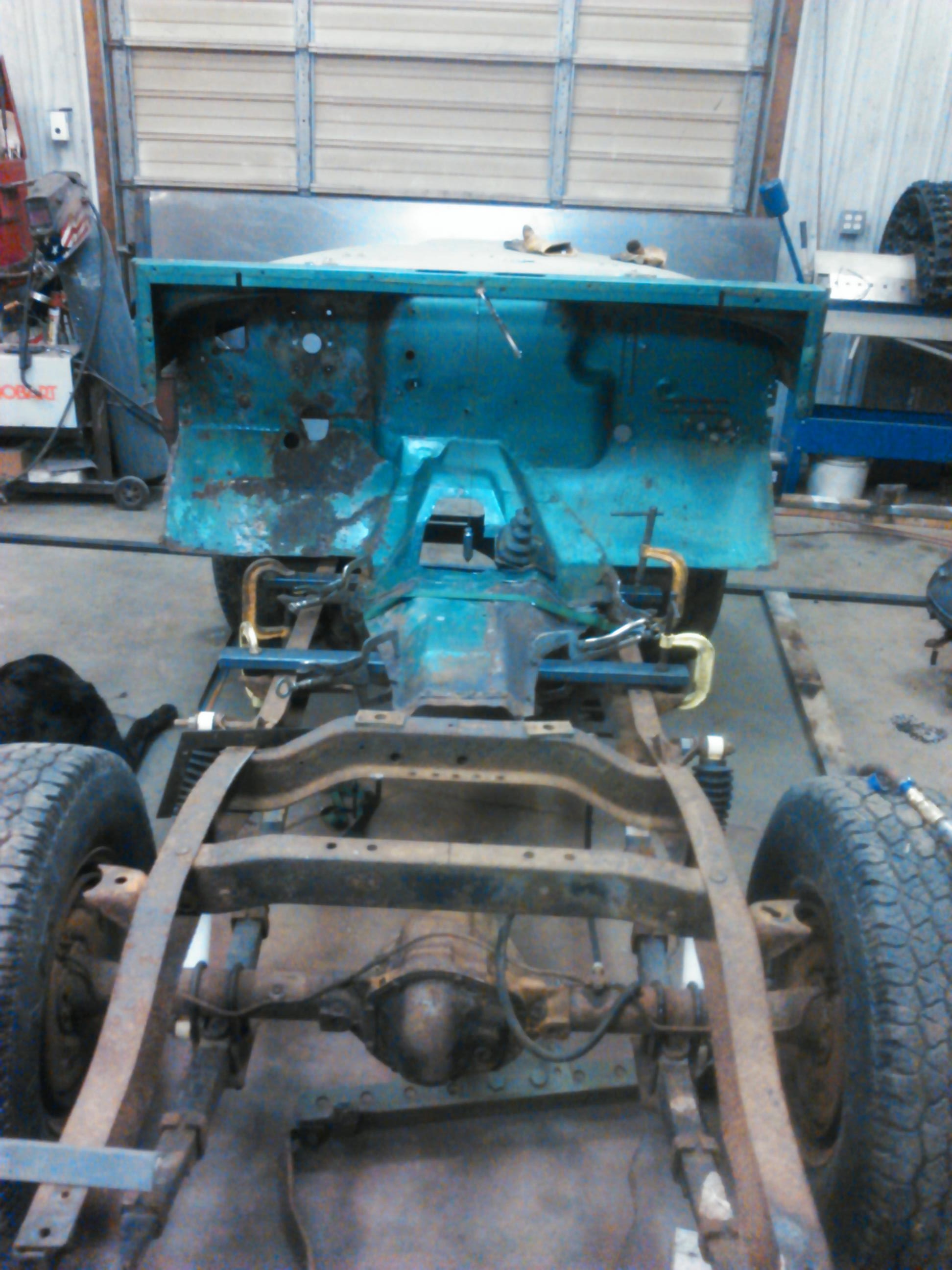

I will be reusing the hood, firewall, transmission tunnel, and front grill. The rest of the body I will be remaking myself.

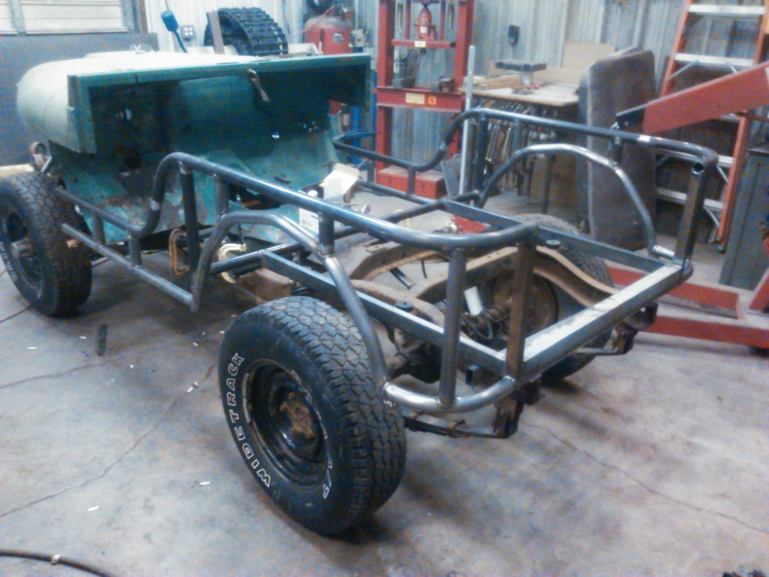

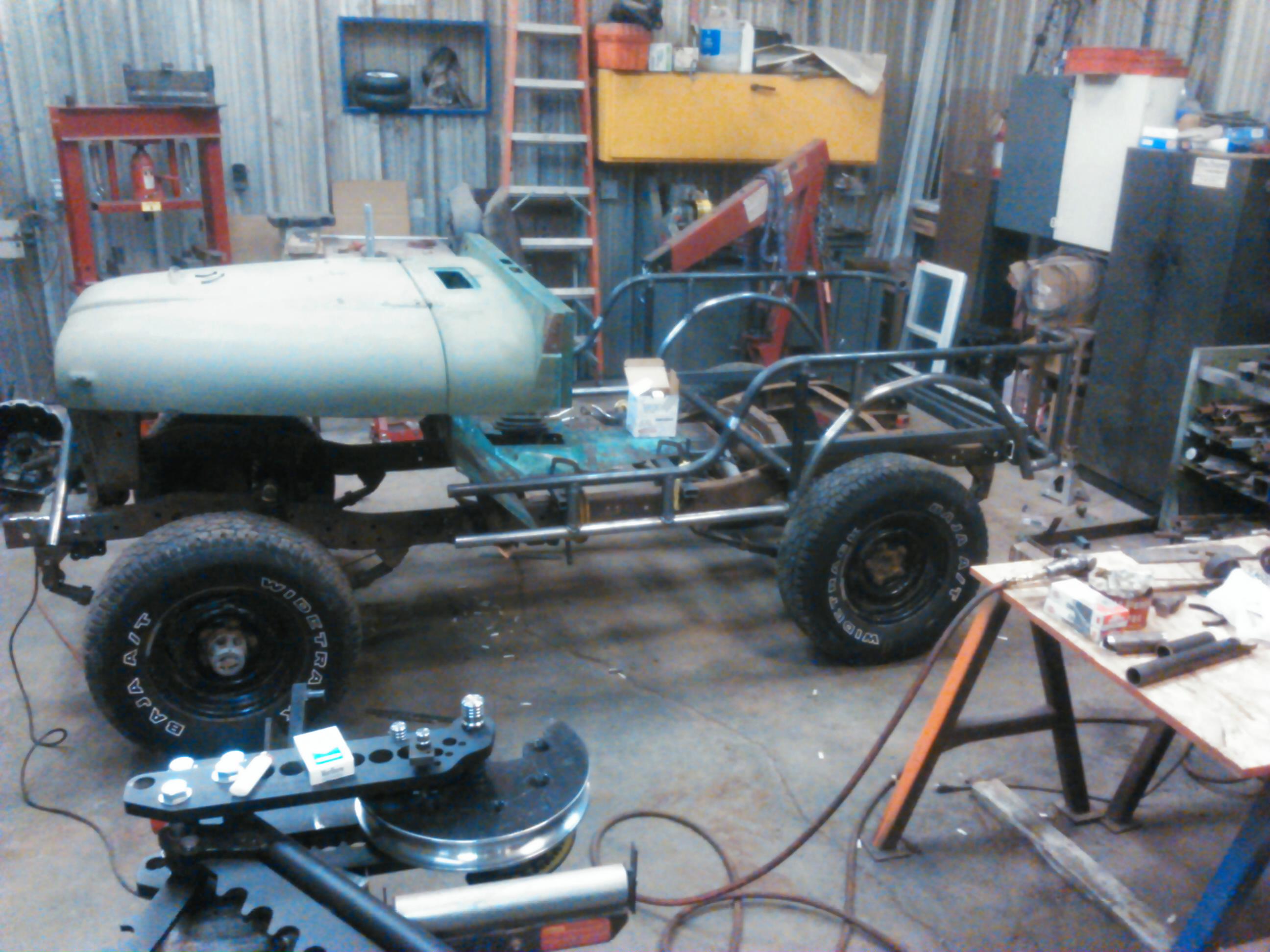

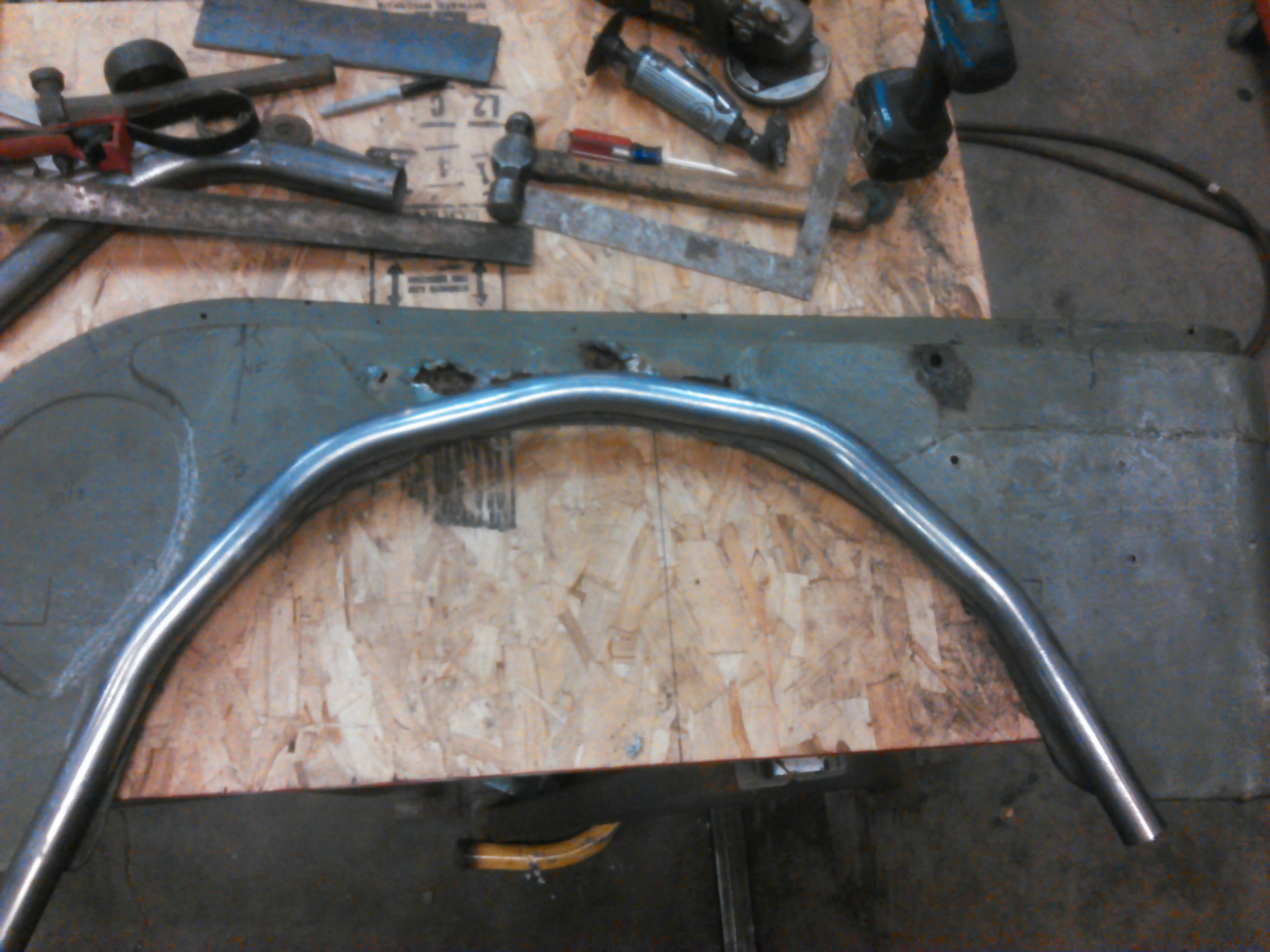

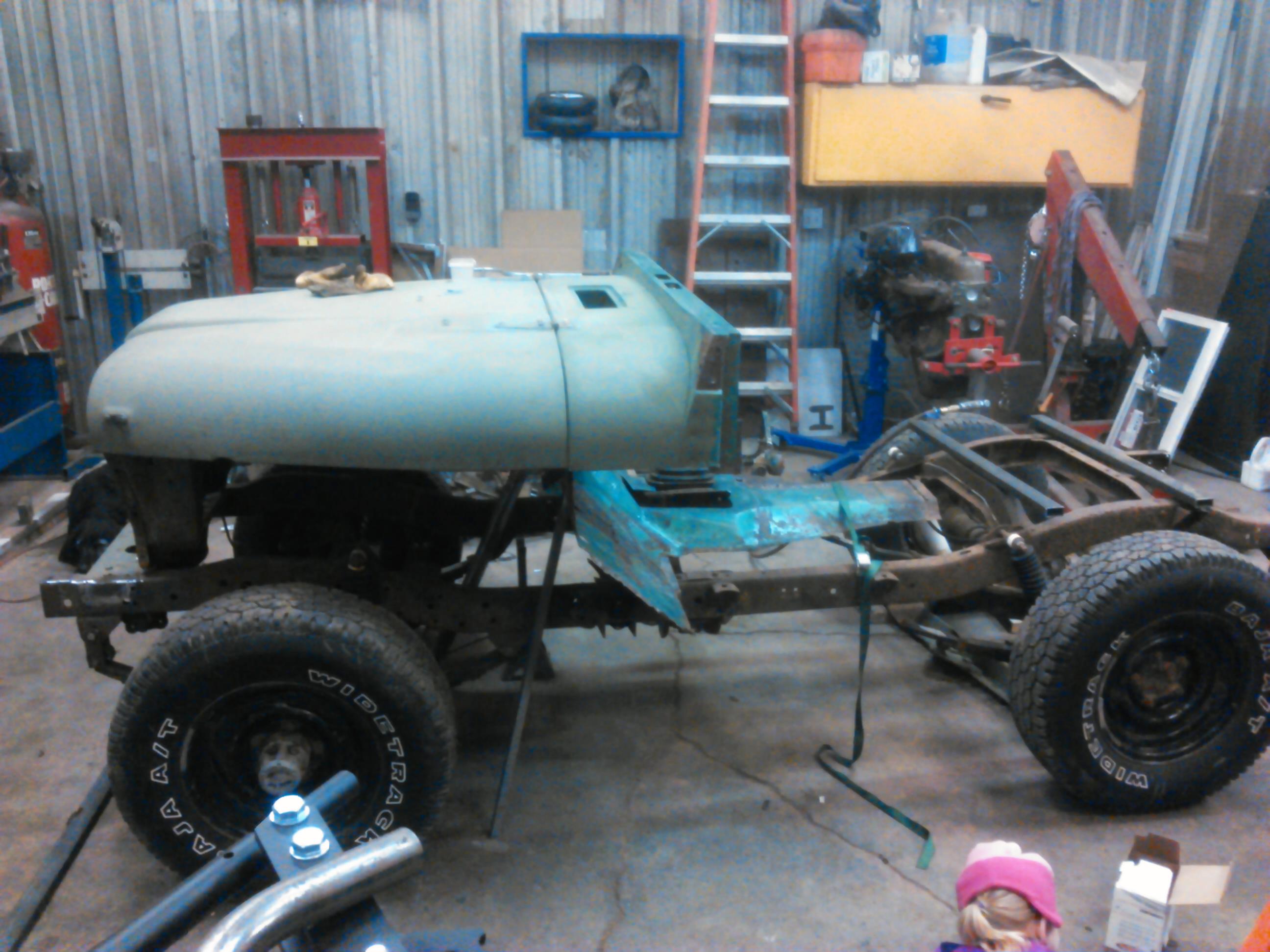

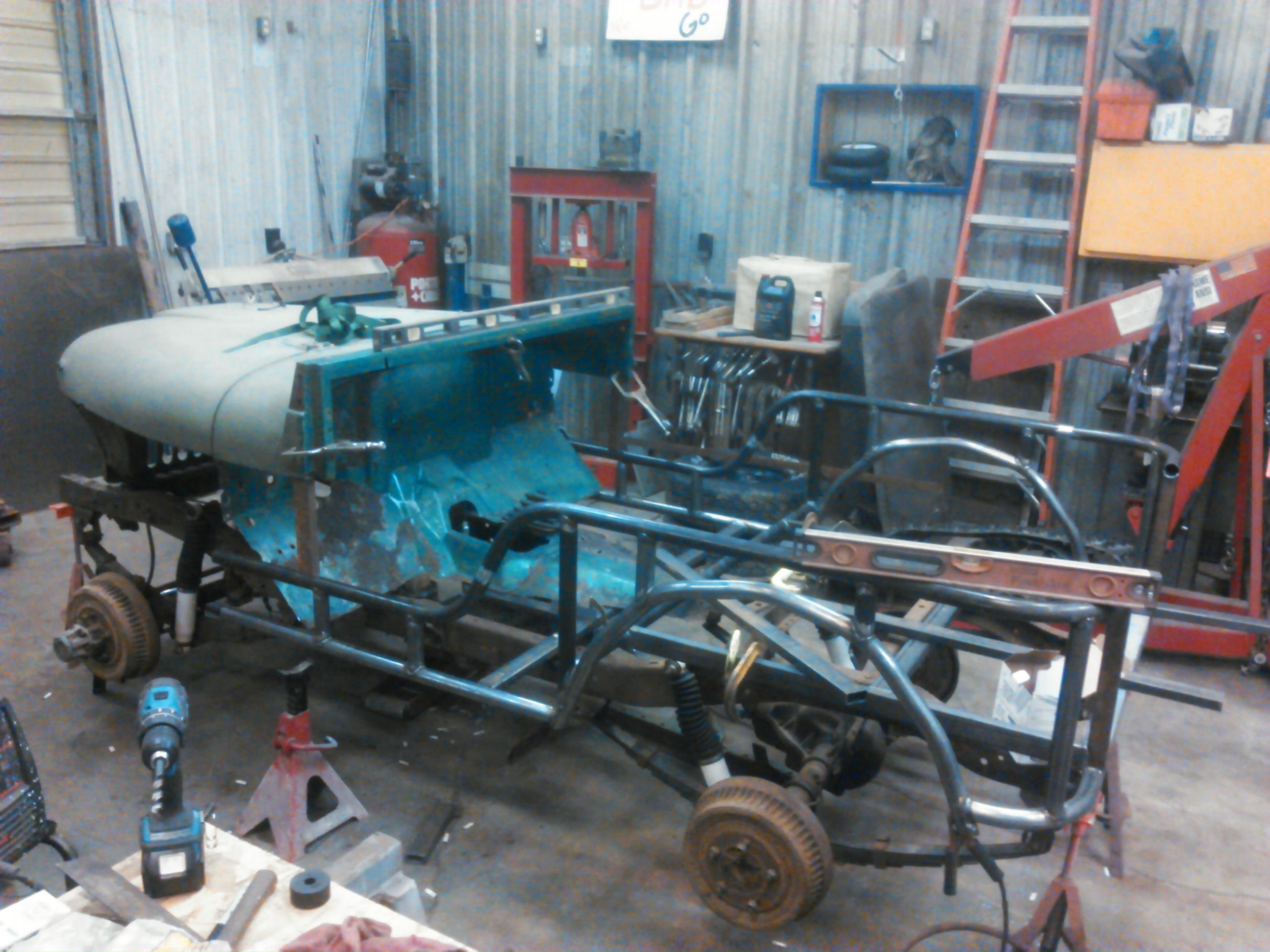

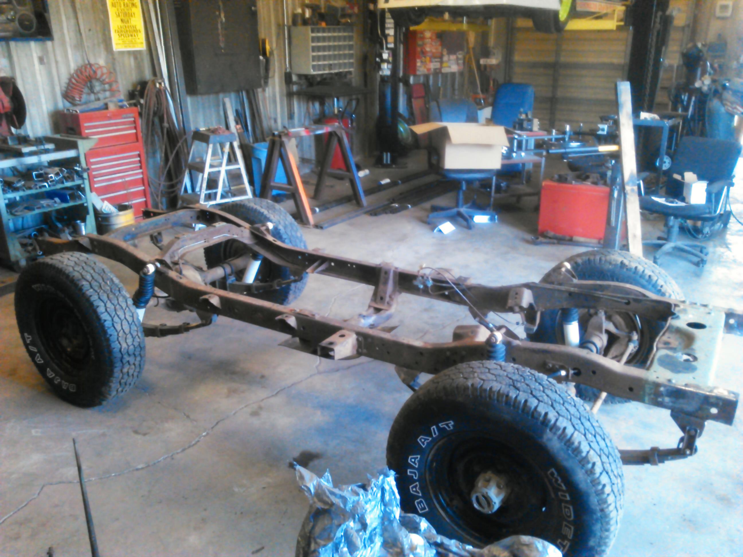

Cleaned up the frame and staring mocking up the new body. My plan is to recreate the tub and fender frame using roll cage tubing. It's been coming along very well.

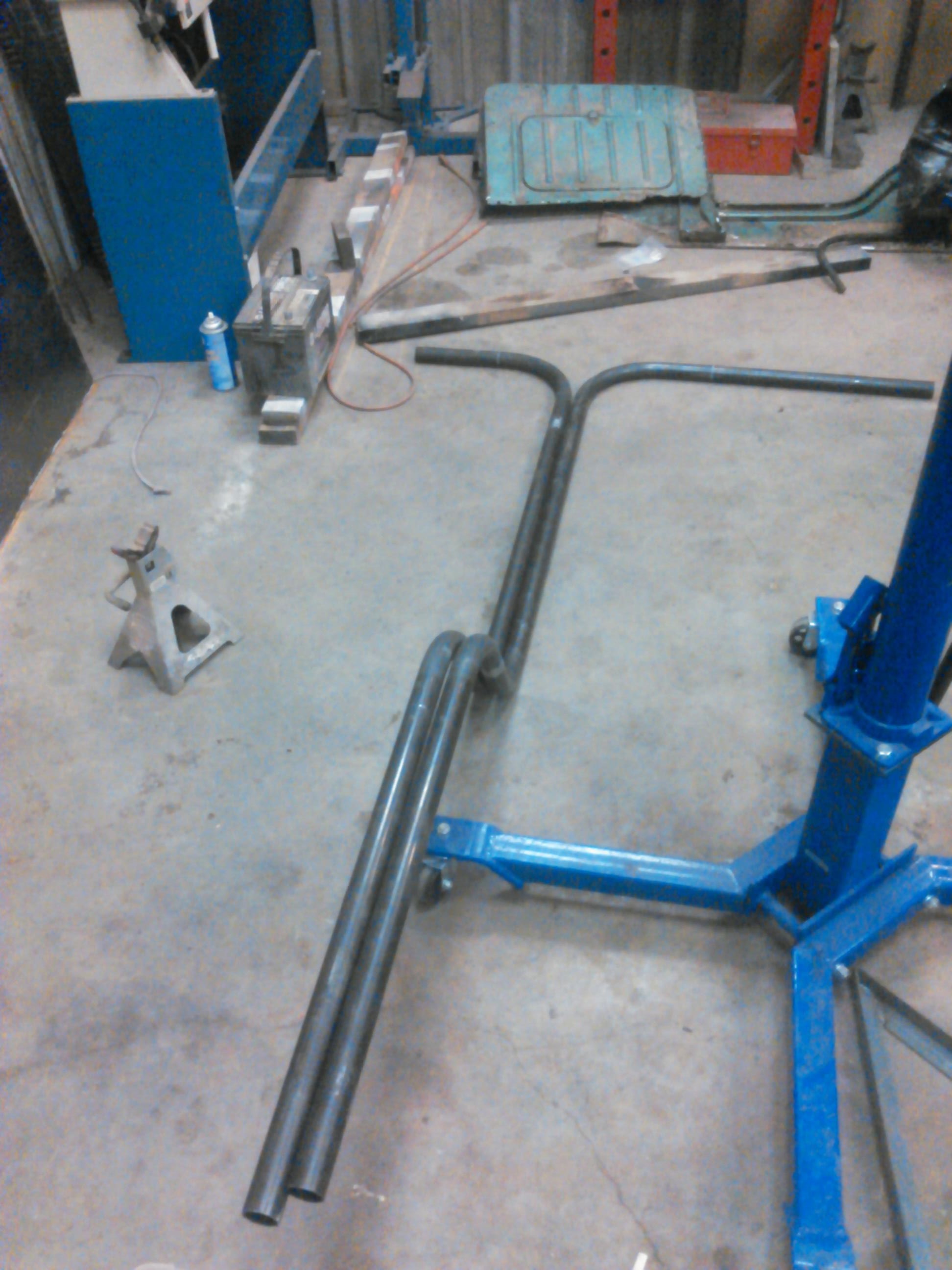

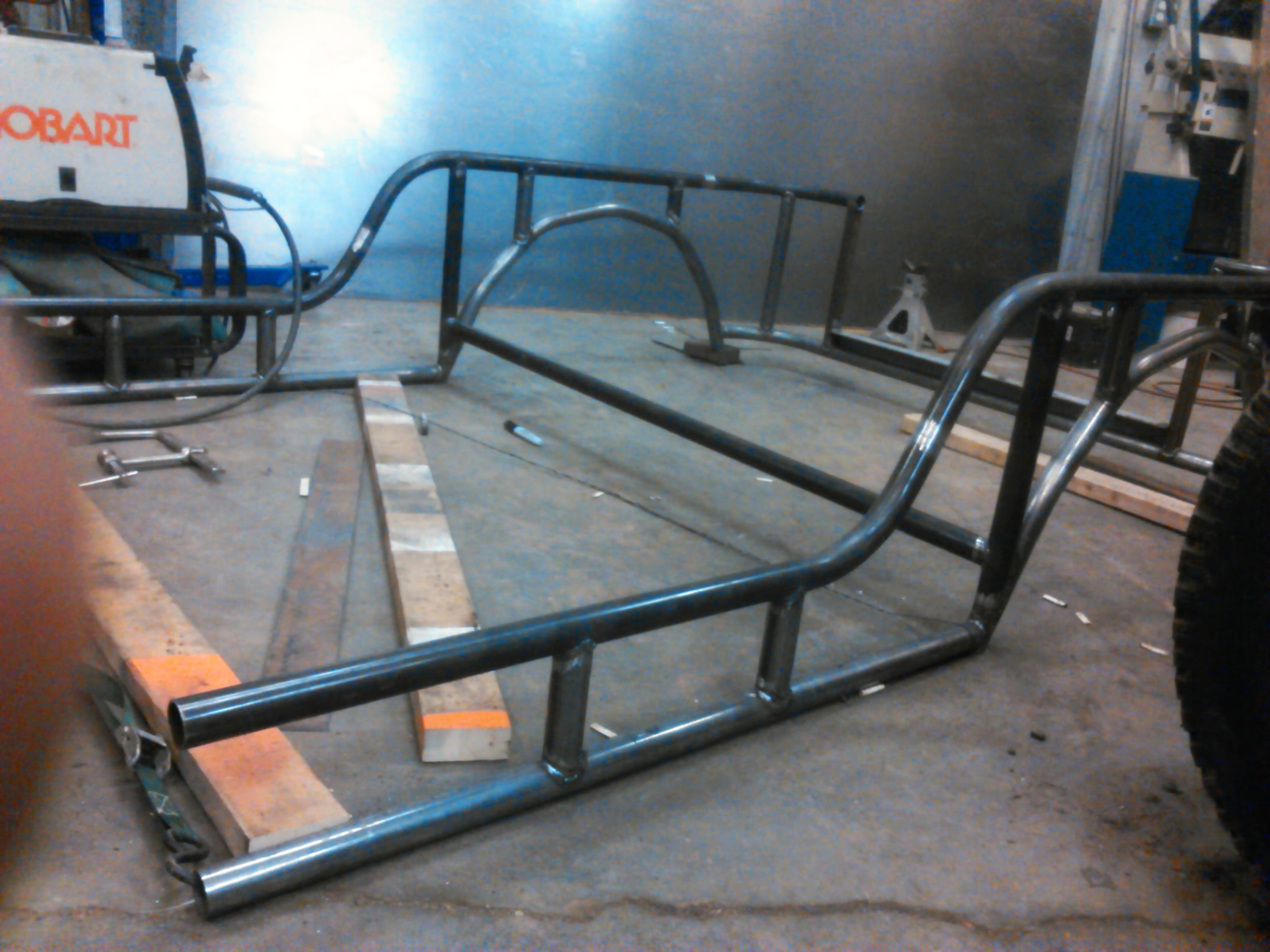

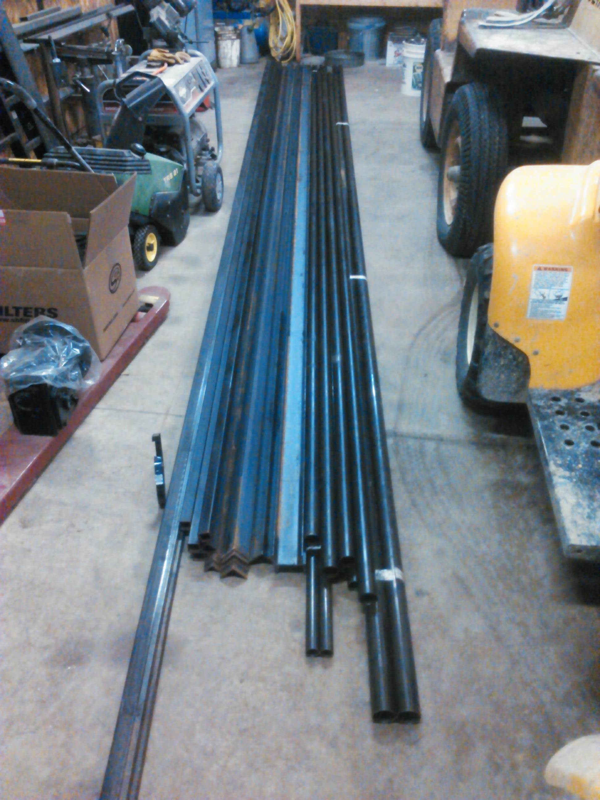

Got all my pipe delivered about a week ago and have gotten the tub bars bent, just have to weld in the stand offs and get everything squared up.

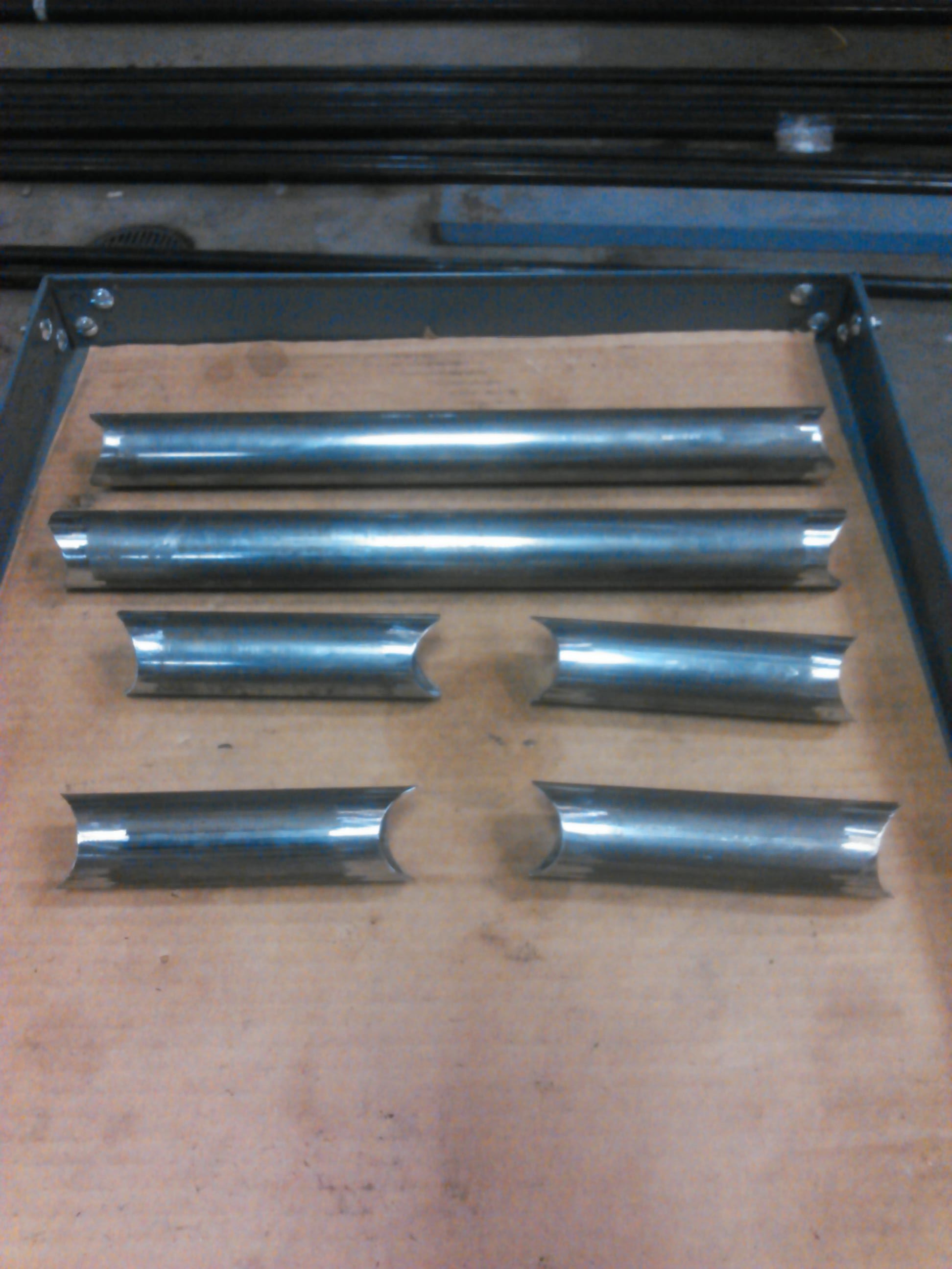

Short night in the shop, but I did manage to get the stand off pipes I need to connect the top and bottom rails done.

I like the cherry picker idea, I saw that on the Scrambler forum. Also saw where the same guy used 2 engine stands as a rotissery for the tub. He had a long piece of pipe clamped to the front leg of each of em to make it stable. Looks like your doing a great job, good luck with it.

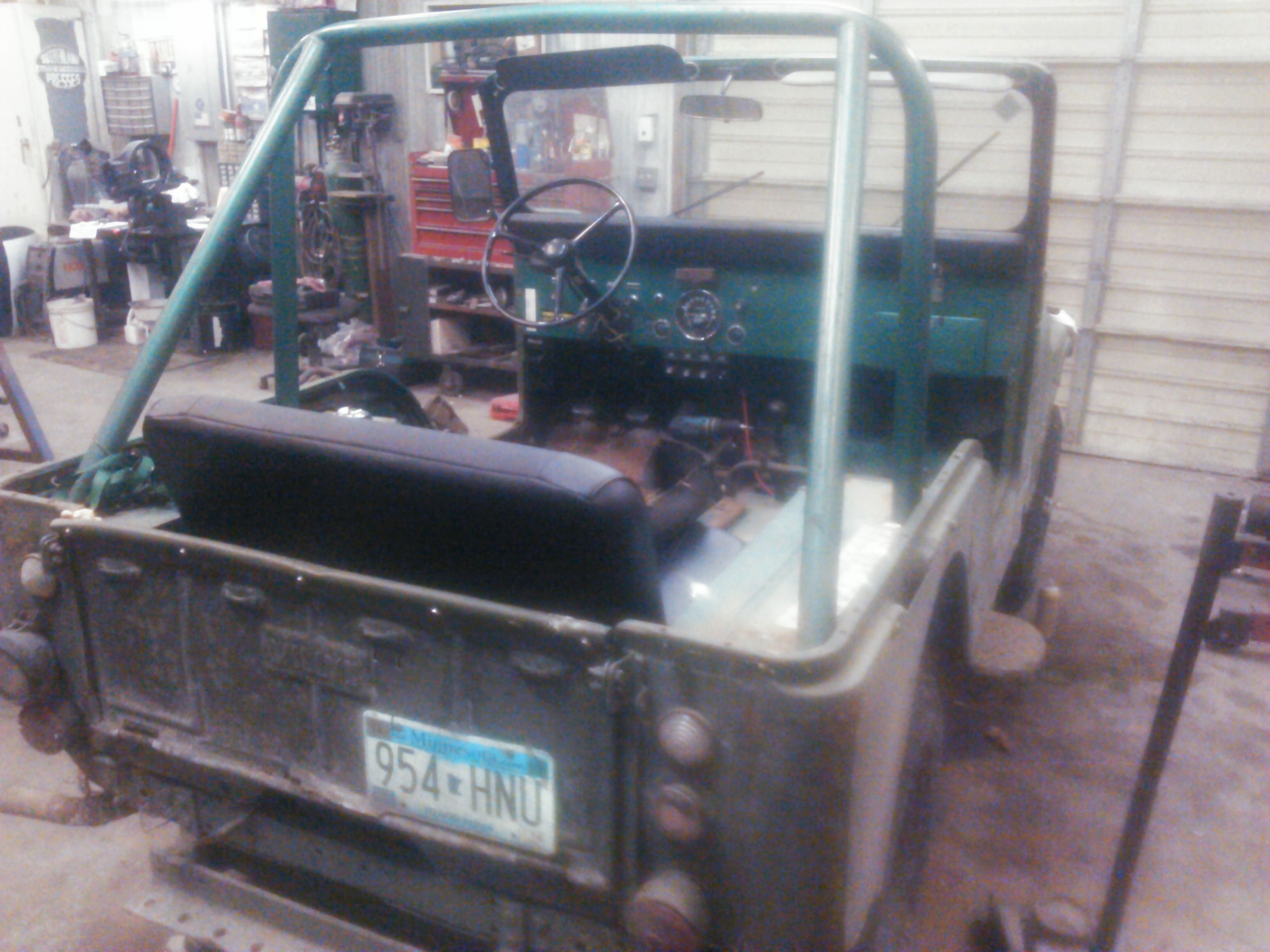

Been on and off this last few weeks. Got the tub all welded up and mounted on the frame. Have two more mounts to make and then I'll be working on the role cage.
Here is where i'm at on the body.. I've got just one mount to make on the passenger side. Then I'll start putting the floor in and building the rest of the cage.. My brother and I keep going back in forth about how to plate the side... One idea is to fill the cut outs between all the stand offs. Doing this would expose half the pipe on both the inner and the outer part of the cage. The other would be to rap the tub and make it look more traditional.. Thoughts?
