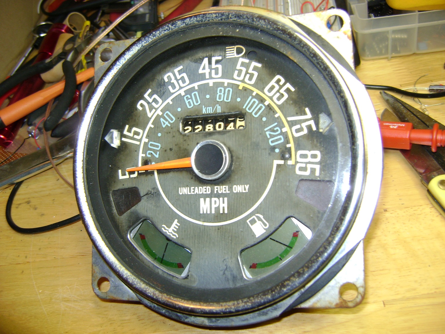

Glad I had two speedometers....
Got it ready to install the better looking face now.

There's been more than a few write ups in the quirky gauge situation on these speedometer heads here's a couple;
Fuel and Temperature Gauges Troubleshooting 1972-1986 Jeep CJ's
Jeep CJ Gauge & Sender Diagnostics
and this one is the one that I used to get my gauges straight by John Strenk, a really good guy.
CJ Gauge Specification Chart
CJ Speedometer Gauge Quick Test
The new Gauge Page
all this info being said, my own experience was I found there was a couple of manufacturers of these gauges available in my area when I did mine. Primarlily the speedometer to dash to body tub to ground strap to negative battery terminal grounds are so prone to oxidation interference that I've come to suspecting ground issues before approaching anything else, especially in this PacNW climate. To complicate matters, twice the made in China gauges were failing until I found (by dumb luck) some N.O.S. made in the USA gauges and I've had no trouble since.
I agree on the China gauge, but I also bought some American built ones. They have started making the pivot for the pointer from nylon.
The heater wire inside will melt it.
I finally gave up, don't really like the idea of putting that much power to a full tank of gas.
Mine will now run with 1 volt to it, at 10 ma.
It drives me nuts to have something as simple as a gauge stump me.
I did find lots of information on the web. It saved a lot of time at the bench.

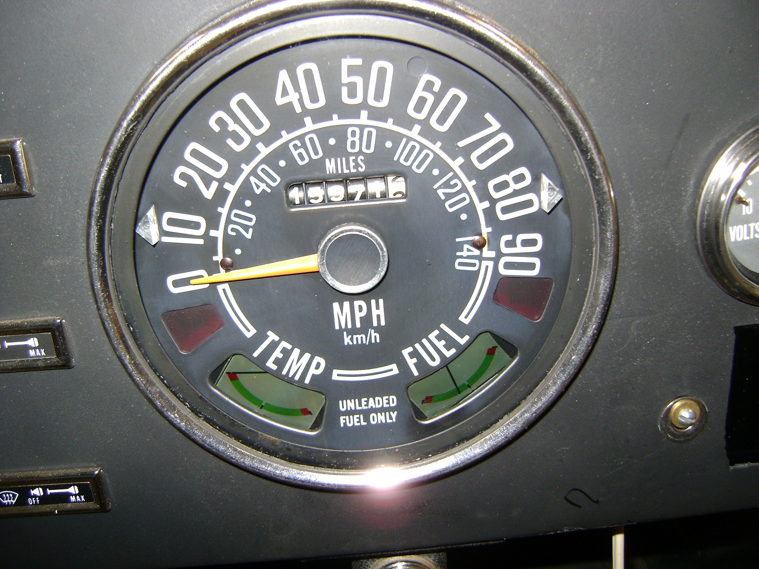

Well, its finished. It turned out pretty well. Now I have fuel, and temperature that work, with no load on the sensors.
Now to work on my stereo....

Eventually my old Jeep will be all digital. I want to not modify it in any way. An gauge, radio, or switch can be put back to OEM.
