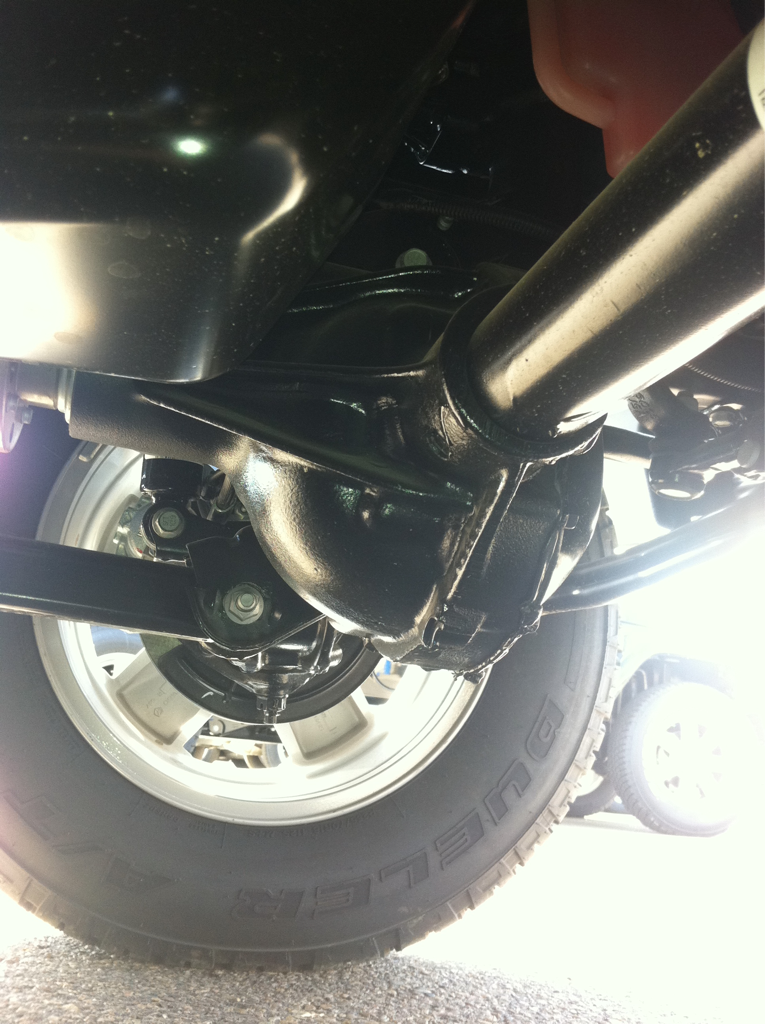

Thanks Jesse. I've attached a picture I have of my front diff (not a great one I know, but hopefully it will help). Is this high or low? When you say "on top" do mean top-halfish? My front pinion seems to be nearer the top of the casing (when compared to the rear)...I think :redface:

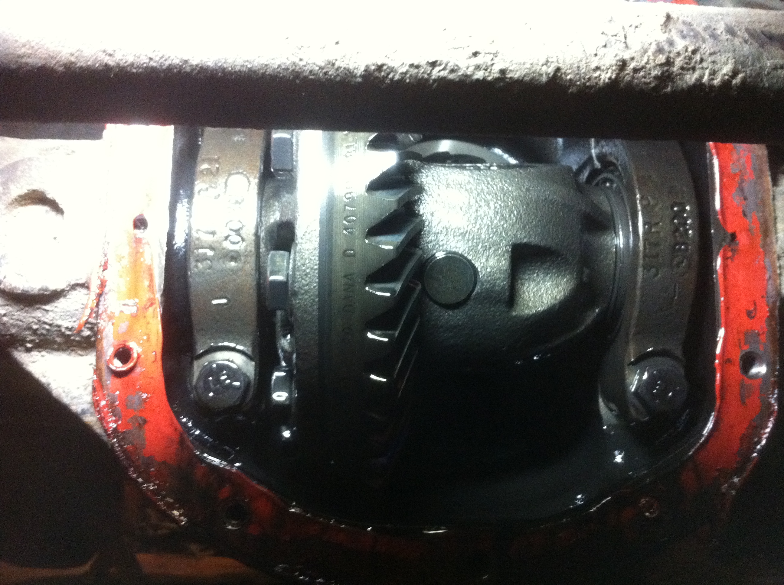

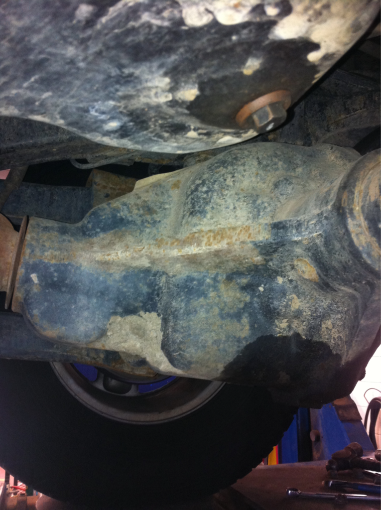

The first one is a low pinion note the pinion is on the lower portion of the casing. And vice versa. For the other

Thanks bounty. I wasn't sure all I've owned is xjs and a few big block chiefs.
