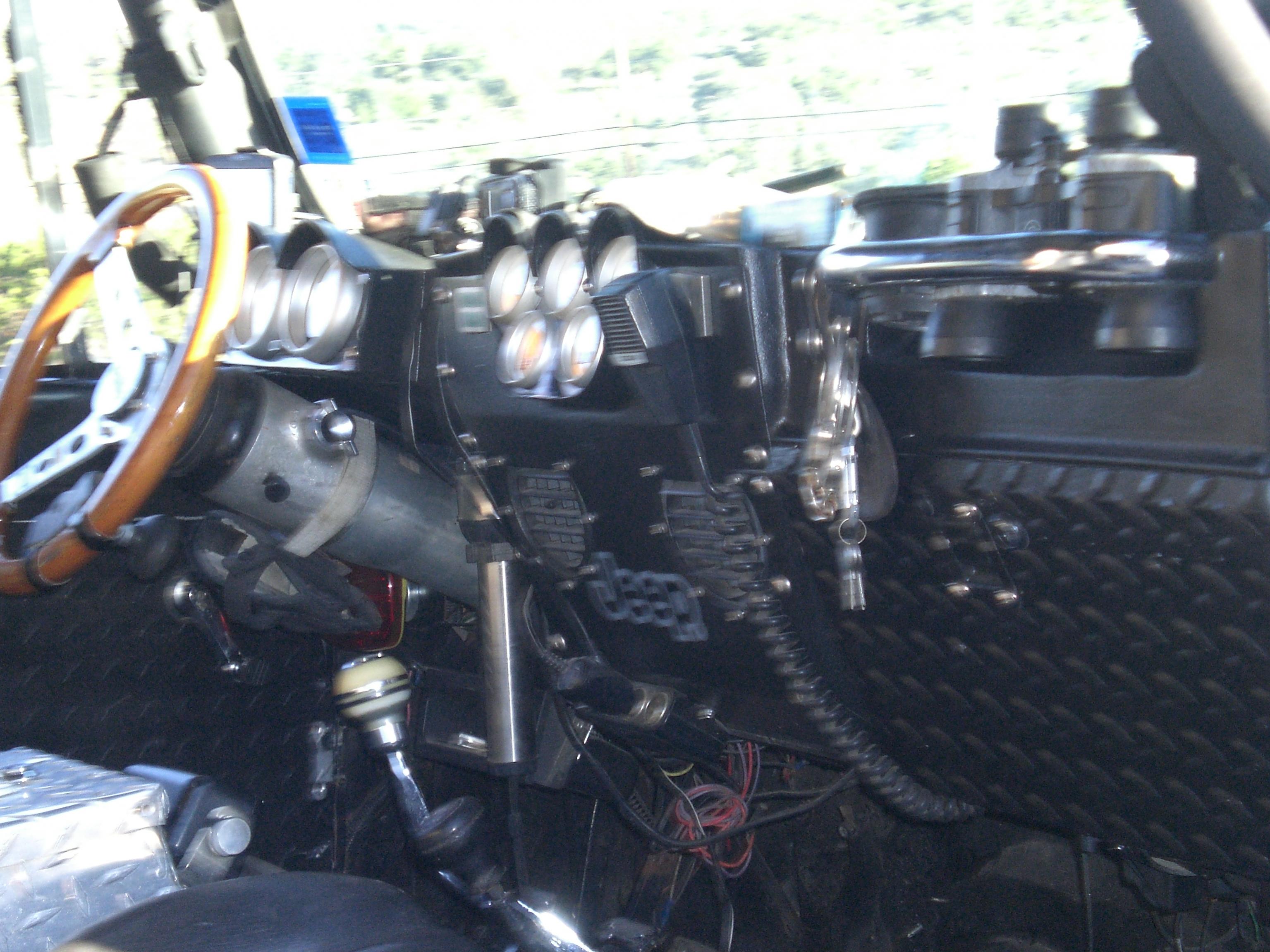

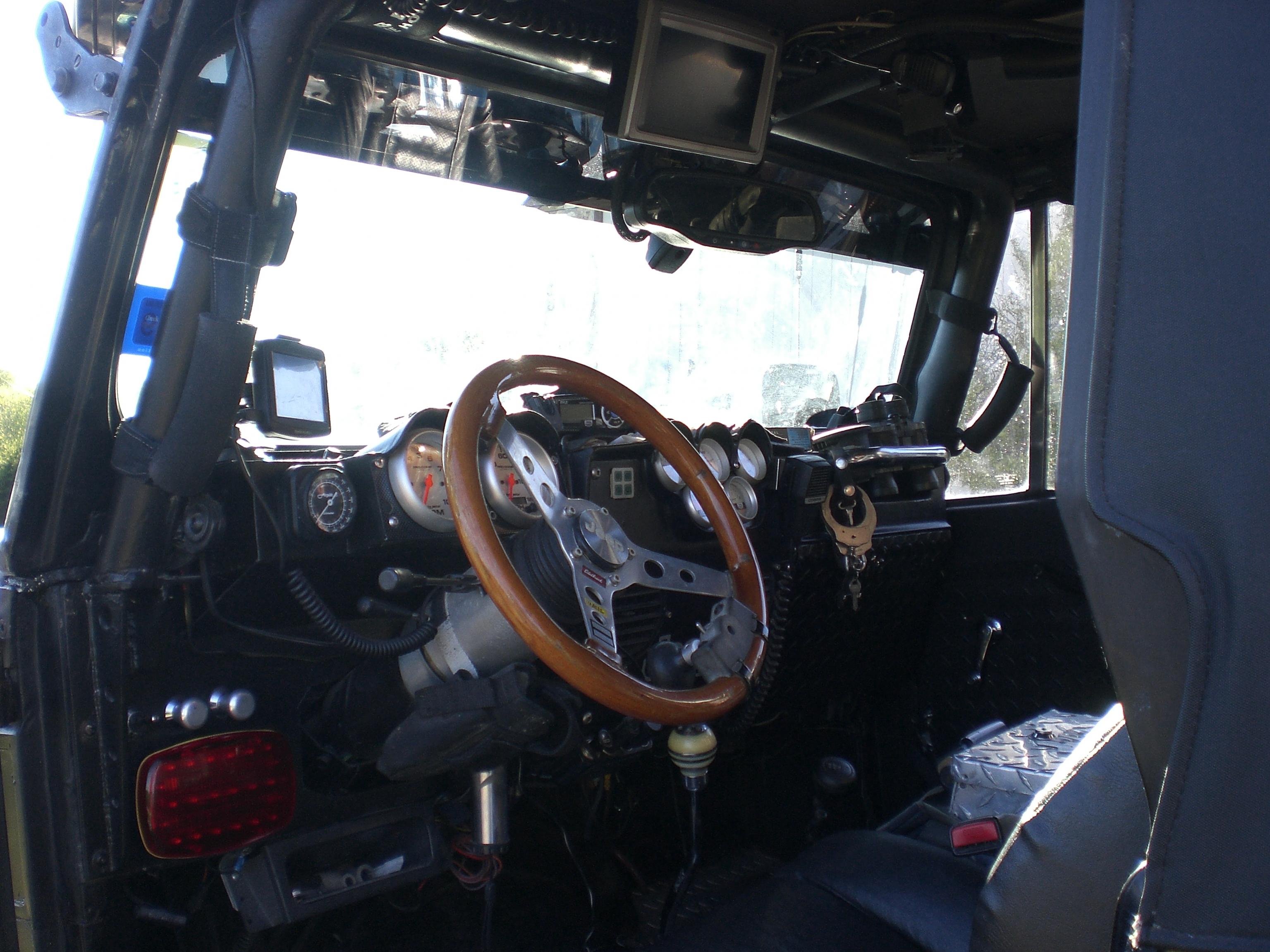

I replaced all my gauges with autometer ultralight. I really like it.

holy crap, looks like you have done your fair share of customization... looks good, i have never seen one set up like that. Ok, so i took the jumper/regulator strap off of the back of the gauges.... Everyone says that it is supposed to reduce from 12 volts to 5 volts. I took the insulator wrap off of it and all it is is a strip of metal! it has no resistance at all, so is the 12 to 5 volt resistor inside the fuel gauge? that would possibly explain why they say to replace the fuel gauge with the temp gauge.

Holy Schneiglies SteelHeadz, and I thought I spent time on my dash~!
