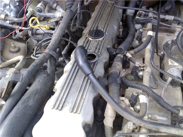

so im doing som routine maintenance on jeep (new hoses and such) and what appears to be my blowback valve is in dire need of repair. i went to autozone and they have no idea what it is. (no suprise) but heres a picture of it. im pretty sure that it is a blowback valve, but autozone pulled up a totally different looking part on there computer. (probably for the 40. HO im assuming) any one have any ideas as to what this is and where i can get a new one?

It's just a rubber elbow and a grommet, no valve in there I know about.

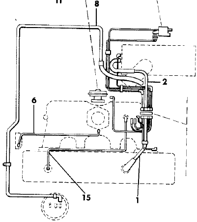

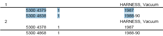

The picture (in the parts catalog) is a little ambiguous. My guess is it is number 1.

The part you are talking about if i remember correctly is just a breather hole for a valve cover its a 2.2mm orifice that most places don't sell you might just have to use some ingenuity and get a grommet that will fit and adapt from there
hmmm. do you think if i went to a junkyard and got a used one in decent shape that it would work? my mind hasnt been very creative as of late:p
In my experience the grommet gets pretty crusty, fairly quickly and looses it's flexibility. Good luck getting one out in one piece. Somebody had a kit with most all of the vacume lines, but I sure can't remember who it was.
