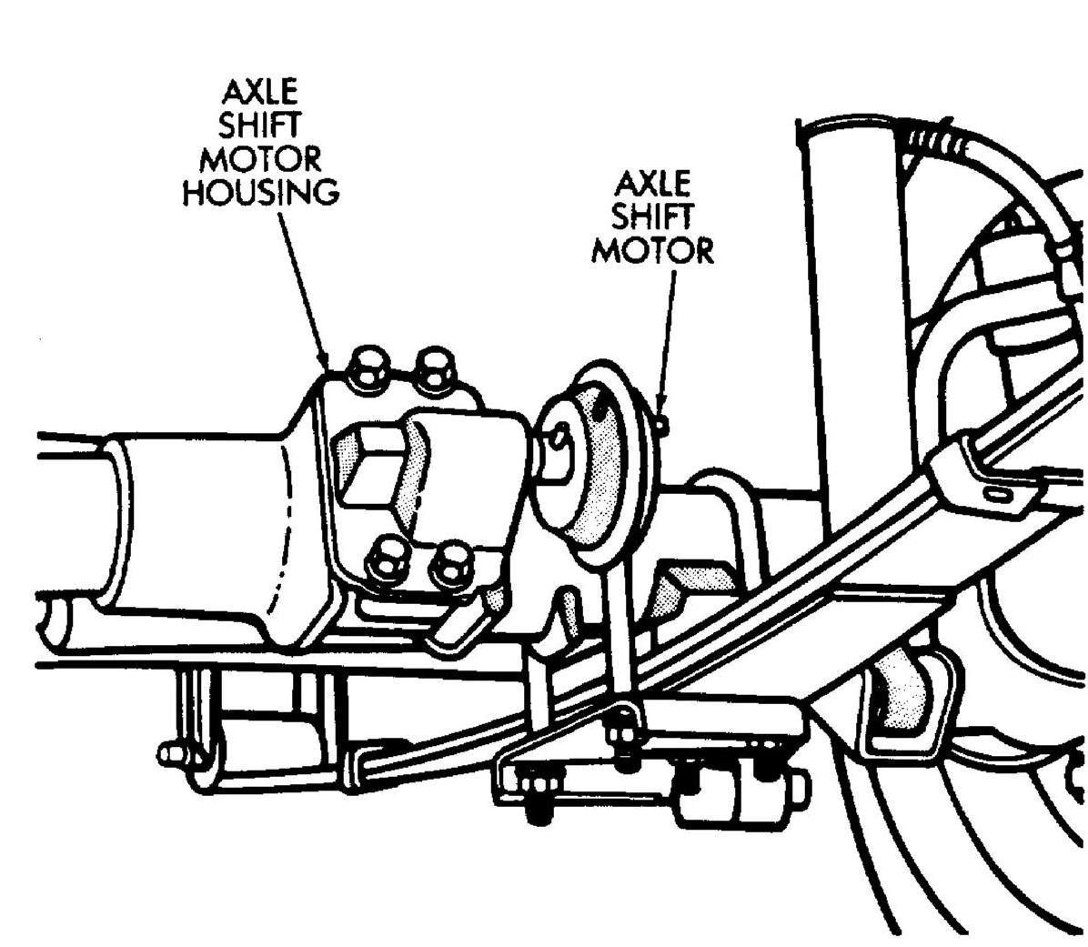

What he said ^^^ is accurate. Here's what the vacuum disconnect on the front axle looks like, looking from behind the front passenger tire.

I would start by pulling the two vacuum lines from the front axle, usually black, that feed the disconnect from the transfer case switch. With the vehicle running, have a friend shift the transfer case from 2wd to 4wd, while you feel for vacuum in the two lines. Strong vacuum should switch between the two lines depending on 2wd and 4wd.
You should also remove the 4 bolts holding the disconnect to the front axle. Remove the disconnect from the axle housing and move the shift fork by hand. It should move back and forth easily, forcing air out of the vacuum ports when moved. Rusty water may also come out the vacuum ports.
