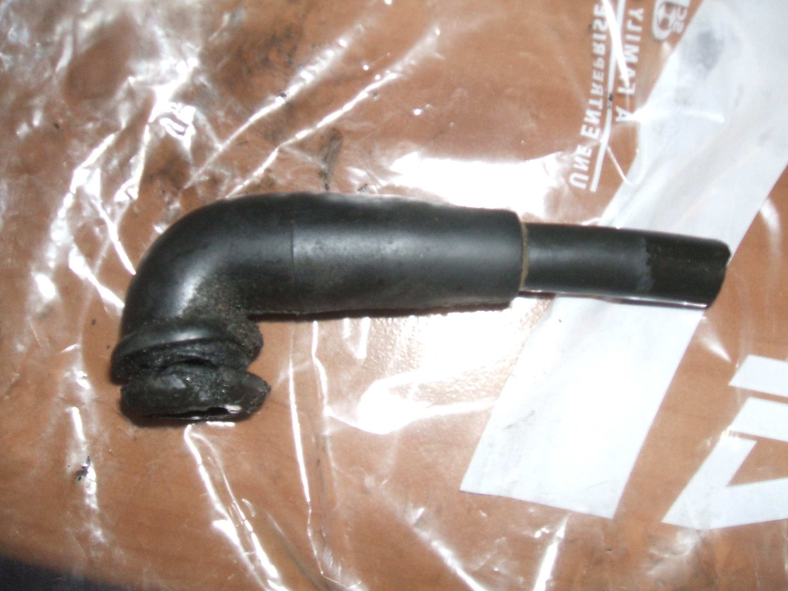

I just picked up my Jeep and I'm new to car repair in general. I noticed this valve and hose line was damaged after purchasing and need help identifying the parts so I know what to purchase. Thanks for any advise...

I've not seen the pieces individually, they do come in a kit Jeep number 5300 4838 Harness, vacuum. I've heard Auto Zone can order the kit for about half of what the Jeep dealer ells it for. Crown automotive may sell the pieces separately.
The rear CCV hose (plastic line) on the valve cover seems to be necessary (in my experience) also, when it's missing or plugged the air filter tends to fill with oil and/or various seals may start to leak.
Thank you so much. I was able to finally find an Autozone that will have it in by this week using your help. Im sure ill have more questions as I continue to look closer at my engine.
