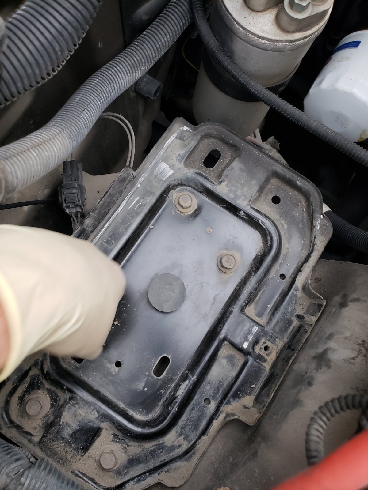

Also consider there is a battery temp sensor under the battery. If it goes the battery will not ve charged to peak voltage.

Not certain what year the sensor wss introduced.
