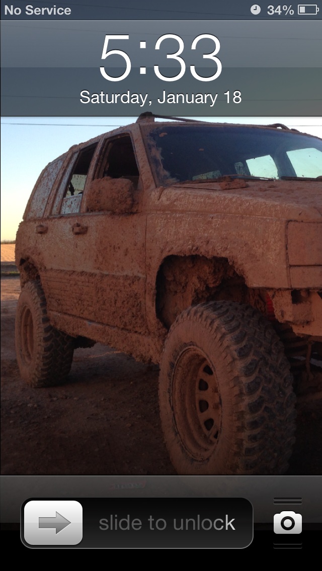

I have a 94 grand cherokee v8 5.2 Laredo AWD 4x4 and it won't start in park but starts in nuetral.
When I put the floor shifter in park it's actually in reverse on the transmission. Don't know where to start if I can get some help I'd appreciate it. Thanks
