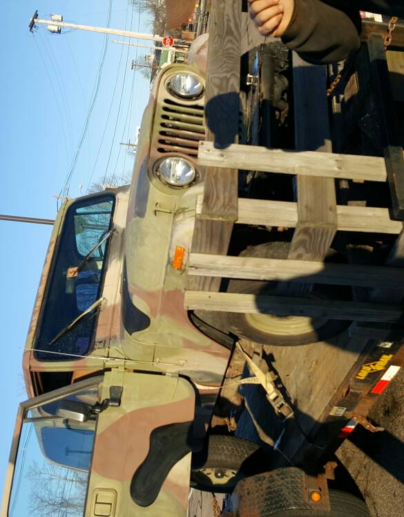

Are we talking the jeep in the pic? It doesn't look like a 95 yj

It is a 95 yj the previous owner took the hood off and put on i believe a 70's cj hood on it

Also , the second post shows a CJ7 trailered . You mentioned a trade , was it the CJ for the YJ ?
Guess he didn't like the square headlights ? Well , you know he's got a good jeep now ! The looks of a CJ and the integrity of a YJ wrangler ! Can't go wrong . Nice Camo too !
I like the square headlights on the yj. it separates the yj from the rest. you can always tell the original wranglers by the square headlights.
