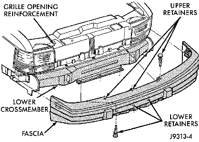

Most likely, the fascia needs to be shimmed somewhat to get the face lift you want. The front bumper on your GC is a Fixed welded crossmember on the front and has a molded ABS plastic where the facia attaches to.
It looks like I'll have to remove the grille, I copied the illustration if I can't straighten it Ill get the mechanic to have a go when he fits the new front spring next week.
