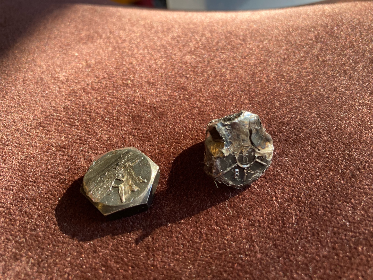

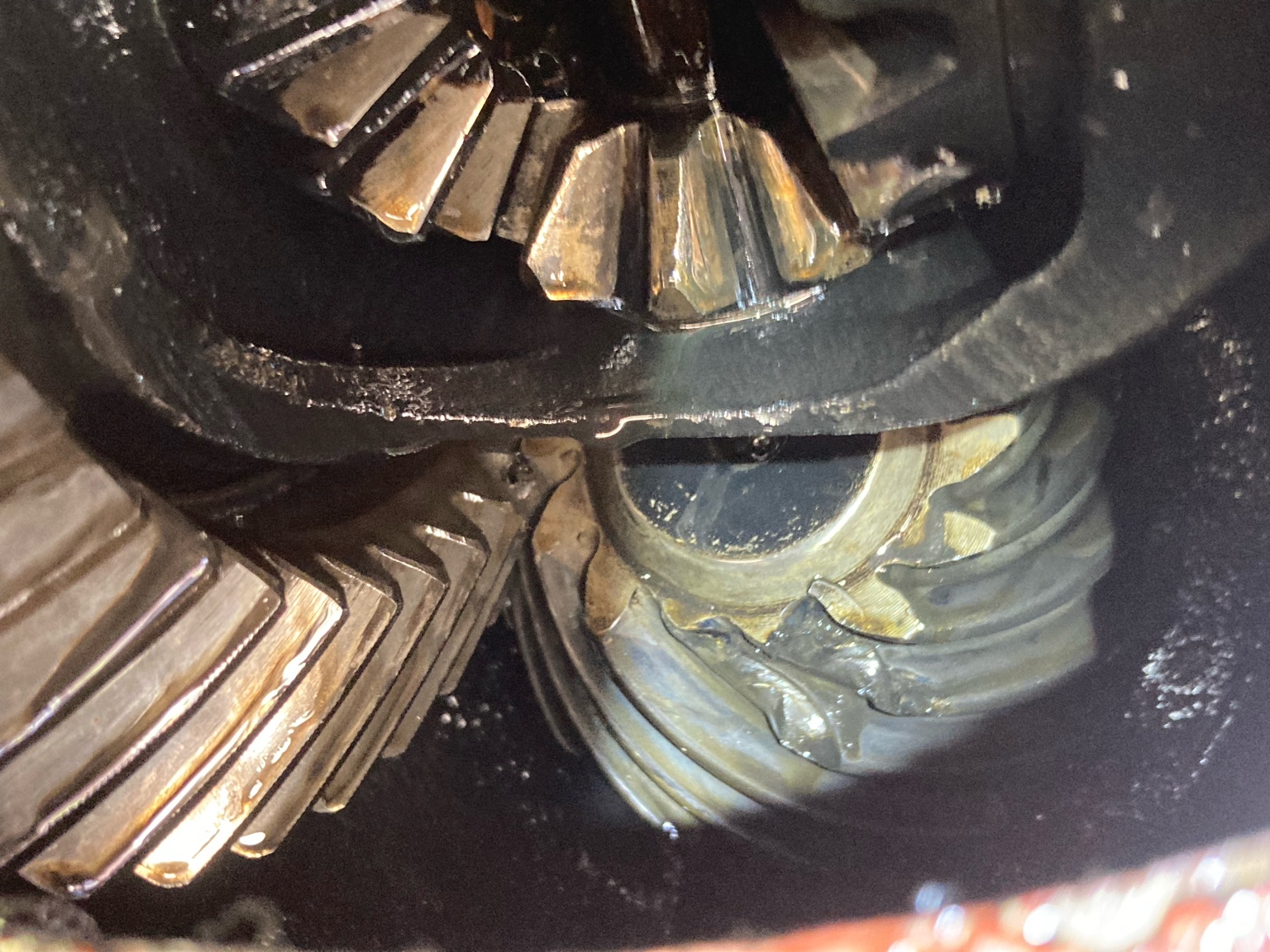

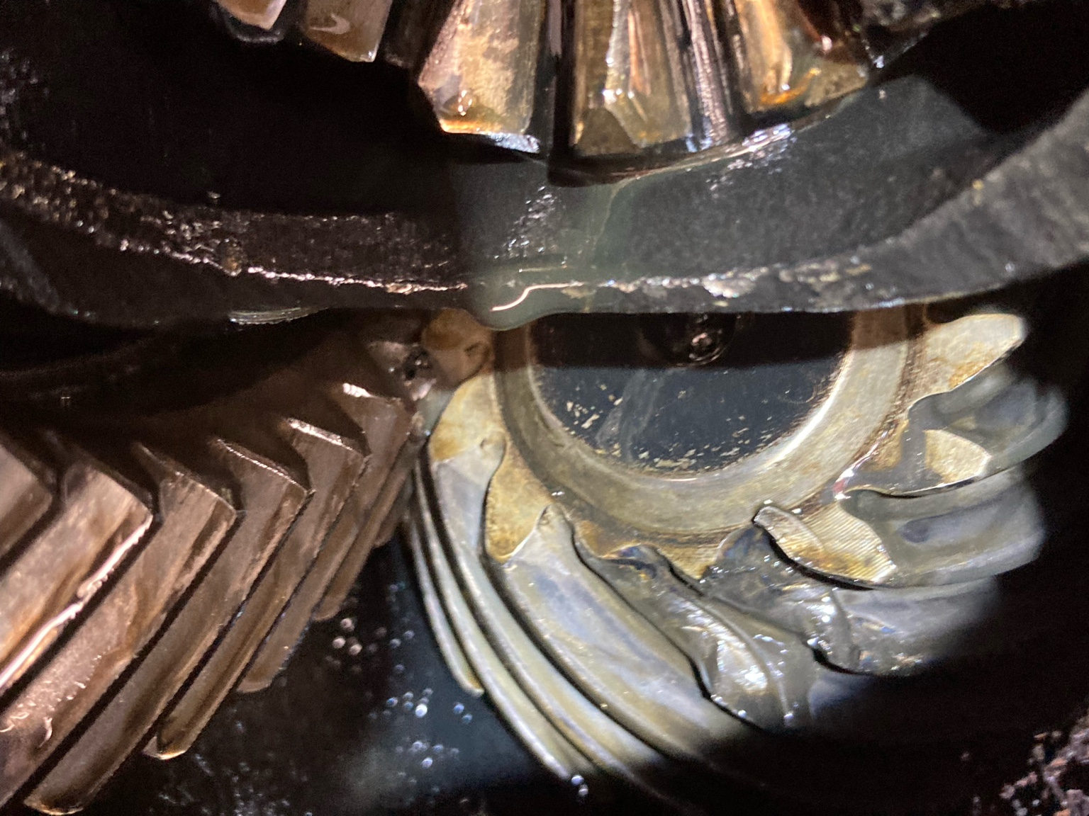

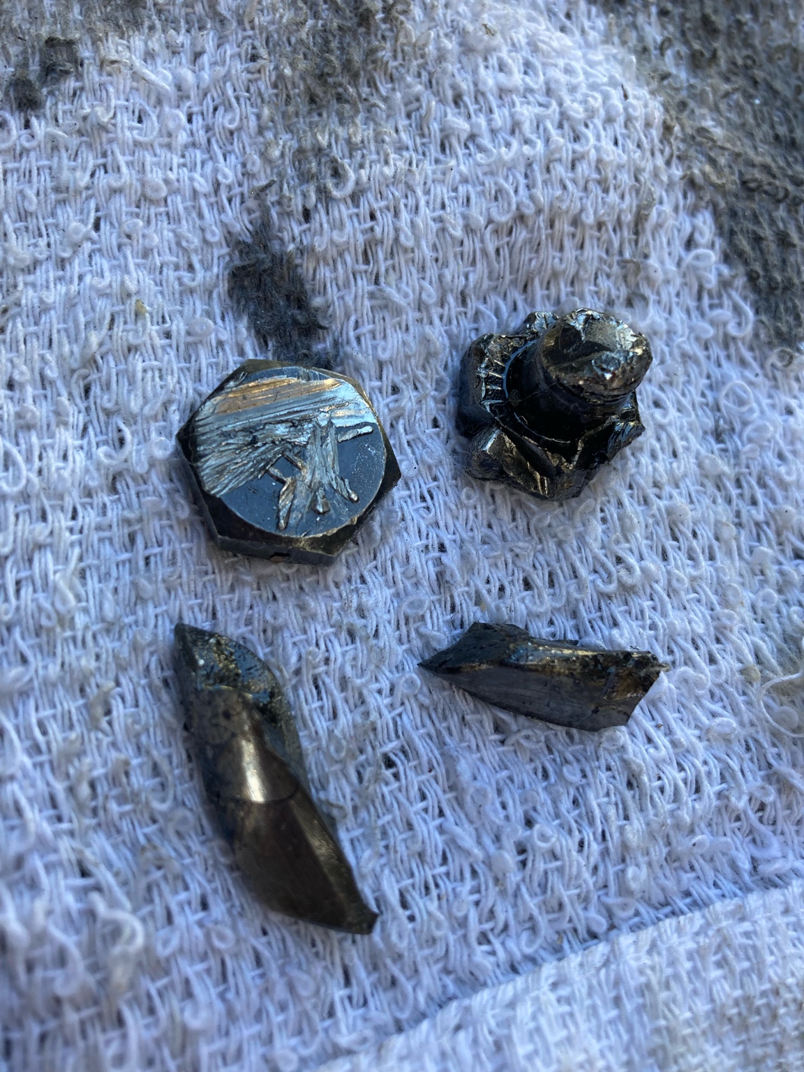

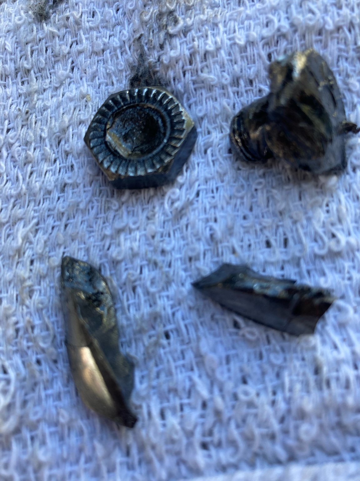

Well. Seems some bolt broke and then messed up a couple pinion teeth.
Any idea what bolt could have broken ?
I’m guessing putting force against the carrier when turning right made this teeth really chatter at driveline rotation speed. Whilst turning left force was against the opposite side hence no noise ?

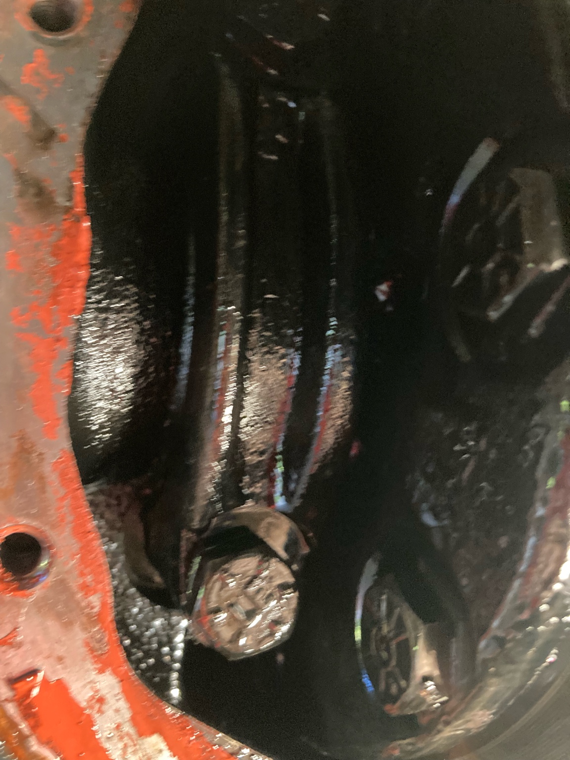

I’m guessing it might be two bolts that hold the ring gear on the carrier. The bolts in this picture show two of them that look just like the sheared ones I posted
