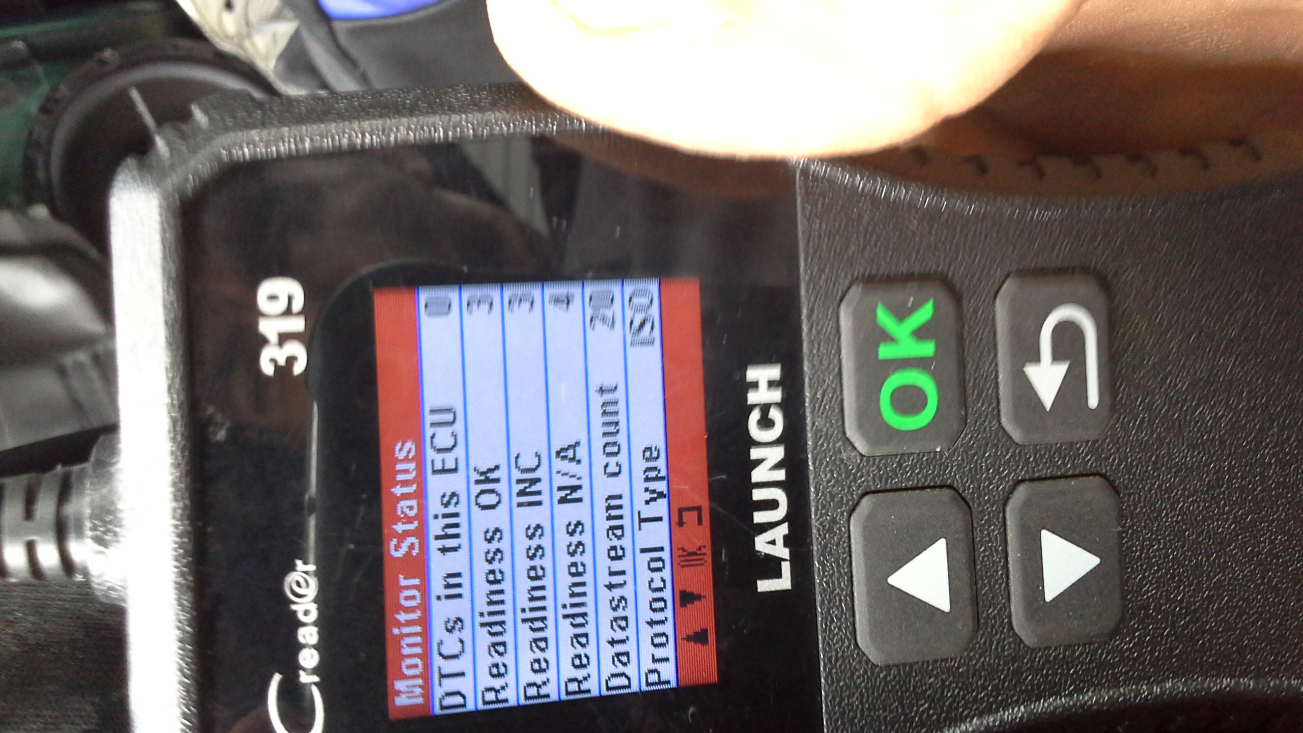

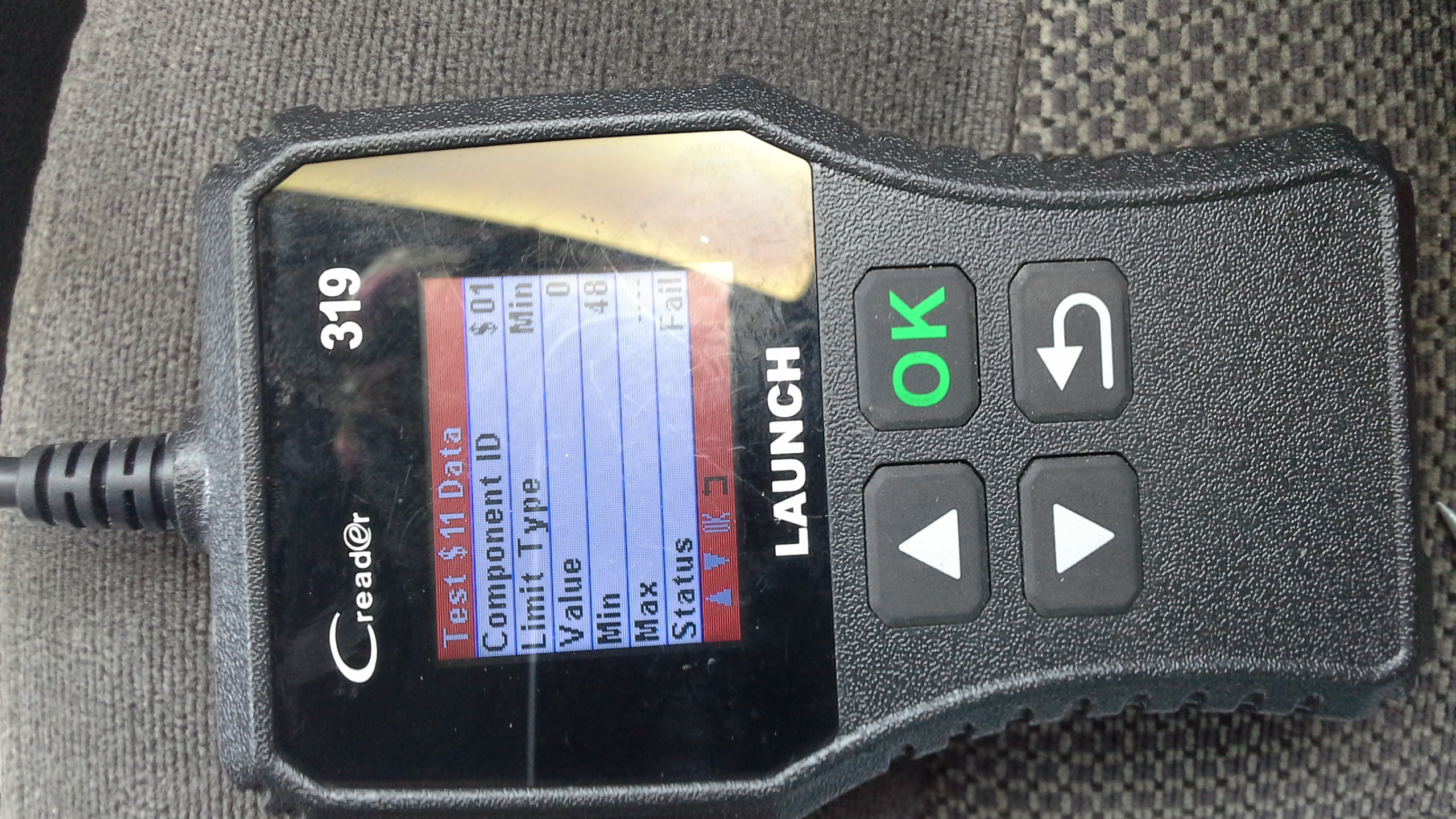

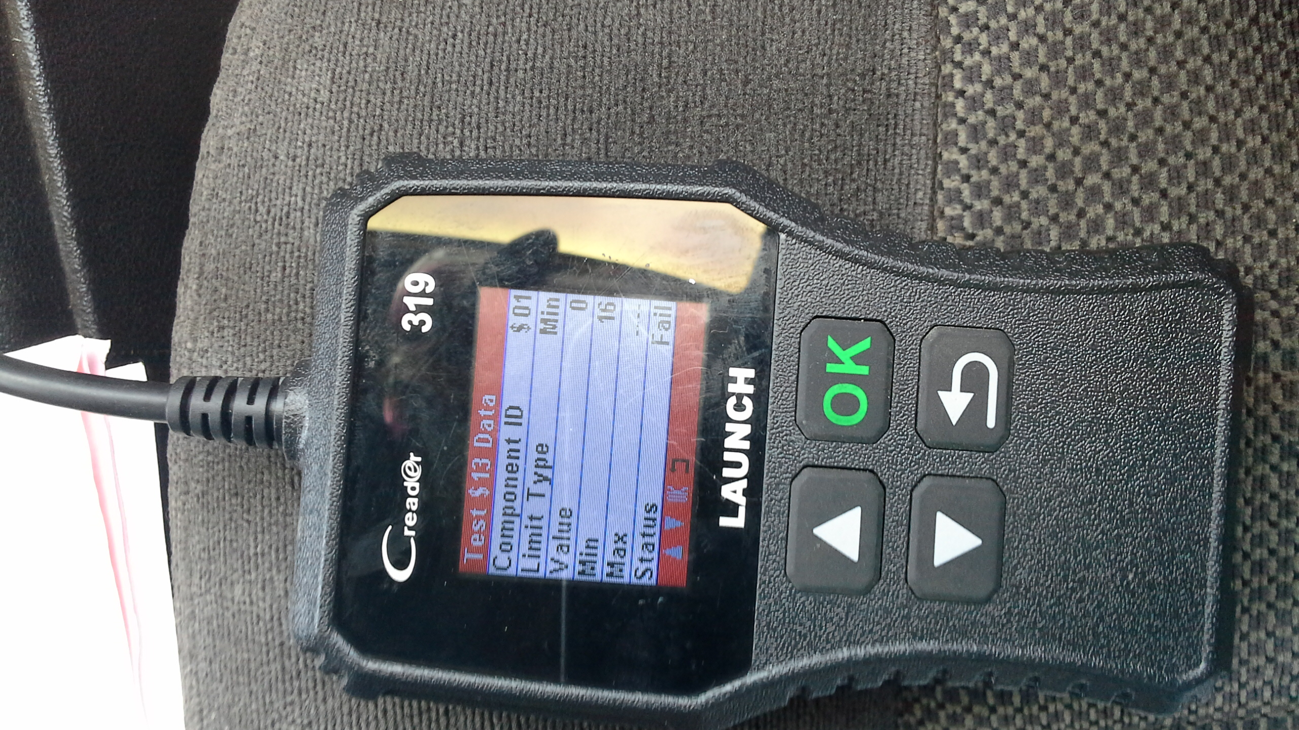

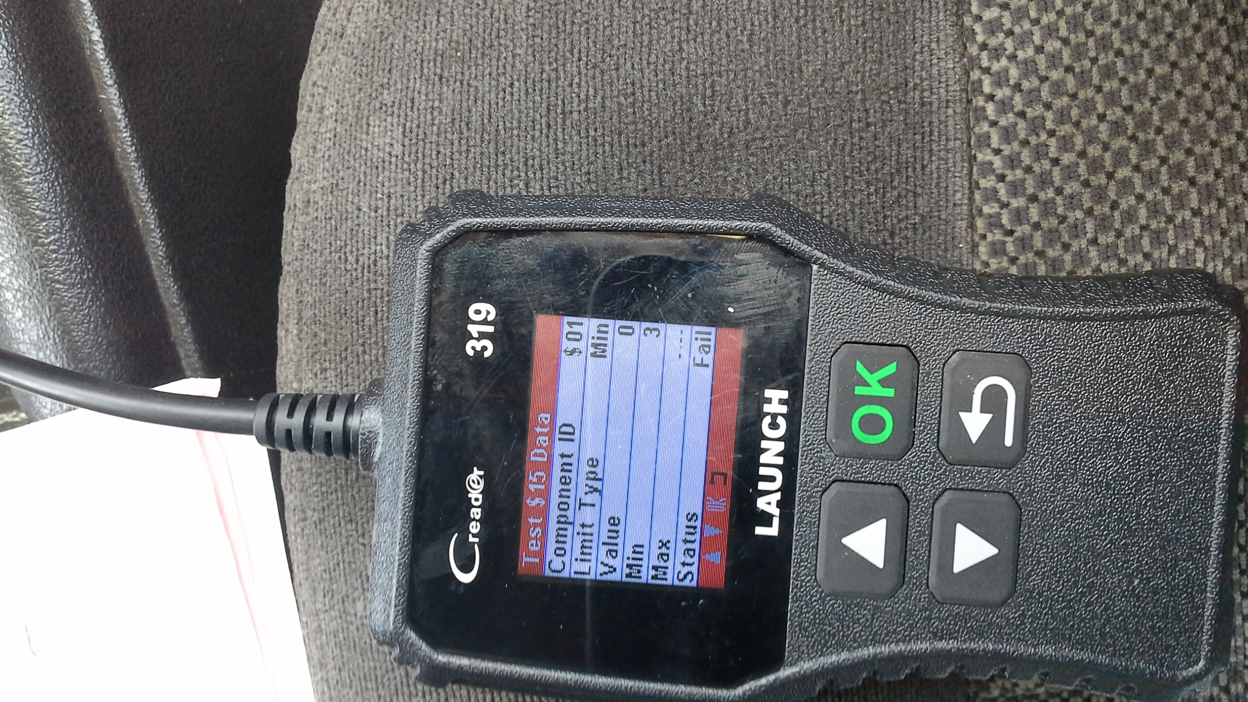

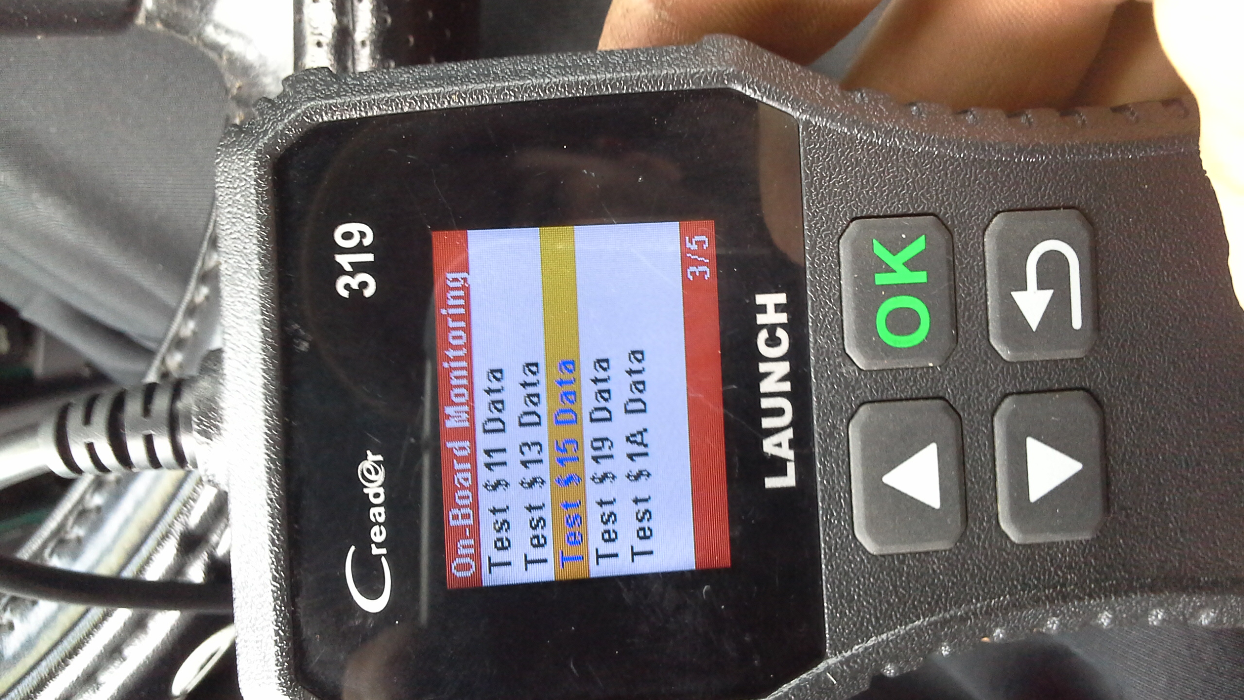

I was driving one day to oic the wife up at work when jeepie decided to act up ......she started to spit and spudder than she backfired amd shut off all happend within 50 yards....so i tried to fire her back up and she said f*** you not today....so i bought parts.....lol i know what a idiot.....parts list....crankshaft position sensor camshaft position sensor distrubator cap and rotor plugs and wires and a ignition coil o plus a fuel pump and filter and she still wont start also my scanner told me this today pics below
