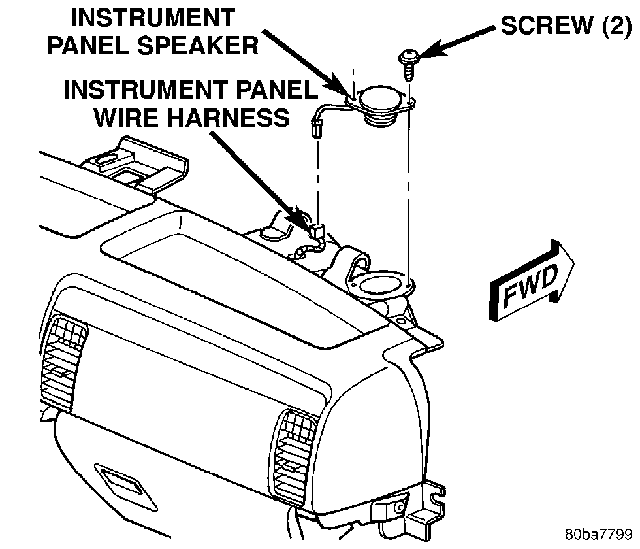

I've got some new tweeters to install, the haynes manual just says to remove the cowl with no other information. I'm not even sure if they mean the part the tweets are mounted to or the metal body part in front of the windshield. I know these blow like bubble gum, anyone removed them or have clearer instructions?

INSTRUMENT PANEL SPEAKER
  1. Disconnect and isolate the battery negative cable.
  2. Remove the top cover from the instrument panel. Refer to Instrument Panel Top Cover in the Removal and Installation section of Instrument Panel Systems for the procedures.
  3. Disconnect the instrument panel wire harness connector from the speaker wire harness connector Remove the two screws that secure the speaker to the top of the instrument panel.
  4. Remove the speaker from the top of instrument panel.

I almost hate to ask, because you are so kind to post instructions for me for my every question, but do you have instructions for getting the Instrument Panel Top Cover off?Feels like a snap in and no screws I can see, but whenever I pry something it breaks. Plastic hates me. TIA.
Pull the driver and passenger side A- pillar off. Start from either the driver or passenger side top I/P cover. Gently pry untill each one of the metal retaining tabs across pops off, Gently pull away from the instrument panel and wala!.
