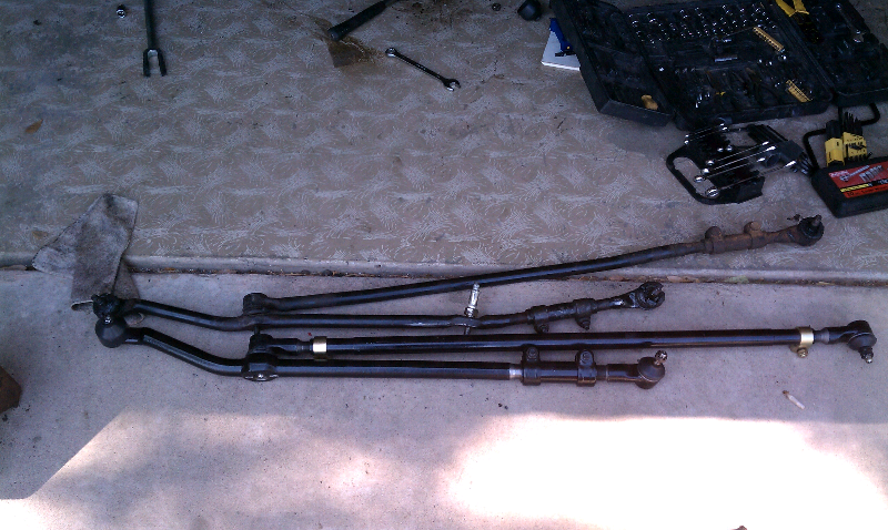

Job done. Soaked it in wd40 all night. Banged on it some more and popped off and the puller pinballed around the garage. It was really on there. Anyway here is the stubborn part. Looks really bent and mangled. The bottom one is the new setup from curry
WD40 is not a very good penetrating oil, try PB Blaster.
In the future, grab a 3lb sledge and hit the side of the pitman arm hole where the TRE goes through, at a 90º angle to the TRE. This temporarily egg-shapes the hole and the tapered TRE will pop right out. Works great on anything tapered like balljoints as well.
You are the second one I have heard that from. Unfortunately the second one since done. I will keep in mind for the future. Thanks for the info.
