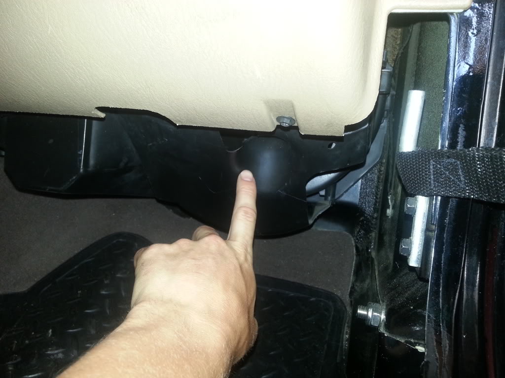

Got in the tj to come to work and the AC blower blows in low in every position except for high. Is there a relay or something that might be out? 2001 4.0 5 speed. Thanks in advance!
The blower motor resistor has gone bad
Its on the passenger side in the air box
Sent from my Galaxy Tab
Thanks brother. I'll check that this evening. Right now it doesn't matter but this fall I might want to turn it down a little.
Yes , check wiring ! I had a corroded blower motor resister and blower motor switch with loose terminals cause excessive resistance and meltdown to wiring bundled with A/C thermostat cause havoc in my '92 XJ . I absolutely agree , check wiring !
