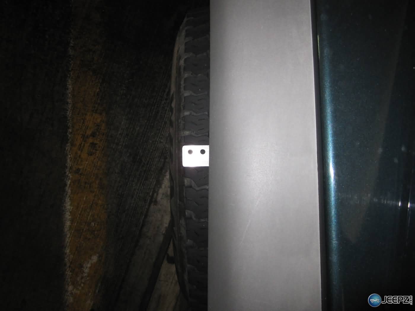

The easiest way to do this is to have your jeep on the ground, and install the new adjustable trackbar on one end (the frame end), and leave the axle end unhooked. The look at how far each tire is sticking out past the fender flare, like this:
