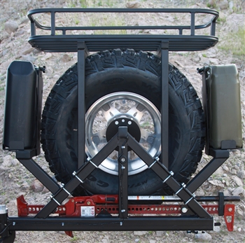

I would avoid a roof rack if possible, and maybe go with a rack above the spare tire. Rock Hard makes a nice unit that integrates with their spare tire rack.

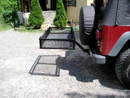

That explorer roof rack looks nice. For about the same money you can also get a carrier that will hook into your tow hitch. They are cheap and available all over the place

i have one of those. i use it alot. really easy to plug in and go. i have a front mount hitch though (and a rear, of course) where i normally use it.

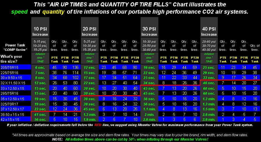

As stated, the reason for the air tank is to air up. That little air tank also allows you to use air tools. Also, compare the air up times of the little cheap compressors with these (taken from powertank.com):
For a Jeep with 35's or smaller, you usually would run the 10lbs one (15 pounds for the larger tires or if you plan on using air tools). Of course, ideally you would run a compressor with an on board tank, but those typically store less air, and require the engine to be running to be any good. I have an electrical compressor on board (ARB high flow one - not the dual compressor one but the single one), and it takes me a while to air up my 33's!
