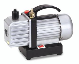

Look for oily spots like the front clutch area of the compressor and all fittings. Once you find the leak and fix it, then you will need a deep vane vacuum pump and a set of manifold guages to do the work(whether you convert or not).
Autozone in my town has both for use under the tool loan program. You just leave a deposit and get you money back when you return the tools.

3. Hook up the vacuum pump with the guages and pull a deep vauum on the system. This removes moisture and test your repair and overall system for leaks. You should be able to get nearly 30 inches of vacuum within the first few minutes of the pull, if you don't , there is a leak. After you get a good reading, let the pump work for about 30-45 min. Then shut it off, and watch the guages for any vacuum drops, this also indicates air leaking into the system.

A vacuum pump is a special tool that along with a good set of guages allows you to evacuate the system of air and check for leaks after a repair. If you don't investigate the leak first and just rely on the leak stop, you may get away with it, but I would recommend find the leak if possible and fixing it.
