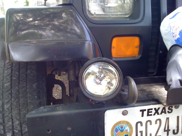

here is the original 35w after burner light

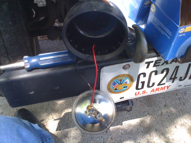

here is how its attached

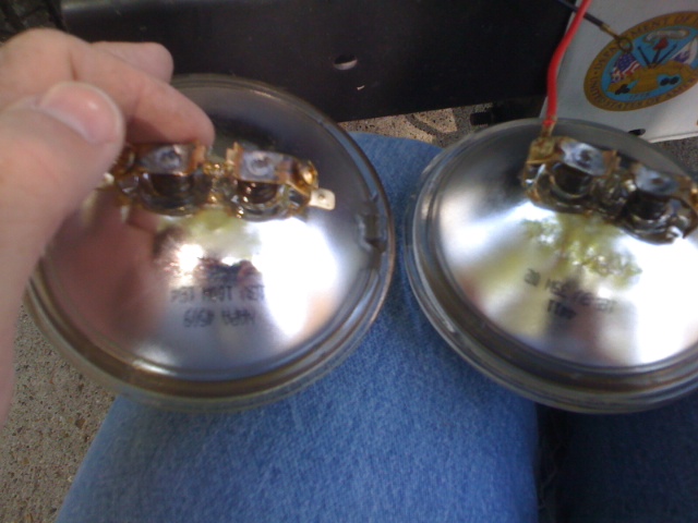

the old bulb was 4411
here is the two lights next to each other, see how easy this is

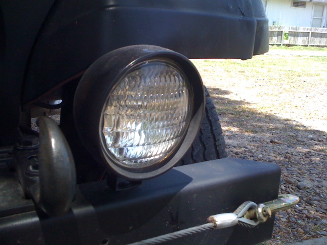

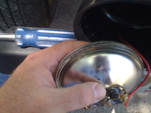

here is the new 100w fog light, it puts out a pencil style beam instead of a flood style light
and these suckers are bright, i tried them out, just to see if they would show anything during the day, and htey lit up the tree trunk across the yard at noon so they are bright

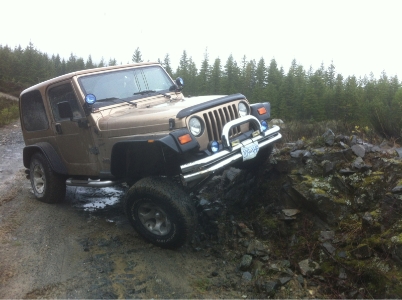

I run something similar, mine are still floods, but the are 55w, they draw 4 amps per bulb. My fog lights are on the stock wiring with an up graded relay, I plan to switch my windshield lights to spots like you have. I also have to for back up lights. Theses are the same lights we run for back up lights on our logging trucks, but I switched my lower ones to the spots.

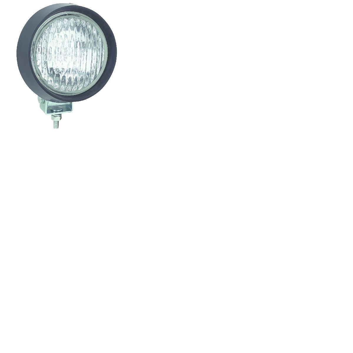

the housings are at harbor freight (with 55w bulbs in them) for 8 bucks each.
12 Volt Halogen Vehicle Work Light
Chicago Electric - item#93904
