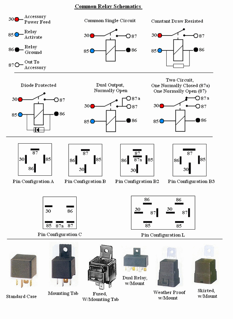

OK, wait a second; you are running the fan DIRECTLY from the switch? No relays? No wonder it was smoking... You need to use the switch to run a relay; switches are not meant to handle that kind of load. You will have an electrical wire under the dash if you keep your current setup!
Also, once you install the relays, keep in mind that the low speed may be fine with a 30A relay, but you will need a larger one (more than 40A; the fan can pull upwards of 70A when it starts running, reducing as the fan picks up speed, and settling to around 35A). Also, small fuses will not work; you will need Maxi Fuses to run 40A loads. Wiring is also a factor; you need to run larger gauge wires to handle all that current so you don't melt your cables out in the middle of nowhere when wheeling. TRUST ME ON THIS ONE; THAT IS NOT FUN!!! Don't ask how I know!

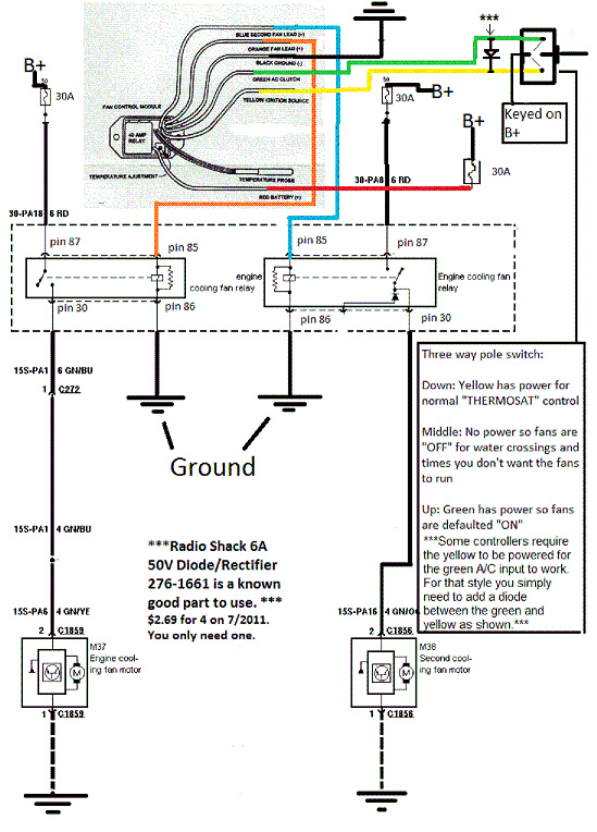

When I wired up my fans (Merc Mystique) I wired each fan independantly referring to this (and other) diagrams;
Testing with an override incorporated in this setup and they're working fine with 40 amp relays. Over the past year I've been review various diagrams and this one made the most sense to me. (A lift of the lynch lid to Mike Coiz for the diagram)

Well, you don't ABSOLUTELY need a relay... You just need one if you don't like your dash to catch on fire.
Circuit breakers would replace the fuses, not the relays.
I am by no means an expert, but as far as I understand, here is how it works:
1. You DO NOT want high amps in the dash, as you run the risk of an electrical fire INSIDE the Jeep (fire is never good, but INSIDE is even worse!).
2. Since you only handle small loads inside the Jeep (especially in the dash), you run your switches with small amps and small fuses (say 2A).
3. Your switches will signal the relay, which in turn makes the high load connection (in this case, 40A). So basically, your switch is a small load that activates a high load switch (the relay) further down the line.
Another thing I just read is your ground; make sure the ground is good. If your ground is not working at 100%, you can create more electrical load unnecessarily (or at least, I have been told so).
I suggest you take a look at the circuit posted above; it seems to have been thought out pretty well.
That's pretty much how mine is wired up; of course, now my DC Controller failed (for some reason it is not turning on), so I now have to replace it (already have the Flex-a-Lite one sitting in my garage for that purpose). Truly functional to wire it up like that.

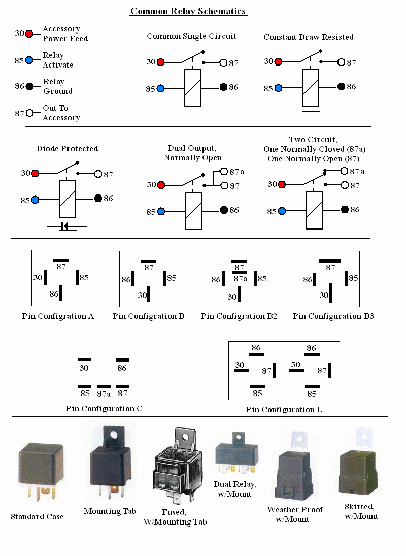

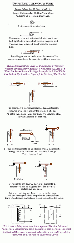

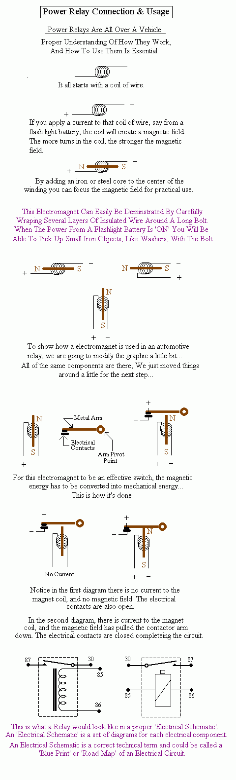

...and from the good book of JeepHammer;
RELAYS are used when you want to keep the wiring sizes reasonable.
There is no sense in running a highly loaded, 'HOT' 10 Ga. wire through the firewall,
Through a switch that isn't rated for anywhere near the amperage a 10 Ga. wire will conduct,
Then back out the firewall 'Hot' to what ever load might be on the other end.
When the switch is 'ON' the wire is hot both directions, and we all know what happens to wires stuck through holes in the fire wall...
Even if you use a 'Grommet' in the fire wall hole,
Eventually vibration and the weight of the wire will cut through the Grommet and then the wire insulation, and you have a MASSIVE short circuit!
(Excellent time to have a properly sized fuse or fusible link in the correct place!)
A RELAY lets you leave the Large Wires out in the engine bay,
Keep the short so they don't build a lot of resistance in the circuit,
And they keep you MUCH safer by NOT having them running in and out of the firewall,
Plus, a Relay can handle many times what a 'Switch' on the dash can, do it safely, and do it for YEARS without issues.
These quotes are from another forum but I'd rather not post link as I've been called on this before

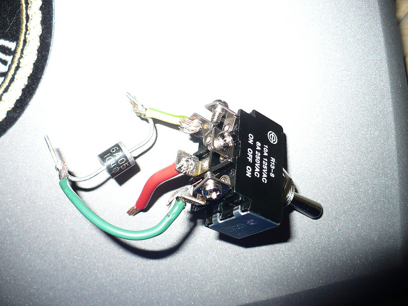

Actually 69jeepcj, you can use a double pole double throw switch (DPDT), to cut the clutter on the limited space we have on our dash panels. 8783388303_5ea2783816_c.jpg I got this one from Rat Shack and as I'm running the Merc Mystique/Ford Contour double fan setup the low speed is controlled by the resistor on the fan shroud itself. Therefore I wired each fan with the little controllers I got from NAPA 8672609847_2b5903c4c6_b.jpg and as far as the switch goes, one hot pole goes to this controller for thermostat control and the other pole of the switch is an Override On circuit. In this setup then while dual contollers and dual relays are being used only one DPDT switch is needed.
I hope this helps, initially I was mysitfied myslef by this fan upgrade.

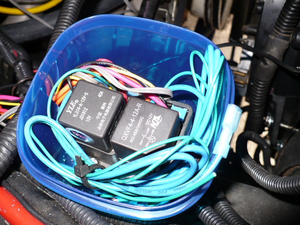

Thanks a lot guys, I went out last night and got a 40A relay to wire into the low side of the fan, (hopefully today). They didn't have any relays over 40A at that store, so I am going to keep looking for a 70A relay for the high side. I am going to look at the diagrams above to try and wire the 40A relay and just use the low side for now until I can get ahold of a 70A. Oh, and yeah I have the two speed, three wire ford Taurus single fan. Could I use the double throw pole switch posted above to run the low and high side of the fan instead of dual fans?? I have the three way switch now on-off-on, for high off low or should I just use two switches? thanks!
