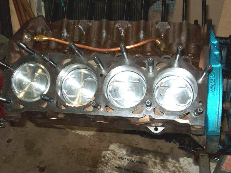

So I recently heard that the amc 360 has problems with the oil pick up or something. Has anyone experienced this or knows what I'm talking about? What did you do or what can I do to fix this problem? If it even exists lol
here a pic find on internet

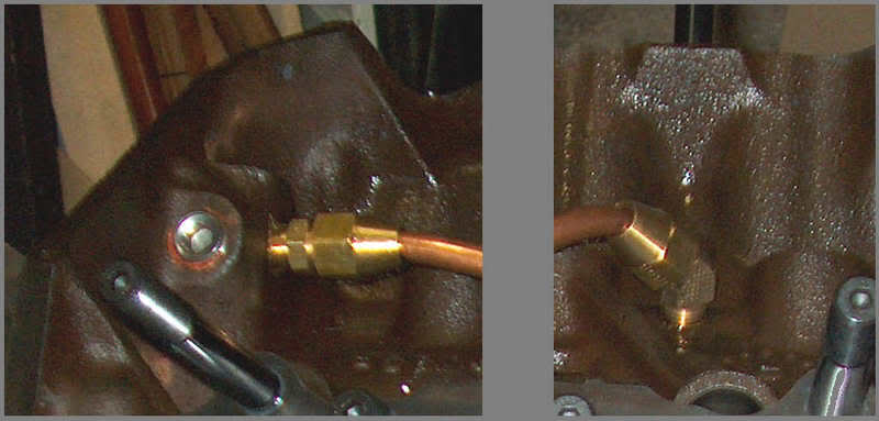

the problem seems to be getting oil to the back of the engine. All AMC v-8's. I learned of this about 10 yrs ago when my 304 developed a tick on the rear passenger side of engine. The cure was too late for me.
yes, it pumps oil to the back of the engine. I havent done it but did read about it after it happend to me. LOL,, I don't know the names of it, but I think they connect that copper tube to one of the hole in the front of the engine that the oil comes through and route it to one of the ones in the back of the engine. They say it is very simple to do. I searched it, this may help more. For the oiling mod, you can spend the $25-45 and get a ready-made kit. You simply drill a hole in the back of the front oil block in the intake valley, and another hole between the #6 and #8 cylinders, so that pressurized oil is shot down onto the rear bearings. This basically increases volume to the rear bearings, should you have a worn bearing elsewhere, it keeps the same amount flowing to the rear.
