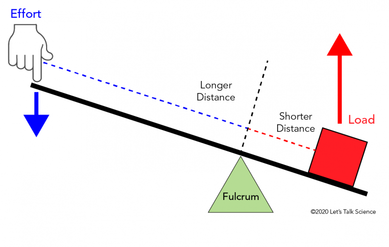

By moving the flucrum outward, the lever bending moment is increased, meaning more stress and strain are placed on the lever. Too much in the case of wheel spacers? Time and usage will tell. Clearly, the running gear (the lever) was not designed for their use, but it might fall within the design safety factor...or might not.
This is true. But if the spacer is making up for the backspacing the wheel does not have. And the tire is in the same location in the wheel well. It is a wash.
