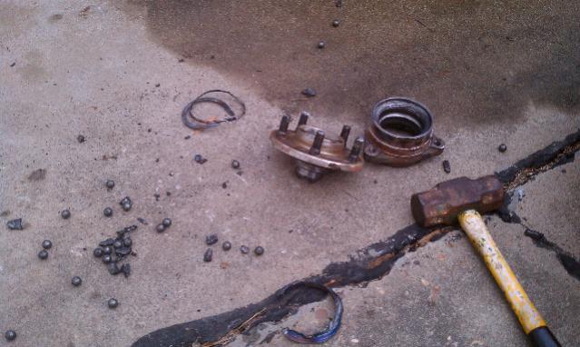

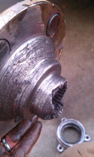

What is the best hub assembly to buy? This gets old quick
i'd invest in a harbor freight side hammer, a wire wheel and some anti seeze.. that will help you a lot, and be less of pain the next time ya need to change either a joint or hub...
