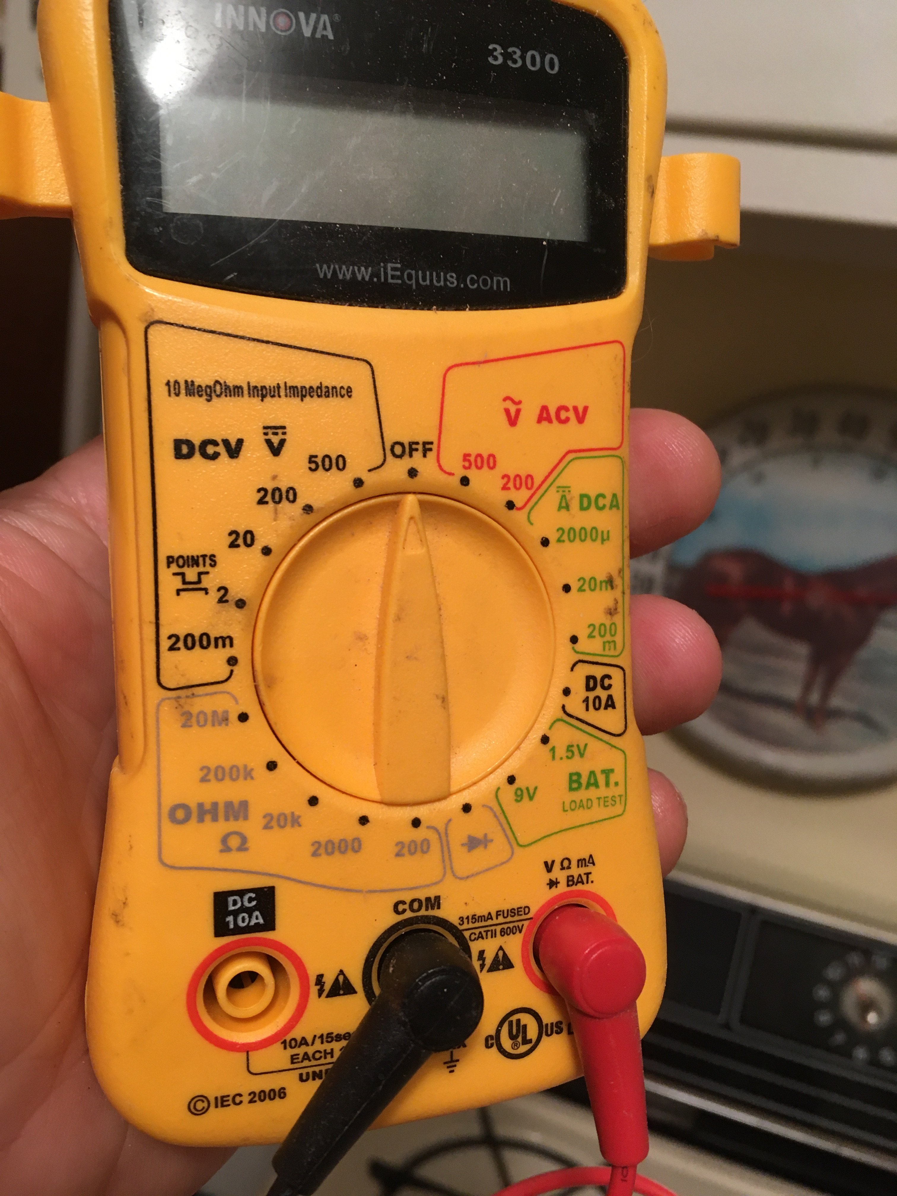

To me, ohm is something you say during a Buddhist meditation. I'm afraid we've just reached the edge of my understanding of how to operate my multimeter. I understand that an ohm is a measure of resistance, but I'm not sure where to set my meter's dial and where to put the probes to measure what. Dial, I'm guessing straight down to the gray 200 mark. I'm assuming testing for Ohms is another way of searching for something like terminal corrosion or a connection compromise somewhere along the line?
