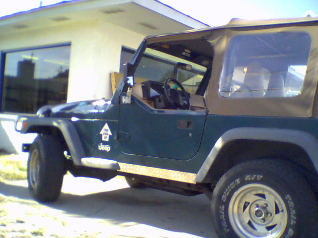

i made my own out of some 1/4" diamond plate. took some scrap, cut it to 8"x30" bent a 90 about 3" up on a brake & used ALOT of 3M vhb tape to mount it. no drilling & it was FREE!!!!!
