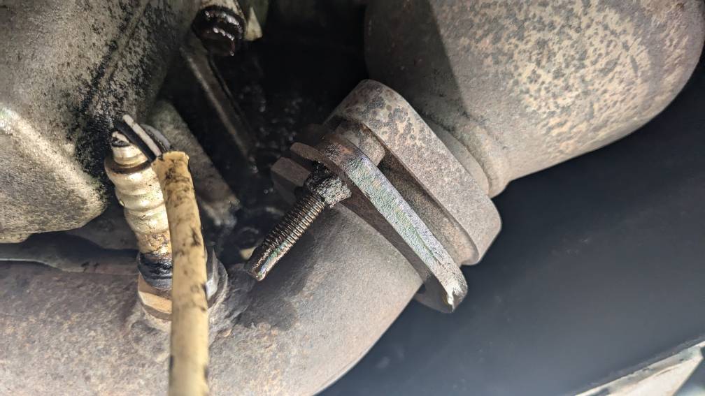

I need to take apart a section of exhaust on my mom's Ford Escape - it's only four nuts, and they don't look too bad. I've been hitting them with PB Blaster for a day or two, and I'm about to the point where I want to take them apart.
I've got a hefty 1/2 inch Dewalt impact that would likely make short work of this, but I was wondering if it's better to start with a standard socket wrench before going straight to the impact? My goal would be to not break the studs off the exhaust.
I've got a torch that I use for plumbing, but it's not something that I often use on the car. I would likely only use this as a last resort.
My current plan of attack is to start with a socket wrench, if needed move to a breaker bar, and finally impact gun.
Are these the bolts for the catalytic convertor? If so, how old is the car?

No, these are on a Y pipe. Only thing that connects into it is an O2 sensor. I need to remove this portion of the pipe in order to drop the oil pan.
Car is a 2009 Ford Escape.

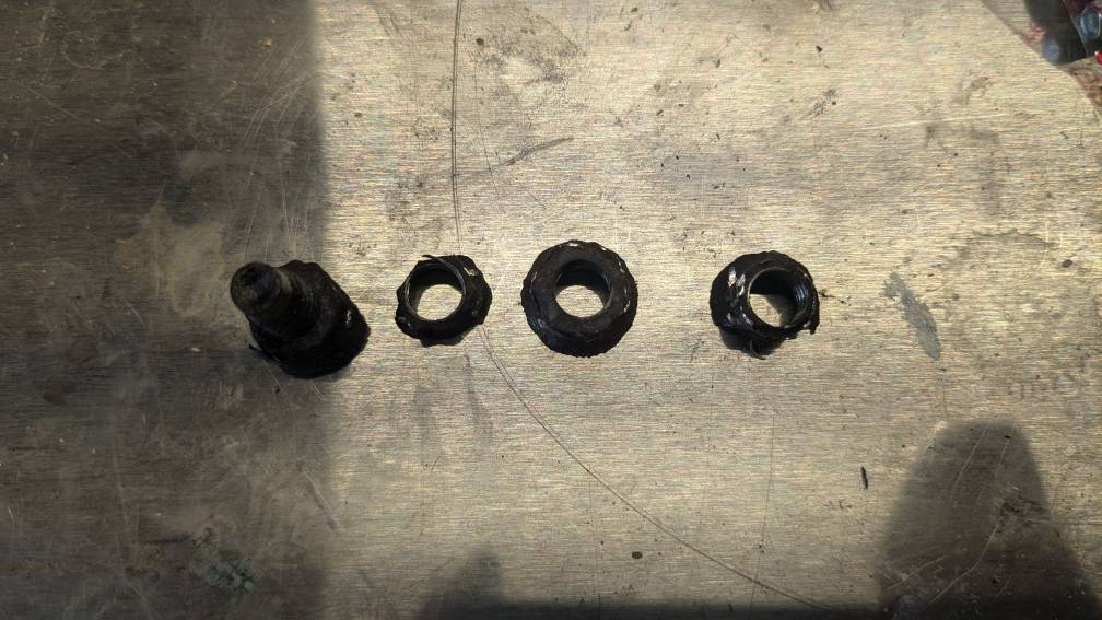

I'm going to say that I had partial success getting these nuts off. Right off the bat. Things were weird because one nut appeared to be a different size than the other. It turns out they were just so rusted that they had disintegrated. When I put my six-point socket on the nut rounded off with light to moderate force on a socket wrench.

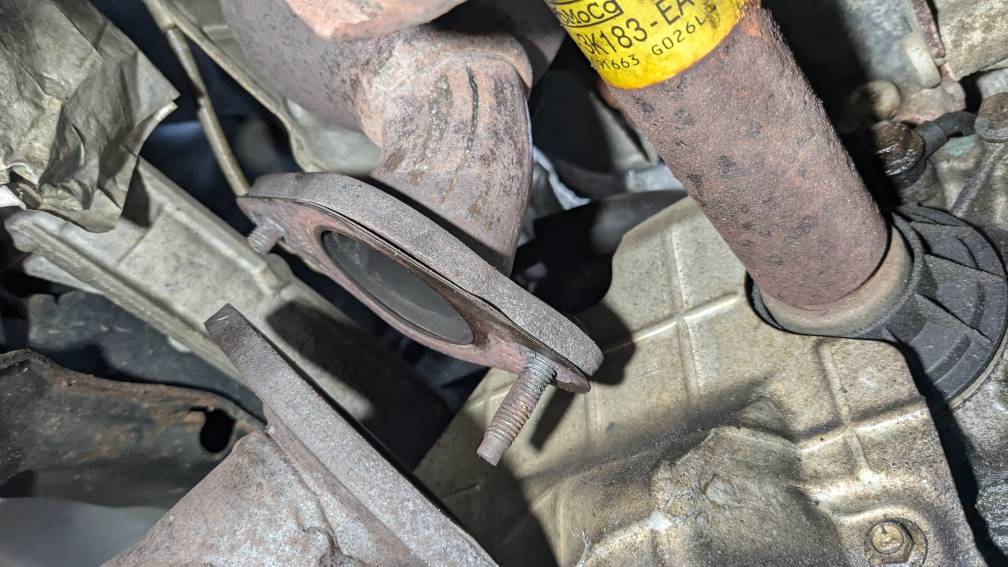

I got into trouble with the fourth and last nut, when the bolt sheared off
Here's what everything look like after I took it off
The exhaust stud that's left behind is of the press-in variety. I bought a map gas torch from home Depot to try to heat it. I sprayed it with PB blaster heated it as hot as I could get it and beat on the stud with an air hammer but it wouldn't budge. I tried this process about four times until I was defeated.
I put it back together for now and it's definitely louder than I'd like. I'm on the fence if I should just pay a local mechanic to fix this broken stud.
Sent from my Pixel 6a using Tapatalk
The stud began to glow a little bit, but not very much. The exhaust flange didn't glow at all.
The youtube videos I've watched have the whole exhaust flange glowing bright red. My plumbers torch from Home Depot couldn't do that.
