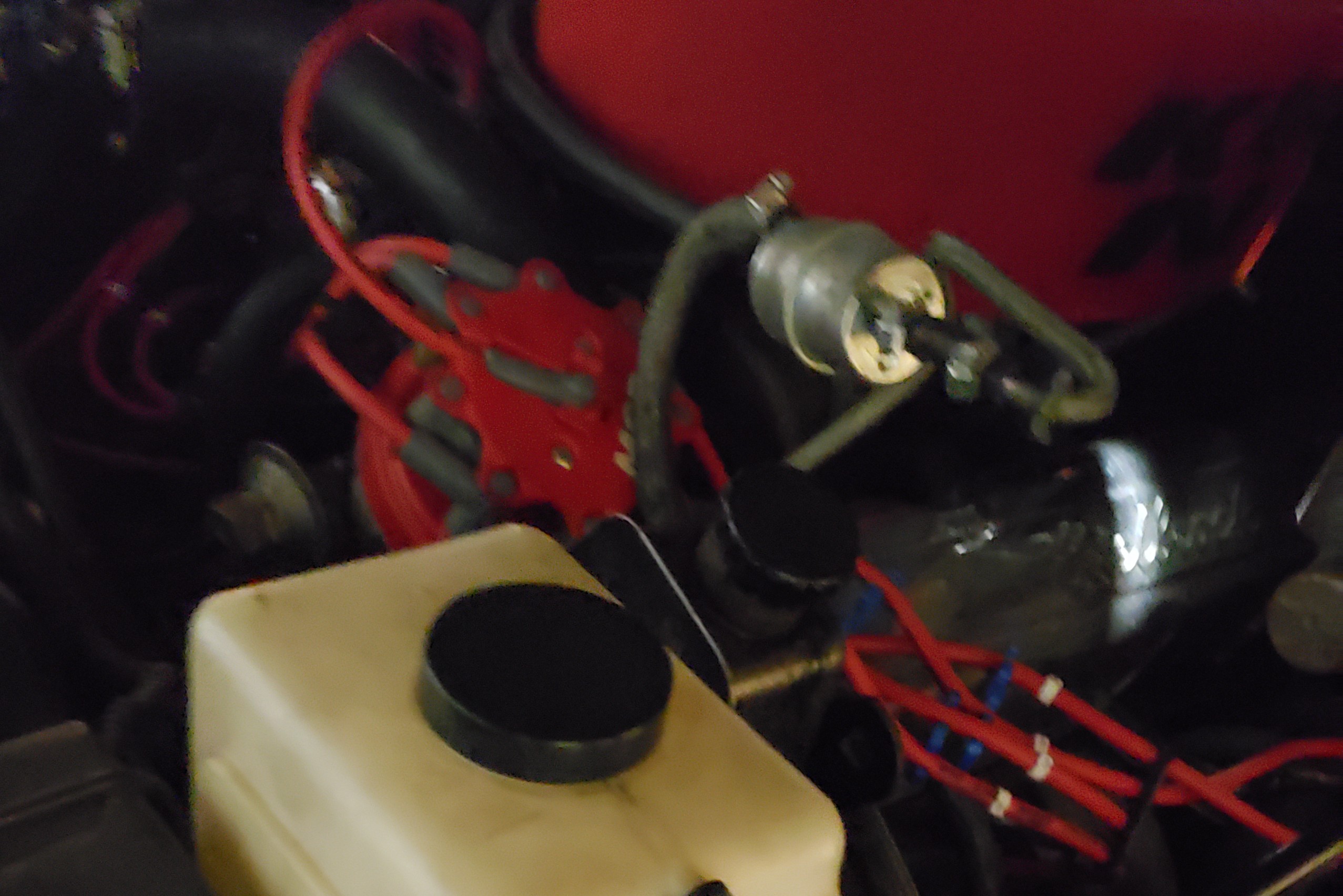

Since the mods necessary for the Team Rush upgrade I've gone as far as I can save for the Ignition MSD Module box and she was running fine until last year. The distributor has not been altered and the starter spins the motor up fine. I've taken the steps in the DARS chart in the official Jeep TSM and I'm at a loss on how to proceed. If there's any electrical gurus here, please chime in. Thanks and a lift of the lynch lid.
