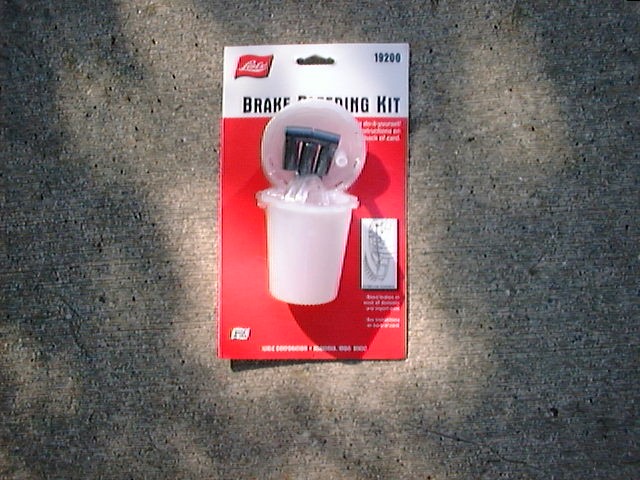

Step 1 - The materials
I managed to find this brake bleeding kit in a local parts store. It is a pretty simple setup that you should be able to make yourself. It has a hose that goes into a jar of brake fluid.

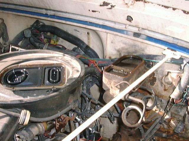

Step 2 - prep the master cylinder
First, take off the master cylinder lid, and top it off with fluid

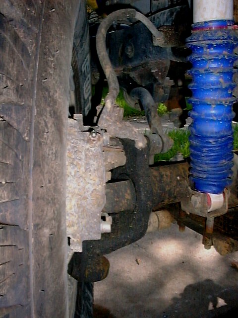

Step 3 - find the bleeder valve
locate the bleeder valve, and loosen it with a wrench.

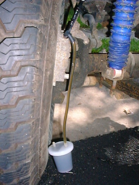

Step 4 - hook up the one man bleeder
Attach a hose to the valve and fully open the valve.

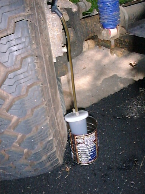

Step 5 - get the air out
I put a coffee can under everything to catch any spilt brake fluid. You pump the brakes until there are no more bubbles visible in the clear tube, then run over and tighten the bleeder valve up again
