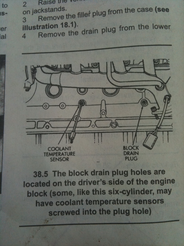

First time draining & flushing the coolant on my LJ. Where in god's name r the damn block drain plugs. I'm told there r 2 and r on the driver side, but I have no idea how to identify them. R they bolts? Can I get some specific directions to the location?
