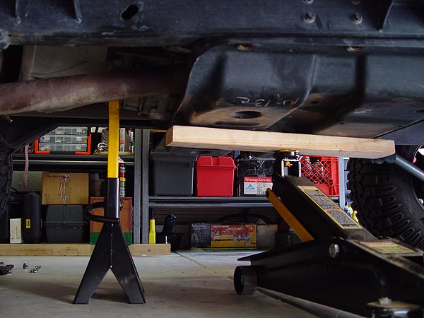

Ok, I hope i didn't screw anything up. Went to take the skid plate that is underneath the transmission 0ff then the hole transmission droped down with the skid plate, it dropped about 4 inches. I jacked it back up into place and figured I better get a how to book or ask for advice before I go any further. I was doing this so as to try and follow the wires that go from the transmission reverse switch to the tail lights to find where my short is, and/or unplug the switch at the transmission to the backup lights to see if it blew a fuse when disconnected. Thus telling me if the switch was bad or it was the wires from the switch to the light. But do I need the transmission supported when I take off the skid plate from underneath it? LOST AGAIN.
YES. Support the transmission and lower the skid plate . You may want to use a hydronic jack to lower the pan cause it is heavier than you think. Plus it makes it easier to bolt it back up.

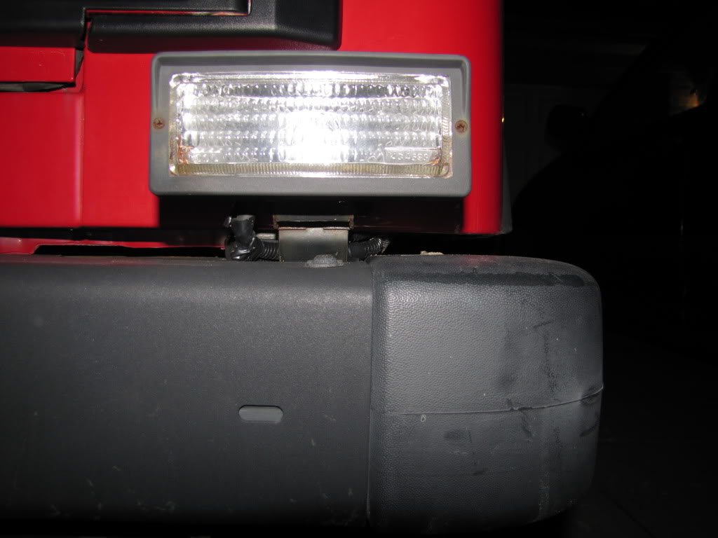

Don't discount the socket itself. I added these and see much better behind the jeep.

Looks like ~¥12421 for the KC HiLiTES 517 2x6 55w Back Up/Flood Light System

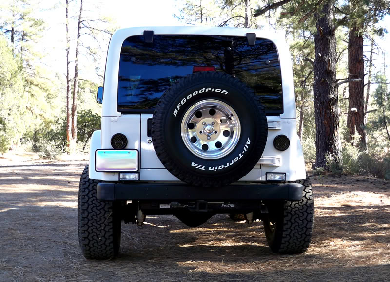

White one isn't mine but has the lights mounted same as mine.
