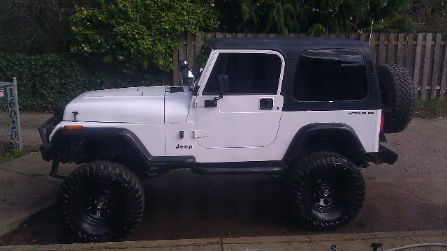

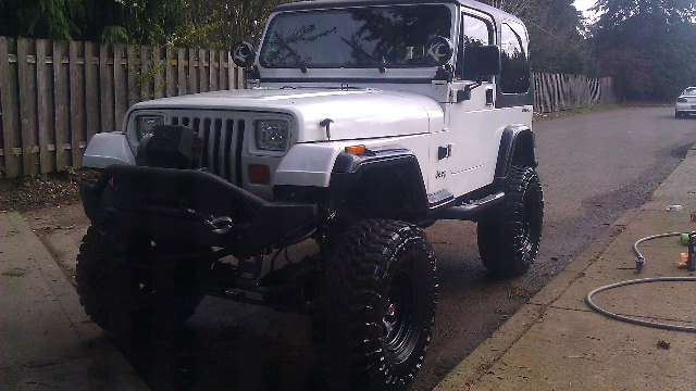

The po installed a body kit on my YJ and I forund I have a bolt and rubber spacer missing from one of my mounts. I've never delt with installing a body kit before and may have an OOPS on my hands. It looks like they installed the body kit onto the stock body bushings (Is this correct/ common?). 2nd If everything is ok with this set up where can I find a replacement bushing? Or 3rd Should I buy a kit that will replace all the bushings given the stock rubber are starting to show wear?

Installing the spacer on top of the stock bushing is the correct way. The body spacers you install are a hard plastic, while the factory mounts are rubber and absorb shock. If you just had hard plastic you'd feel alot more vibration / shock. You can see my body lift write-up here:
http://www.jeepz.com/forum/suspension/35095-body-lift-install-jeep-wrangler.html
I'd stick with what you have, and just make a new spacer (a hockey puck may work), and buy a bold from the local hardware store. I wouldn't worry too much about the cracked mounts, my 2005 has them as well. Just keep a eye on them and replace them when they fall apart.
I would go back and check the torque on all your existing body mounts.
