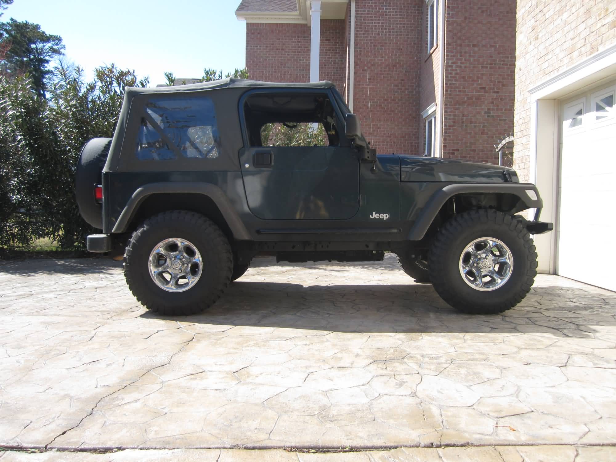

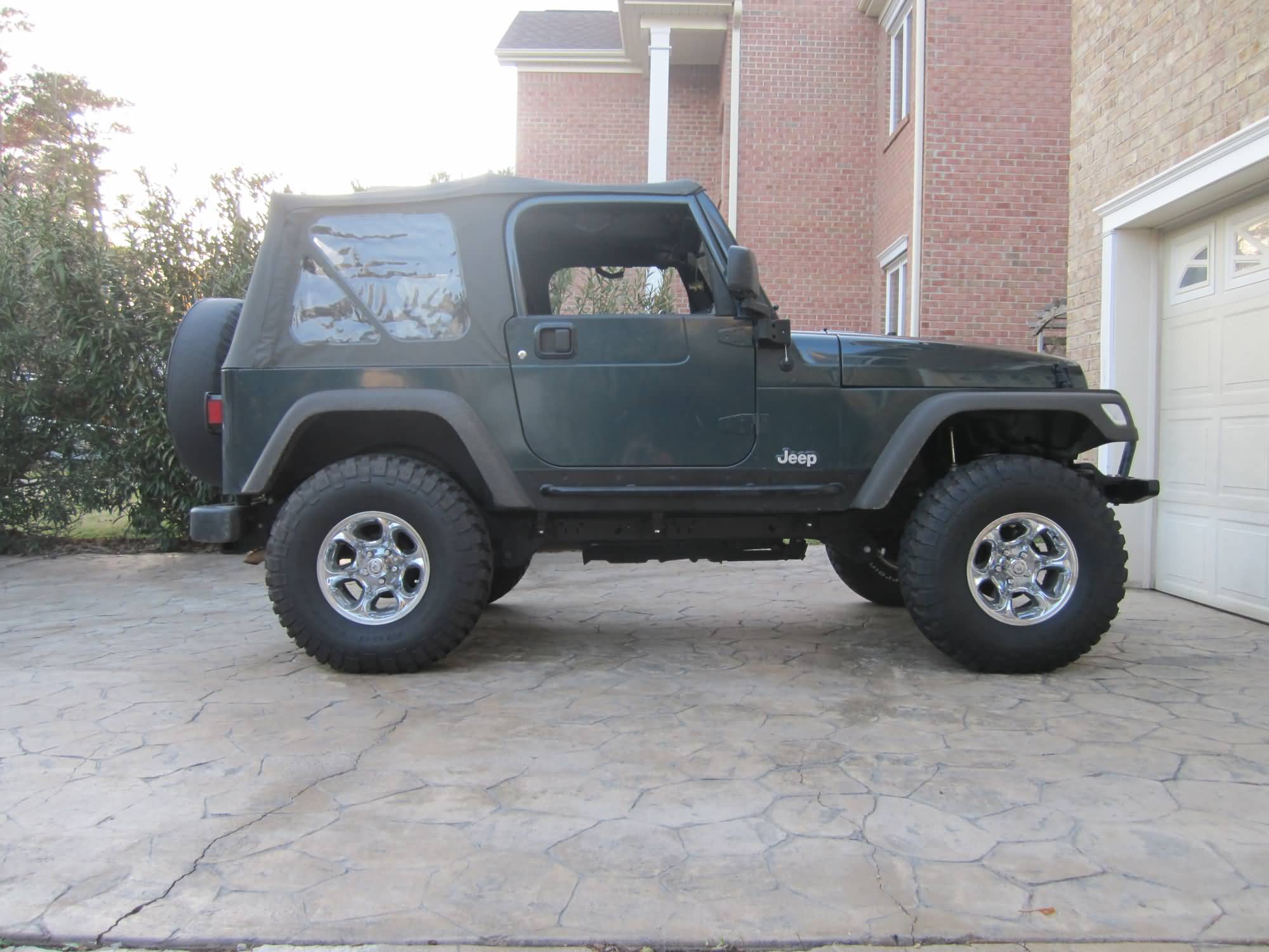

Before:
After:

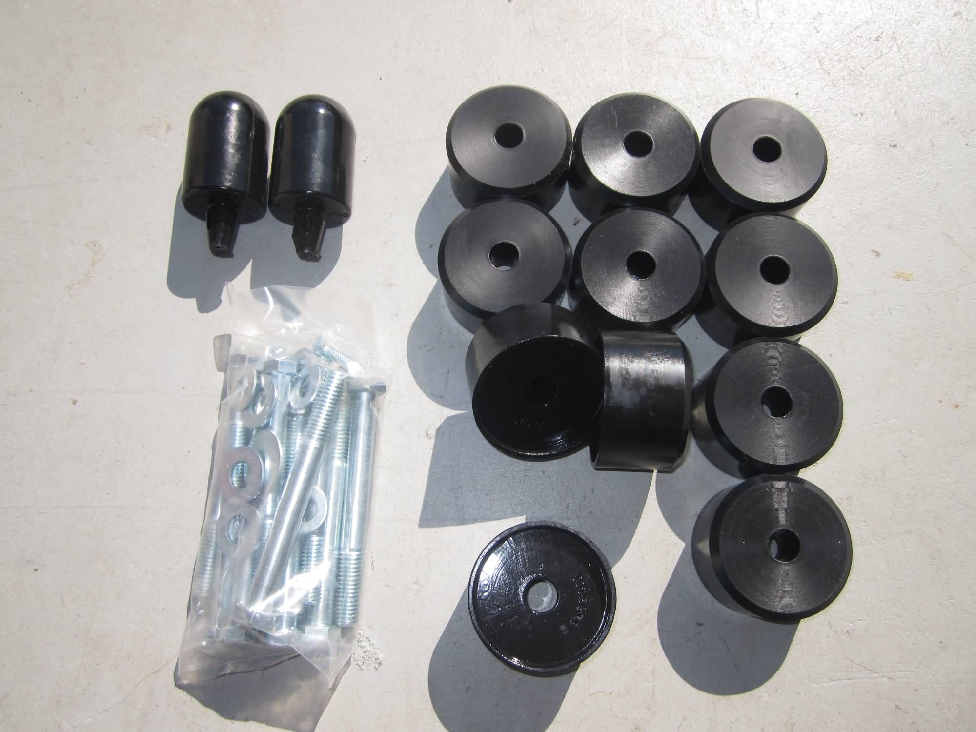

What comes in the box:
I purchased a 1.25" body lift from JKS manufacturing. This included body mounts, hardware, and new bump stops for the radiator.

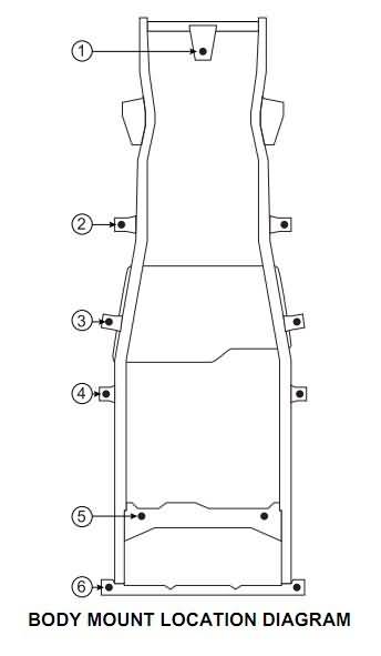

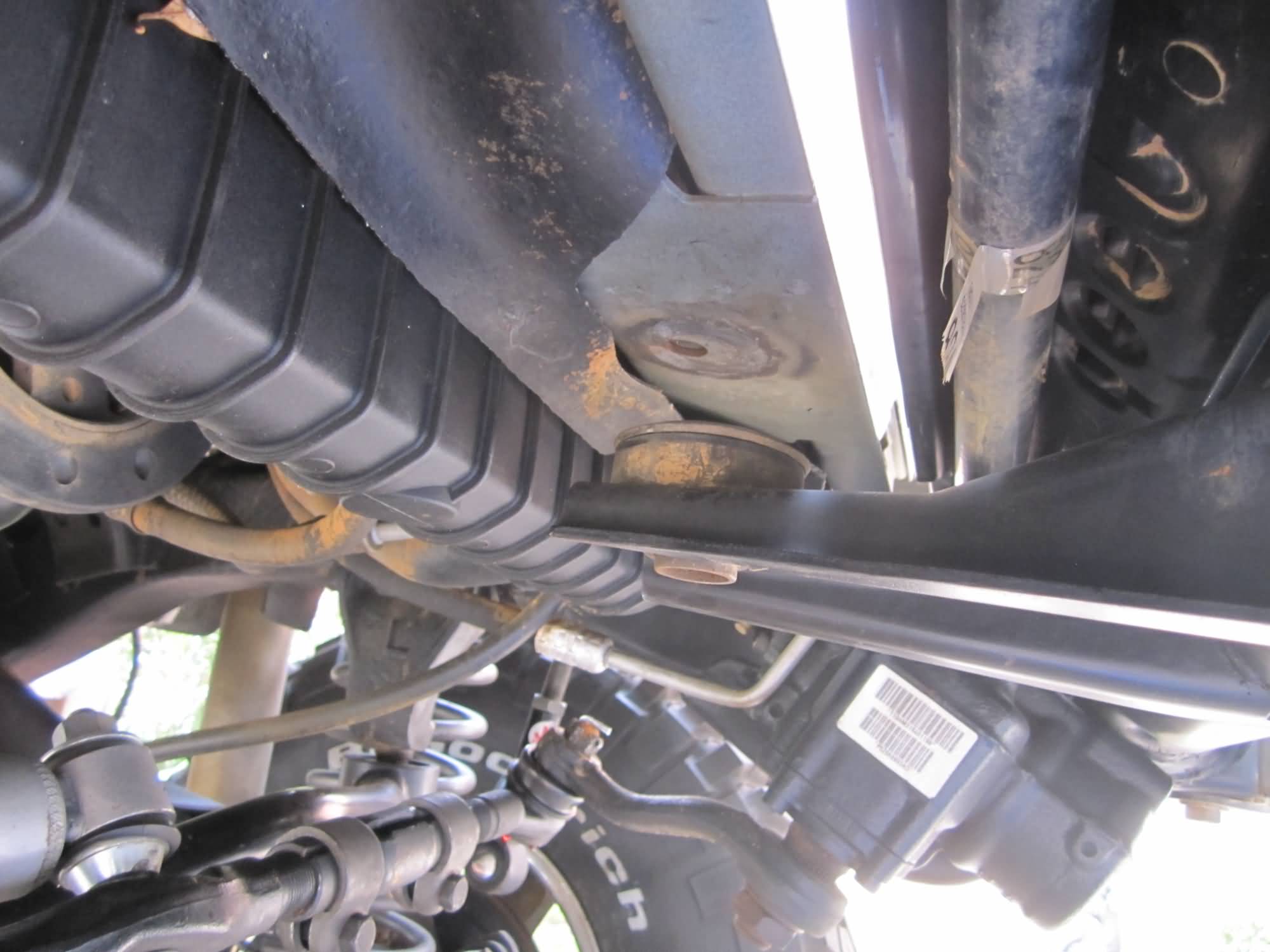

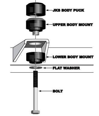

- Removing the body mount bolts - You'll want to work with one side of the Jeep at a time (let's start with the driver side). Remove the bolts from the driver side, and loosen the bolts on the passenger side, but don't remove all of the bolts, you don't want the body sliding around when you jack it up! In the diagram below, you'd remove the bolts from 1-6 while leaving the rest in (but loosened)
- Jack up the driver side of your Jeep slowly, raising it and inch or two up.

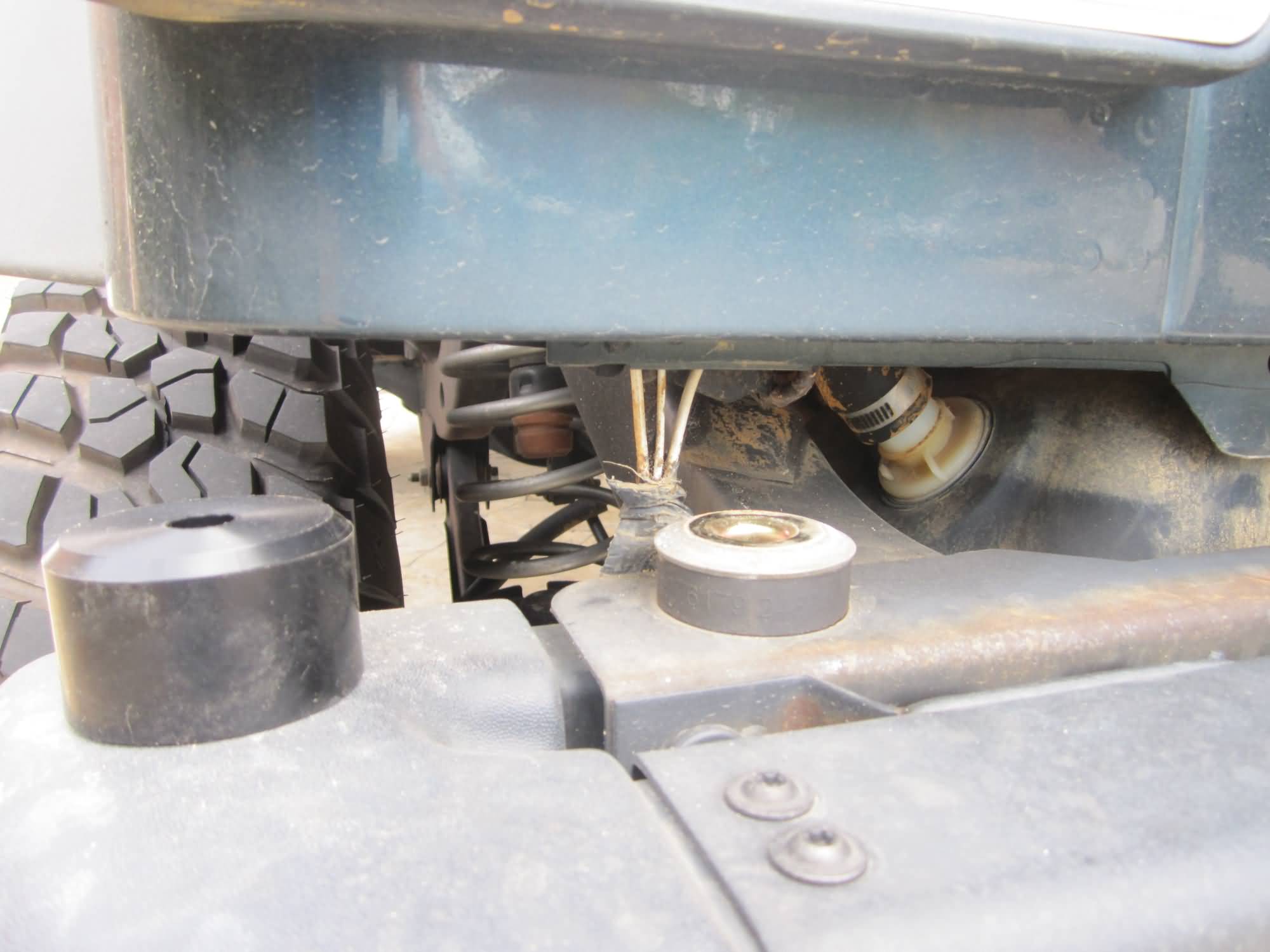

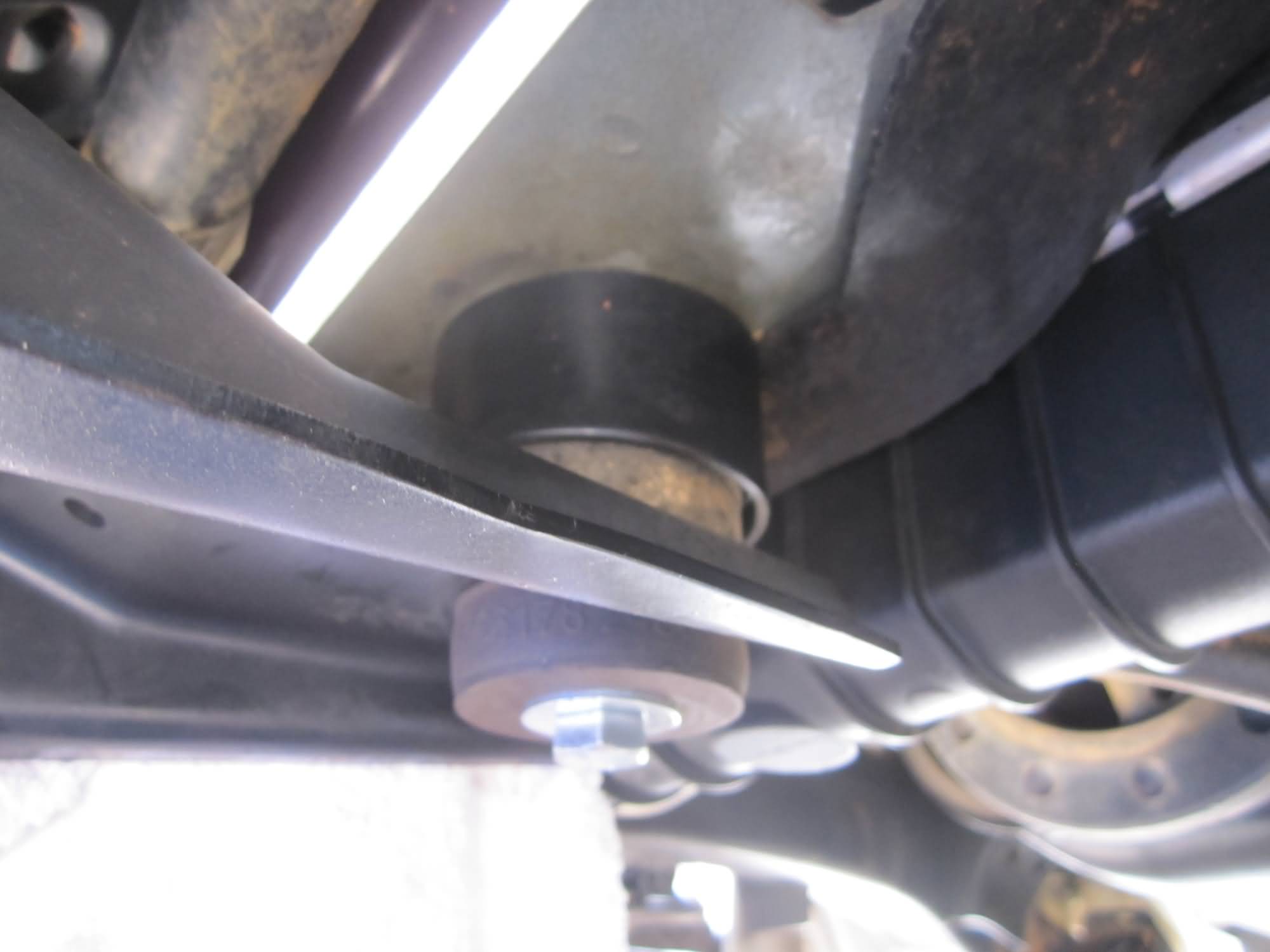

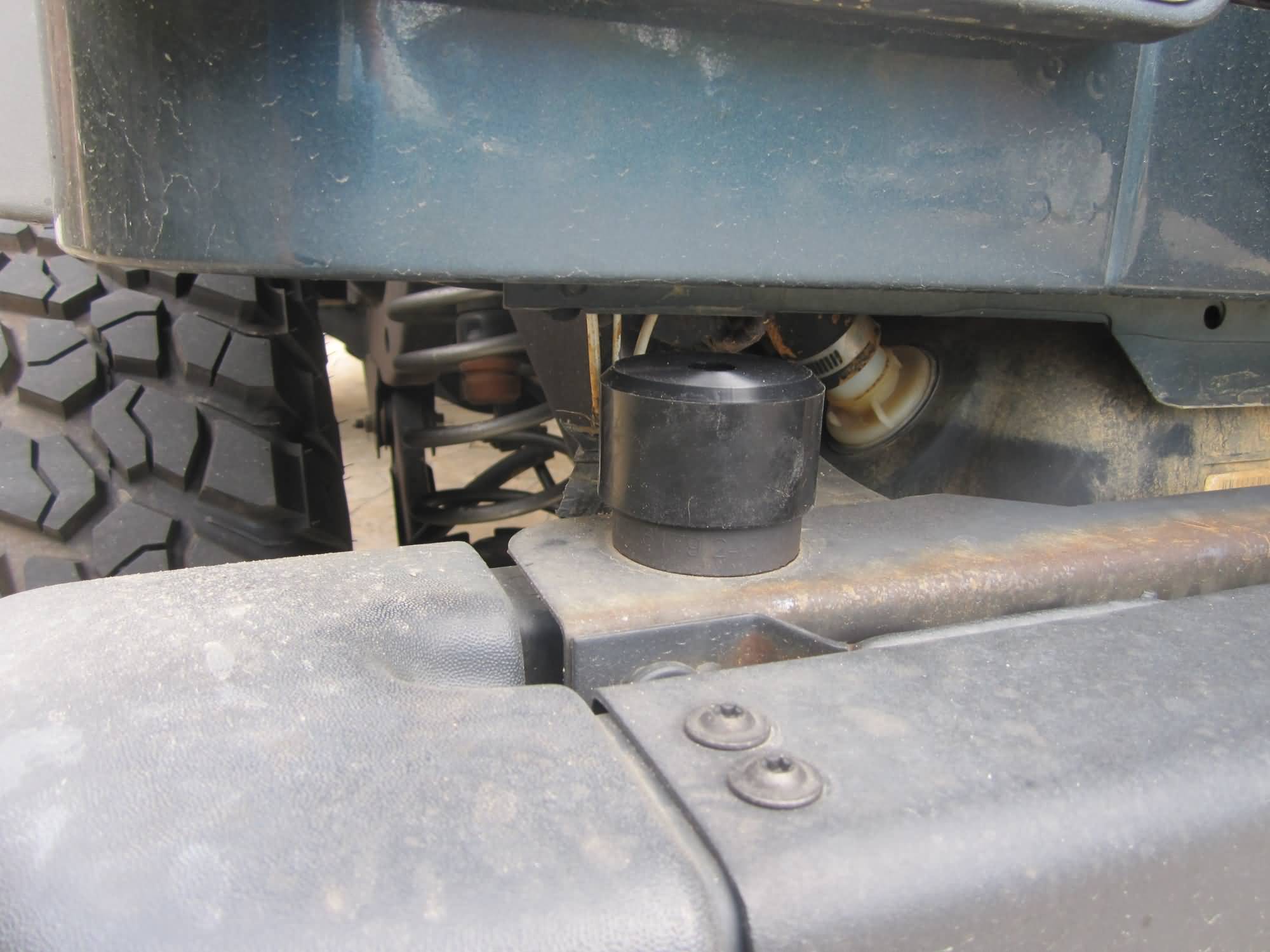

- Now, place the body pucks on top of all mounts on that side.

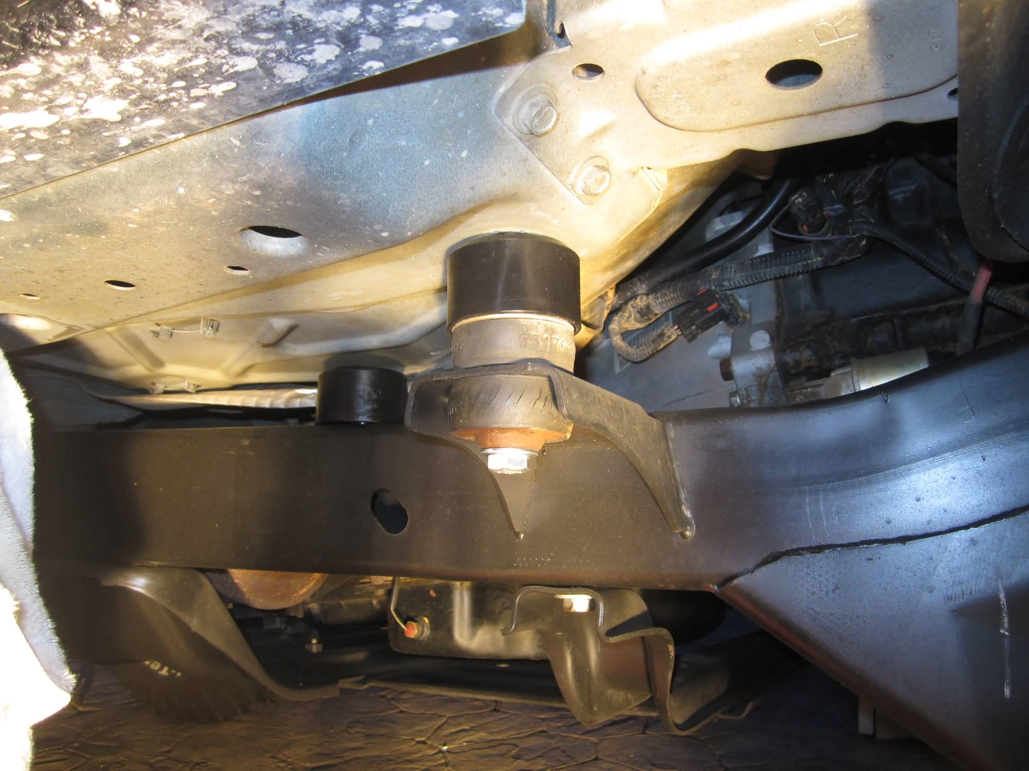

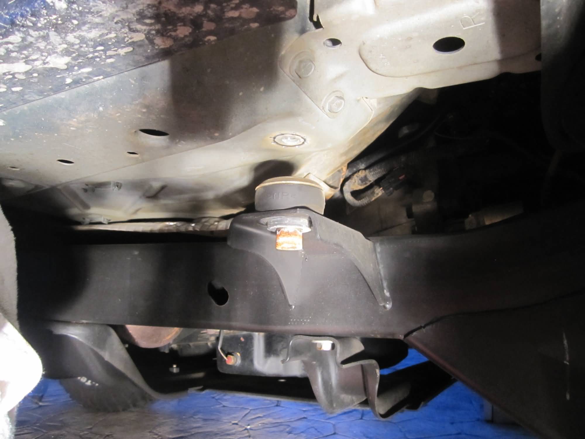

Rear body mount before:
Rear body mount after:
- Once all the body pucks are in place for this side, you'll need to place the bolts back in and finger tighten this side. You may have to jack the side back up and shift the mounts a bit until the holes line up - I found it easiest to get each bolt started, and then move on to the next mount.
- After you've finished the driver side, remove the bolts from the passenger side, jack it up, and insert the mounts and bolts for this side.

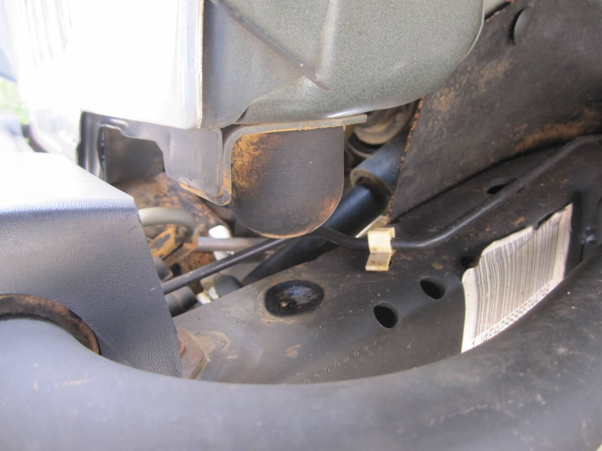

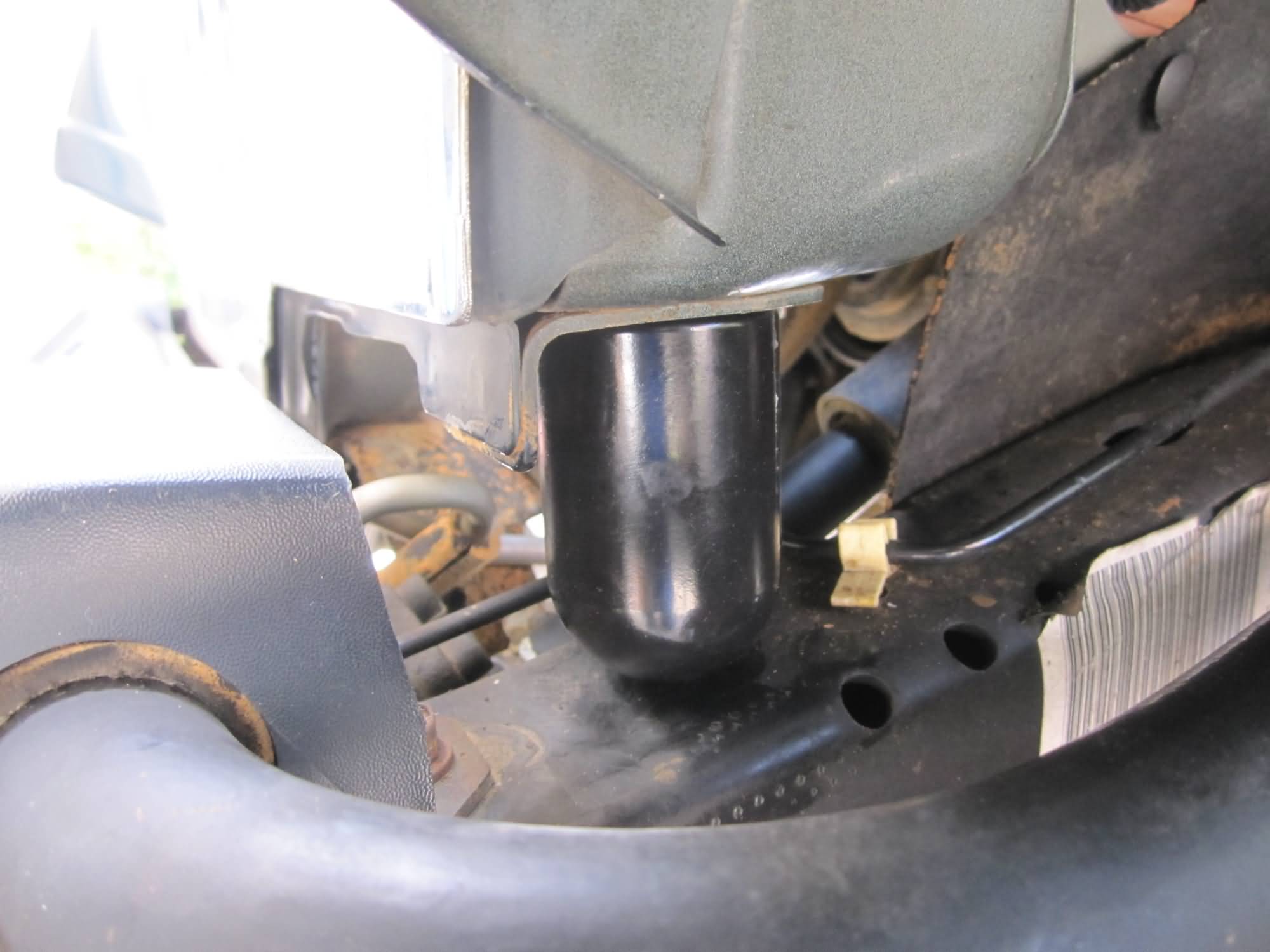

- Replace the radiator bumpers. These help support the front grill, and need to be an inch longer - luckily there are new bumpers supplied. This turned out to be harder than I thought it should be, and I ended up having to grease the bumpers to get them to go in.
Original bumpstops
Replacement bumpstops

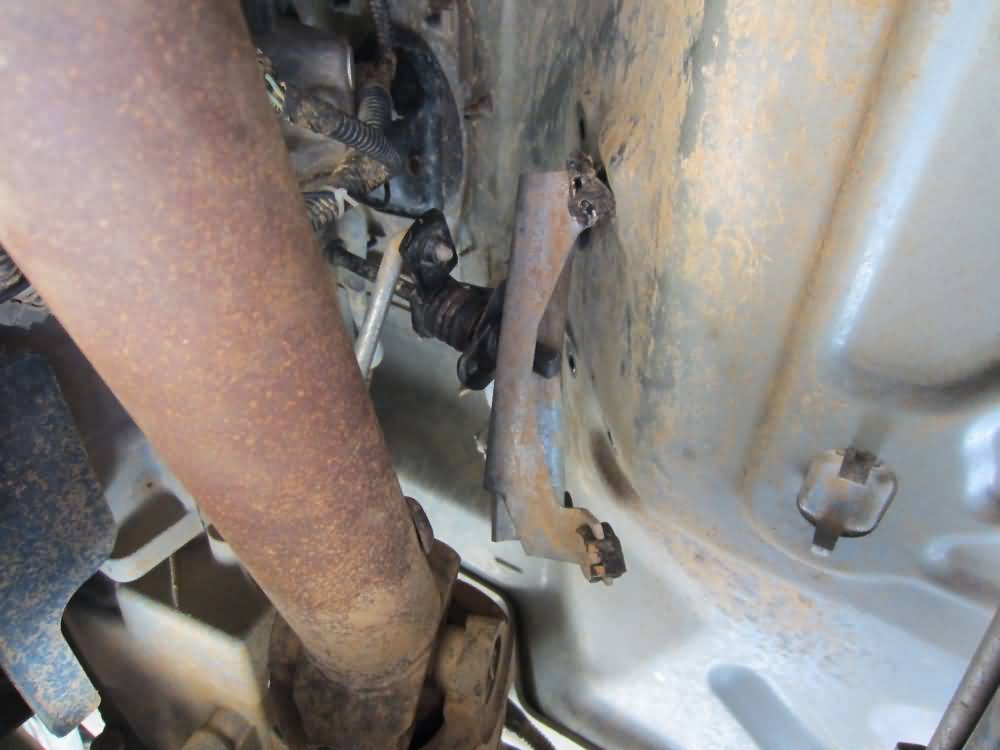

Optional Transfer case linkage adjustment:

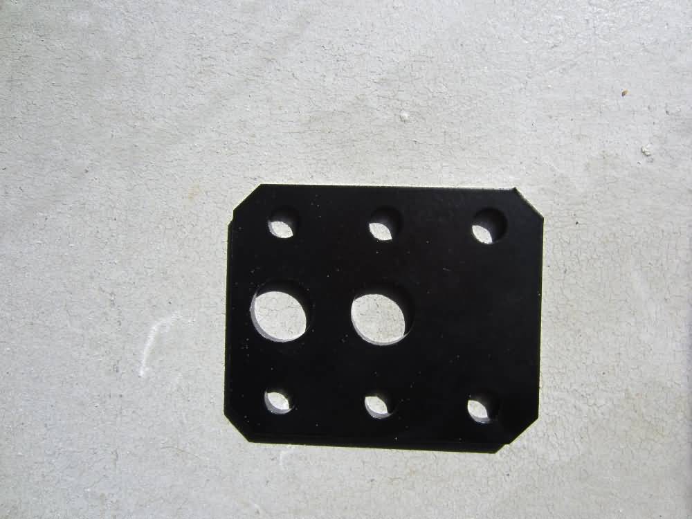

Verify that you can shift into 4 wheel drive. On my Jeep I wasn't able to - the transfer case would just grind. I found that I needed to modify the transfer case linkage. To do this I used the supplied lowering plate (note that JKS said that this was not necessary with a motor mount lift - even though I had a motor mount lift, I still needed the linkage adjustment).

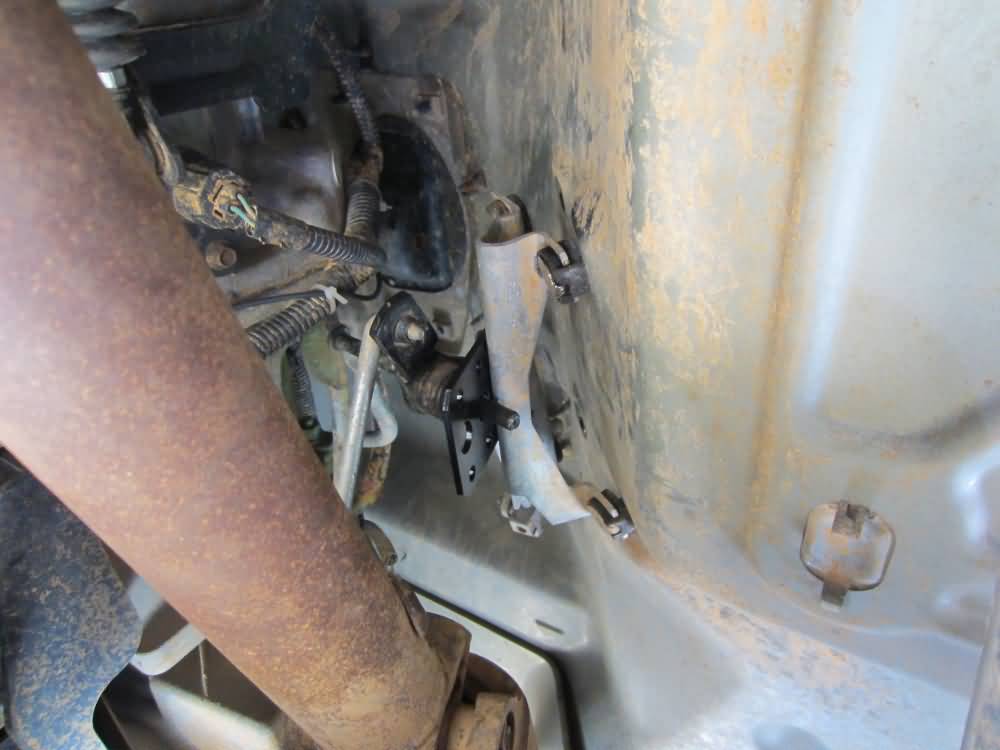

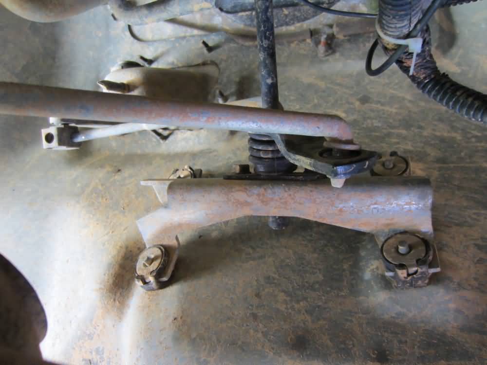

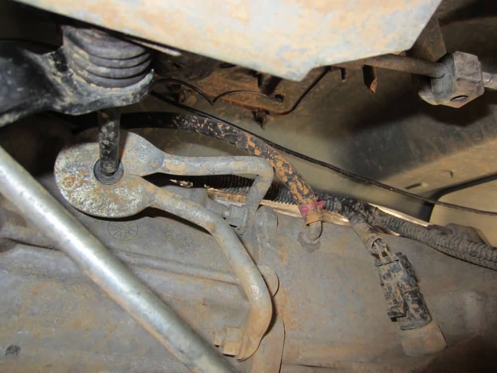

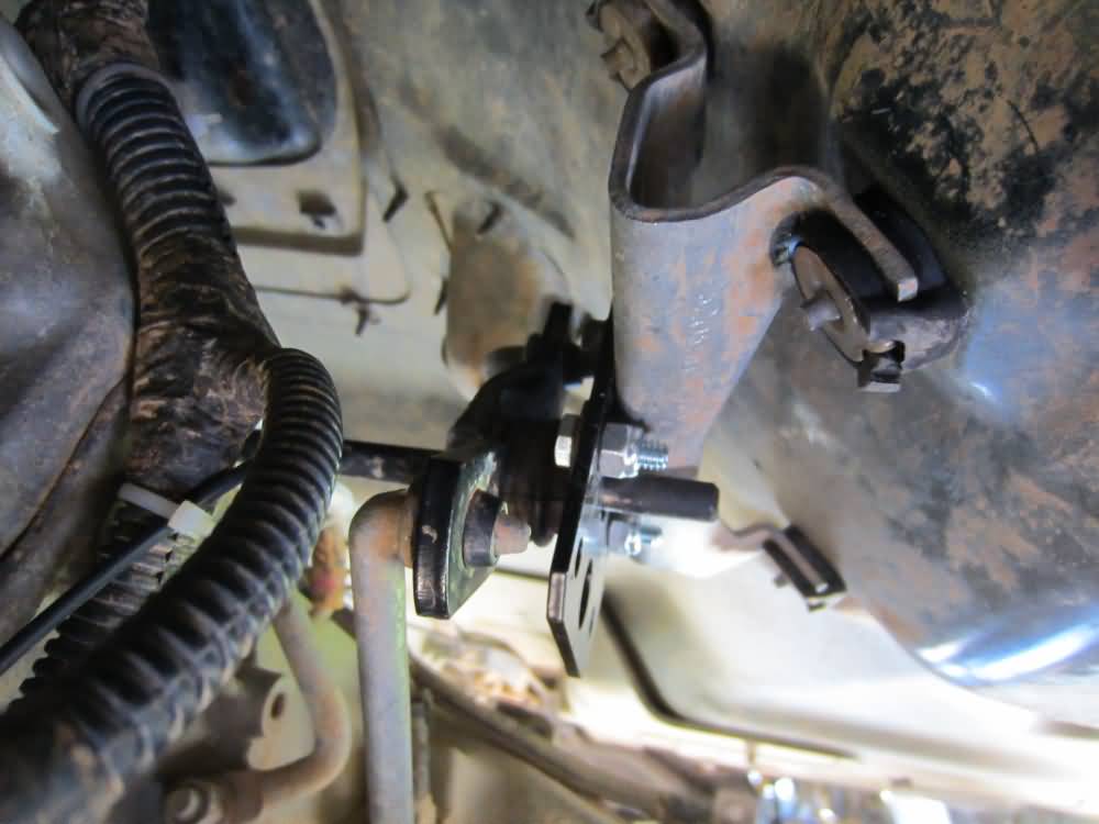

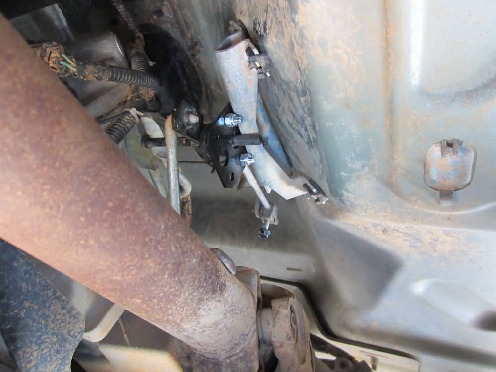

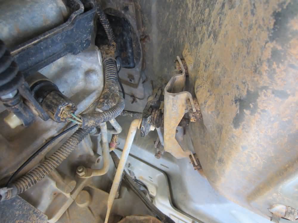

- This is the linkage that needs to be modified. One side is on the body of the Jeep, and the other side mounts to the transmission. Since the body is lifted and the transmission isn't, this linkage is at an angle. This is what the body side linkage mount looks like:

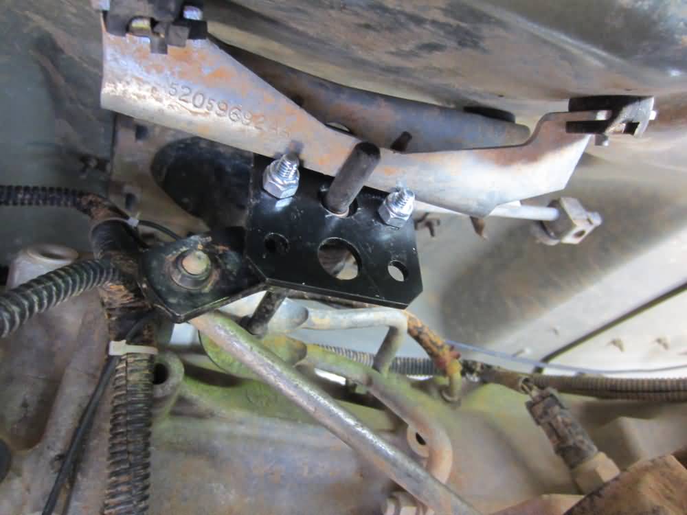

And the side that mounts to the transmission. The JKS instructions said to unbolt this side, however I couldn't get a wrench onto it.

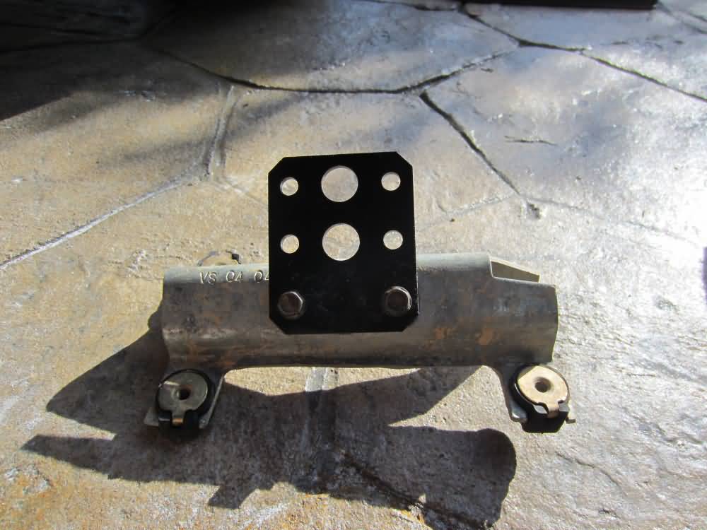

This is the JKS provided plate to lower the linkage.

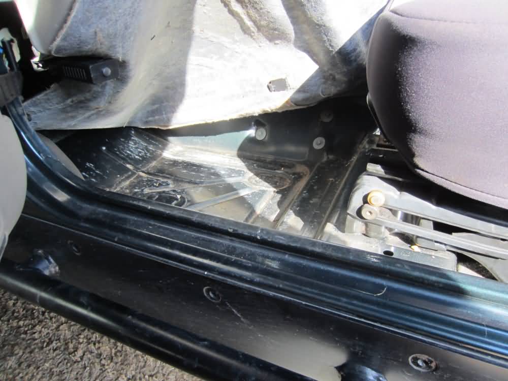

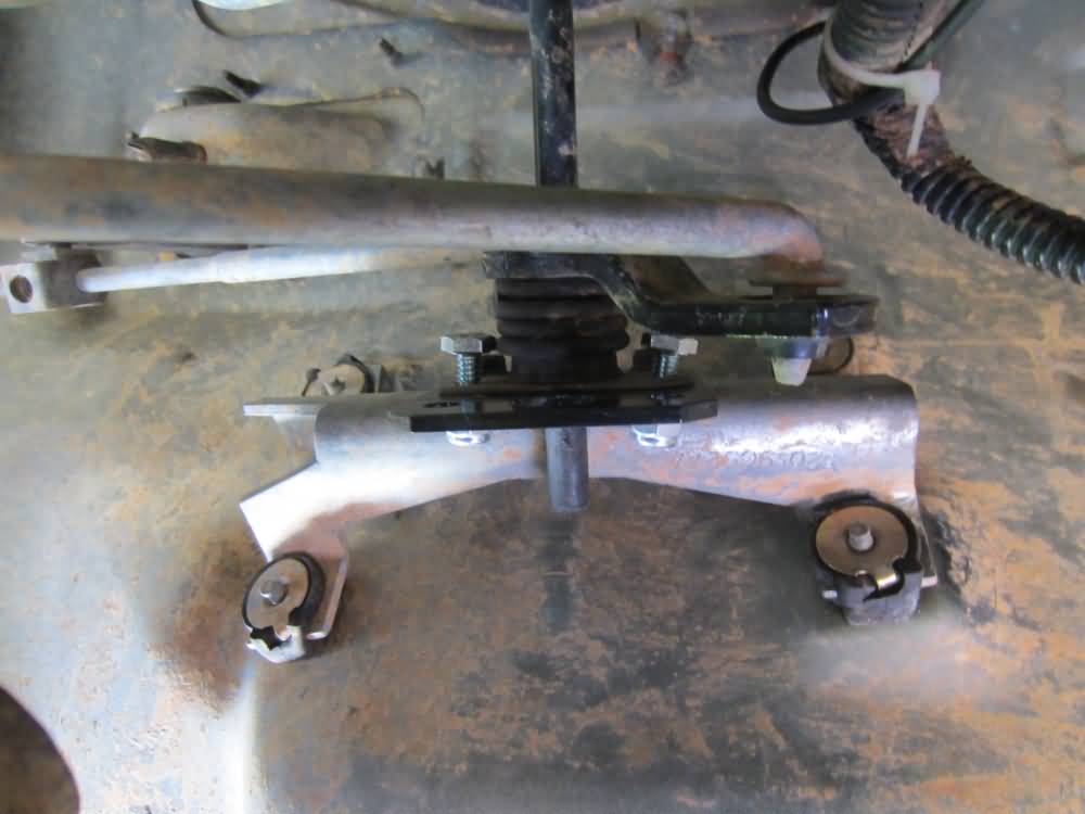

- To unbolt the linkage I decided to remove the bolts that held it to the body. Just lift your carpet (if you have any) and remove these four bolts. I had to put a clamp on the bracket below the Jeep in order to keep it from spinning.
- Once the bracket is free, you can bolt on the plate
- Bolt the bracket back into place, then you can bolt the bar into place
- Now the finished product
- Finally, try and shift into 4 wheel drive. You may have to work the adjustment nut on to get the perfect position.
