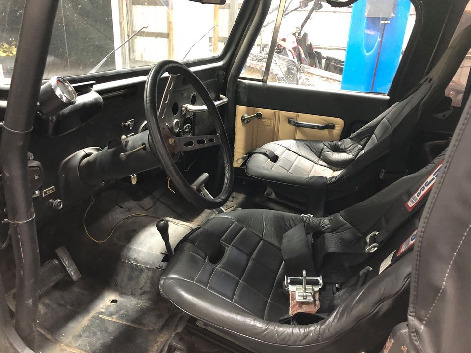

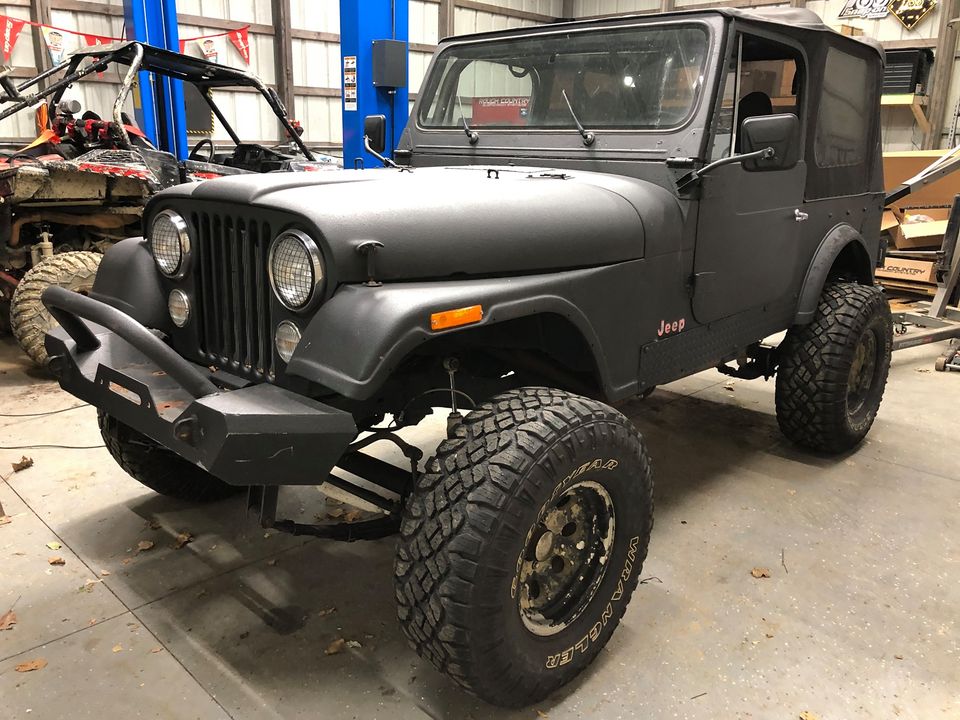

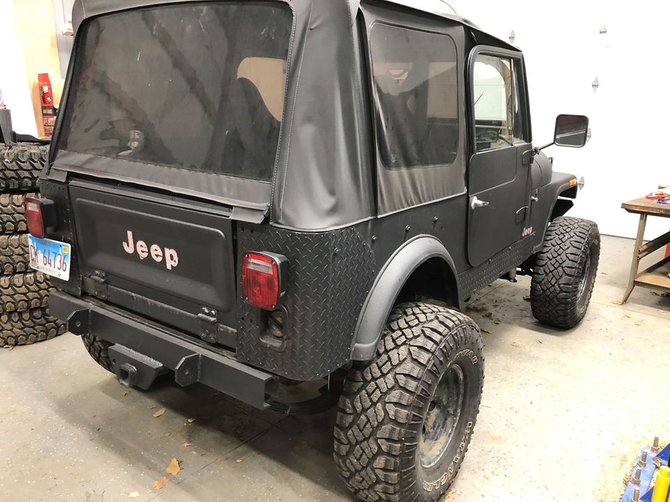

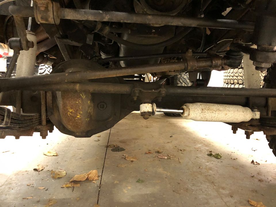

...Poke around the frame with a screwdriver to check for rot and soft spots. Look behind the armor plates fir damage or rotting body.
The soft top may need the plastic inserts fir the corners to looked rounded.
Doors do not close properly. Are they for this jeep? Door surrounds up top missing. Correct top?

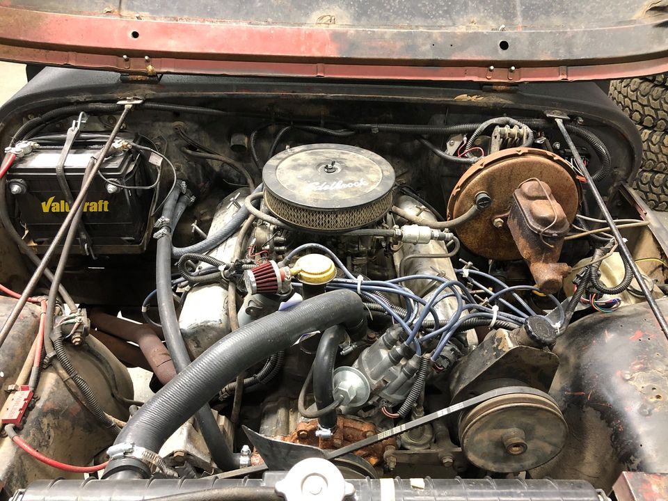

Is he the original owner? Never off road. There is a lot of dirt and rust under that hood.
If you have someone with you, have them turn the wheel stop to stop and you look at the front of the frame to look for broken welds or rot.
Full roll cage. Is nice.
4k is not bad.
Looks like a good project jeep
X2 thanks for your time in service brother. Just from what I can see (that I had to do to mine) I got rid of those seats and it's much easier to climb in/out of. Also I saw an incorrect fuel filter, and the spark plug wires need to be better organized.
Also the front/rear axle conversion looks wide in the photo.
Just for me, I'm not a fan of automatic transmissions, don't get me wrong, this is just me.
Thanks all for the help. I got a shop who will agree to do the flex plate for me for not too much money. I'm not confident enough to drop the tranny myself. I'll poke around and do all other stuff on Wed. Pretty excited. Any other tips. please keep them coming...
Not bad. I have a 79 cj7 with the 304 with the three speed transmission. I can tell ya that one is going to get hot unless you get a shroud on it. Mine didn’t have it either and took a bit to figure that out. Lots of good upgrades you can do. I’ll try and get a pic of what I’ve done if you like. Also, do you have lockers on those front wheels?
