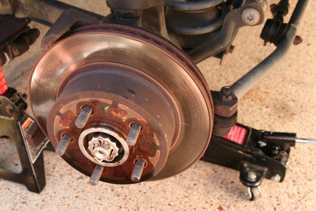

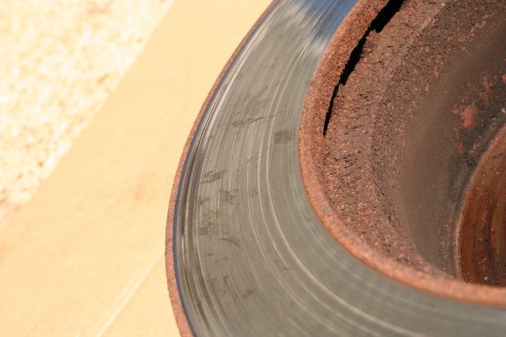

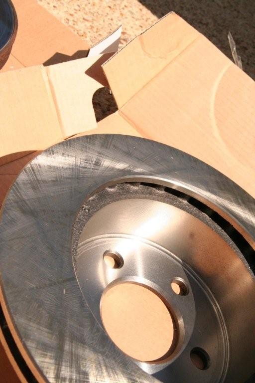

Thank you to everyone for the replies and great information. I did the rotors this morning and it took an hour and a half only because I had a really hard time getting the first rotor off. Anyway - after that it went like clockwork and I have brakes that work like new now !! I took a couple of pictures of the old rotor close up and I will post to this thread shortly when I upload them.:shades:
Here are a couple of pictures of the worn rotors and the new :-) Not sure if you can see how bad these rotors were from the picture but I thought I would share. Thank you again for the assistance.

Old ones don't look that bad to me, I'd see if they can be turned first but it also looks like you got the new one already.
Might hang onto the old one if it's still turnable, may be a good spare.
If it was only the one side, you may want to be sure the caliper wasn't hanging up.
Thank you 54cj3b ;-)
And buckshot 500- it wasnt just one side it was both sides. I had my mechanic friend use a drum micrometer on them and he said they would have just barely enough thickness after turning. So I decided just to replace them now while its nice outside. I do a lot of driving to the mountains and I just feel better having new brakes. :shock:
OK, sounds like they were just worn out.
I can't blame you for wanting to fix it right, brakes are important & not something to band-aid fix.
Gotta be able to stop once in a while!
